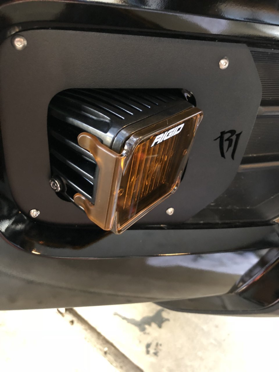

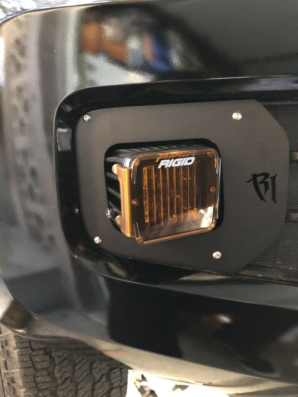

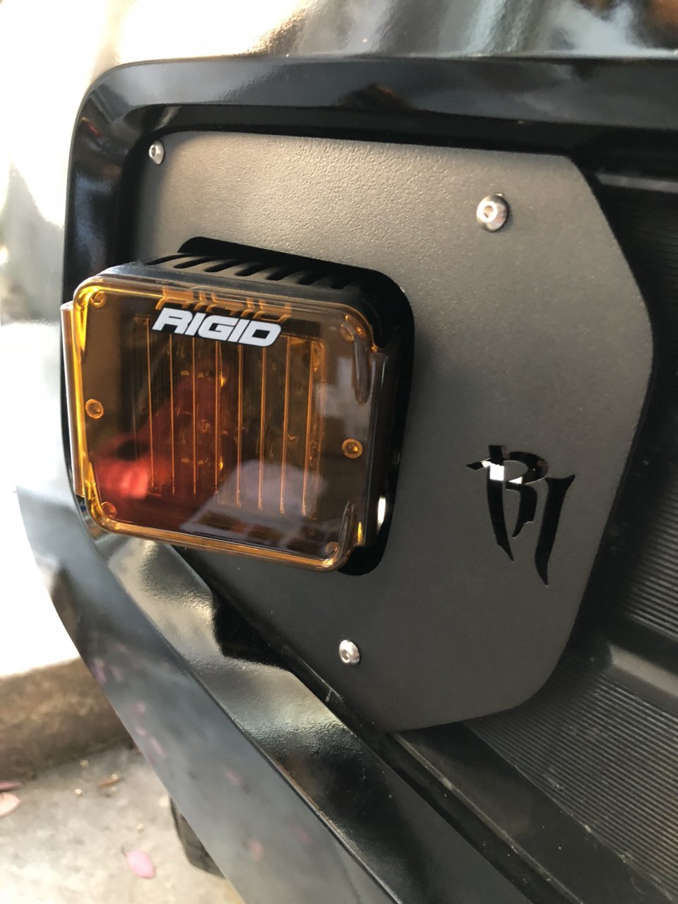

    I wanted to respond to my own question. Haha. Since I didn't see anyone post about this setup, I figured I'd try after I buy. Not usually a great idea, but after multiple phone calls into Rigid and searching the interwebs for a definite answer to whether the Amber covers actually fit over the Rigid fog pods AFTER they're installed seemed to be a mystery. So I bought a set of the SAE Fog Pods with the Rigid mounting kit as well as the D-series Amber covers, and 2x CaliRaised H11 to Deutsch connectors off Amazon (for the lenient return policy in case they didn't fit).
    Today I installed the kit (Super easy and quick install!) and got the Amber covers to fit over the pods in the brackets and plates. I've attached some photos for anyone who is currently looking to run this setup. It looks pretty great IMO and the amber covers make the light a nice yellow color, not quite canary yellow but not a true amber either.
    ***One note on the covers, they DO fit and click over the lights easily. However, you cannot take them back off with your fingers. The way they sink into the plates, you have to use a flathead screwdriver or blade to pop the recessed side off first, then the covers come right out. You DO NOT have to unscrew / loosen the lights to get the covers off, you just have to use a pry of some sort to pop them out.
    Overall I'm stoked on this kit. It was a hard choice between these and the KC G4s in Amber. The KCs seemed equally as good for inclement weather and general aftermarket fogs specifically in the amber color. My reasons for going with the Rigids were:
    1) Mounting Versatility: Since the Rigids are a standard pod, the mounting options are more diverse. The KCs are designed to mount in the Tacoma's standard bumper fog mounts (although they work in other vehicles as well). I figure the Rigids would be better in case I later upgrade my front bumper or move them to a newer/different vehicle. They do have a lifetime warranty after all.
    2) Light Color Options: I really like @crashnburn80's testing results from the G4s but he did the white light version and I was really after an amber colored Fog. With the Rigids, I have the option of running the highest output SAE fogs in white, while also being able to pop an amber cover over them for the Amber option I want. Even though the cover is not ideal for filtering the light because it reduces output, since the Rigids are brighter to begin with, they have "some output to spare" perhaps. I think the output will still measure higher than the KC's even with the amber covers on. Maybe @crashnburn80 can confirm this in a future test? ;)
    3) Price: I knew I wanted to go the high budget, high quality route. I was able to source the Rigids for only $20 more than the KCs and this included the Pods, Rigid mounting kit, amber covers, and H11 adapters. Overall, I think the price for both the KCs and Rigids is well worth it. They both are top performers for this category of light, they both back their products with awesome warranties and they are both known to be great USA companies in general.
    I hope this helps answer some questions for anyone looking into this setup or anyone in the dilemma I was in. IMG_0436.jpg IMG_0437.jpg IMG_0440.jpg

    Awesome, thanks for trying out the covers with the mount kit and sharing with the rest of us!
    I do have it on my TODO list to test the Rigid covers affect on the output.

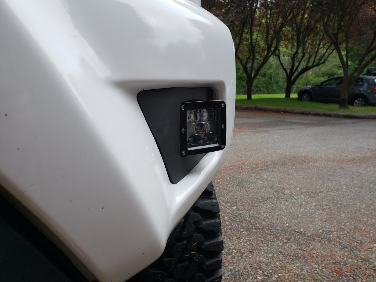

    Lucky me! I live local to @crashnburn80! Got some lighting done correct for a first on my truck. Future fog light pods! Over a time and a half brighter than I had with a cool look too. Highly recommend. One of the best values for the money for sure!20180701_191727.jpg 20180701_191739.jpg

    Now if we would have only had the polarity right the first time...

    Yes. Guys- please test your polarity of your lights BEFORE making any permanent connection. Red to red and black to black wire isnt always correct. I've had two 15's one was one way the other was opposite wiring. Unless you're like @crashnburn80 and you enjoy the skill test of resoldering the same joint multiple times:)
