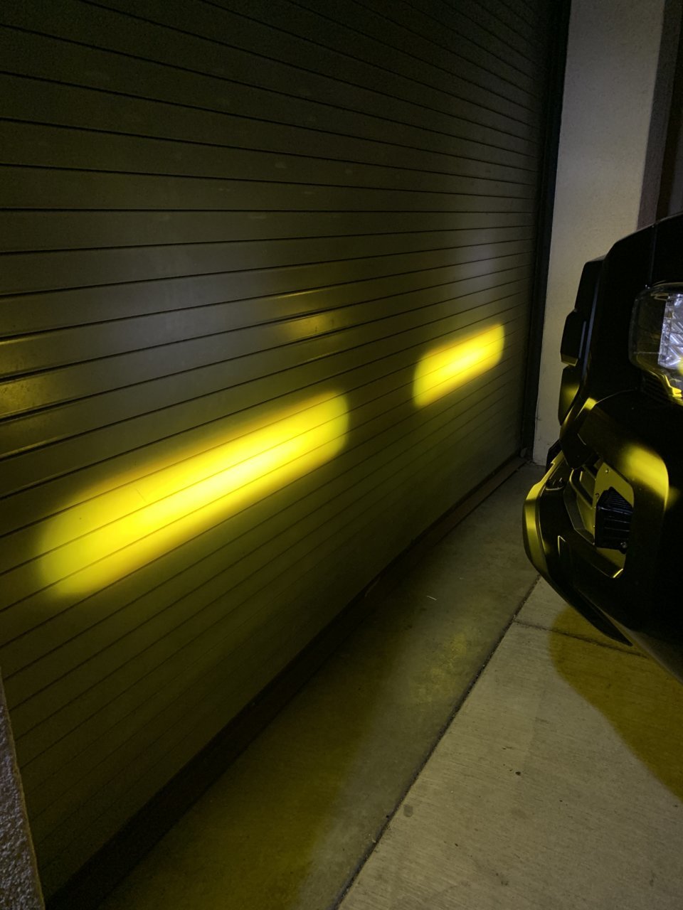

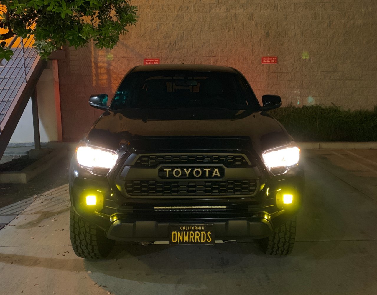

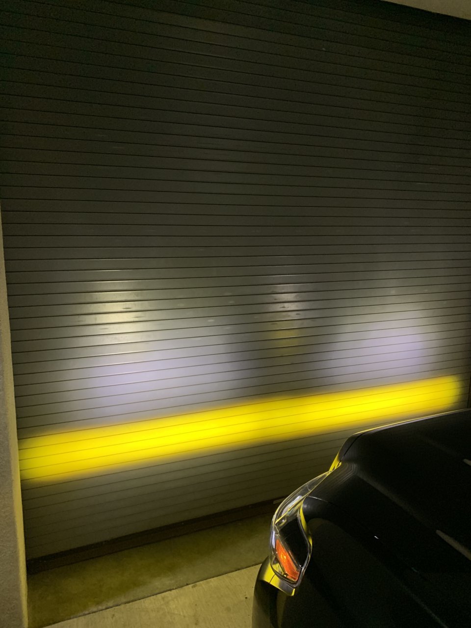

    Thank you! Pretty stoked!

    I agree on the look.
    The answer is somewhat complicated. It doesn't seem effectively possible to filter high color temps down to the required selective yellow window. Rigid's white lights are very blue at over 7000k. It took them quiet a while to get the selective yellow sorted out before going down to warm white (4000-4300k) LEDs in order to meet the chromaticity requirements. Using a warmer color LED is more efficient because less light is lost though the amber filter to generate selective yellow light, leading to greater output with all other things being equal. Baja's 'white' light is a much better 5000k than Rigids 7000k white, but that still might be too high to hit selective yellow, and if they are able to get it down using filters alone it will require heavier filtering which will further reduces output over using a more efficient warmer color temp LED. Baja appears to be still working on figuring this out and I do not know if they have will be going away from their hallmark 5000k LEDs for better performance, or if they have even considered it. You'll notice they have delayed their selective yellow pods with no launch target date announced while keeping their white SAE pods launching in June. This science is far more challenging than most people realize and Baja's first foray into SAE lighting. A selective yellow SAE fog from an LED pod is probably the most challenging light to build in the SAE family, and certainly a very difficult one to start with for their very first SAE product. While Rigid's use of warm white LEDs is more efficient than using high color temp LEDs, if Baja got the filtration correct for their 5000k LEDs, they could use more power to overcome the lower efficiency filtration for better output. However the internal projectors in SAE fog pods have issues with deforming and melting as the heat is turned up, so throwing more power at the problem isn't as easy as it sounds either. Projector pods are actually the least efficient light in the pod family. So it is hard to say how that will play out or what they will do. Using a warmer color LED will produce a richer color yellow though than using a higher color temp light source. I'm really excited to see what they come out with as I have always liked Baja's lights. I'm also excited to see SAE lights gaining such traction that major brands are focusing their R&D efforts on building and improving these products, since the majority of us do use our trucks on the street.

    Nice. It appears they may have a lower temp than the preproduction model I have been running since December. I know most people don't like Rigid on this site but I love driving with them compared to the white version.

    The Rigid kit is "plug and play" depending on how you want to wire them. I went into my stock fog light harness from the factory. But I needed a set of adapters that I got from Cali Raised for $10 (https://www.amazon.com/Heavy-Wirings-Converter-Adapters-Deutsch/dp/B06W5XCF9P).
    The Rigid Pods themselves have a great wiring harness that they should come with if you want them on a separate switch.
    Since they replaced my stock fog lights, I figured it made the most sense to wire them in that location. So basically it involves, Pod wiring connector plugging in to Cali Raised adapter, plugging into stock H11 fog harness. No wiring/splicing/cutting needed!
    They are great lights! Enjoy!
