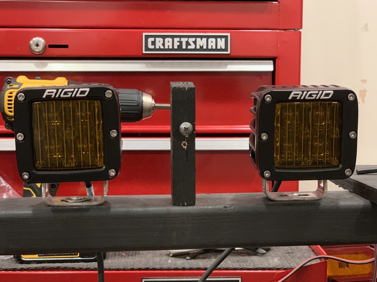

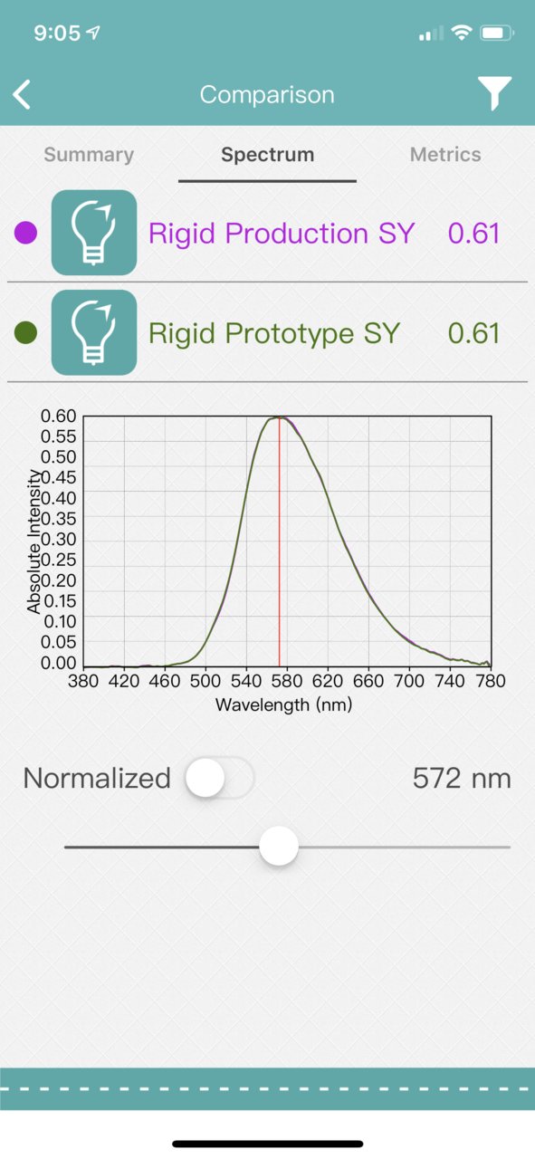

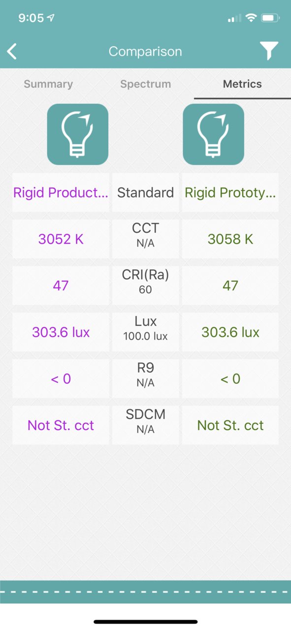

    What do you guys think?
    These production lights are identical to the prototypes. I’ll ping Rigid and inquire as to why.

    Couldn’t be more identical, they are the exact same light.

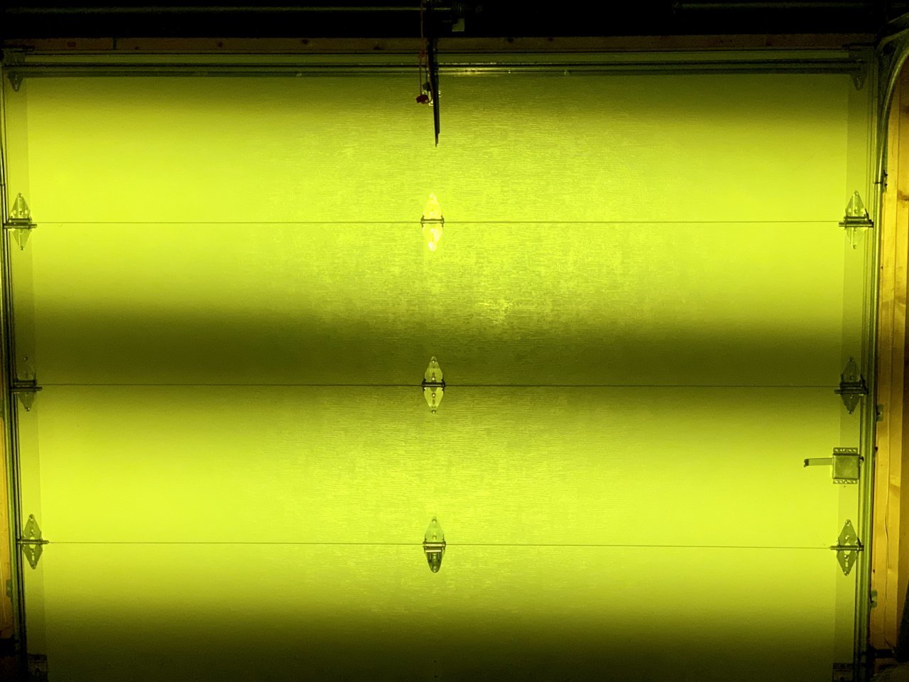

    Almost green in color.

    Correct.
    Because if you are trying to make yellow from white light by using an amber filter, but instead start with 7000k+ bluish light. Blue + Yellow = ...
