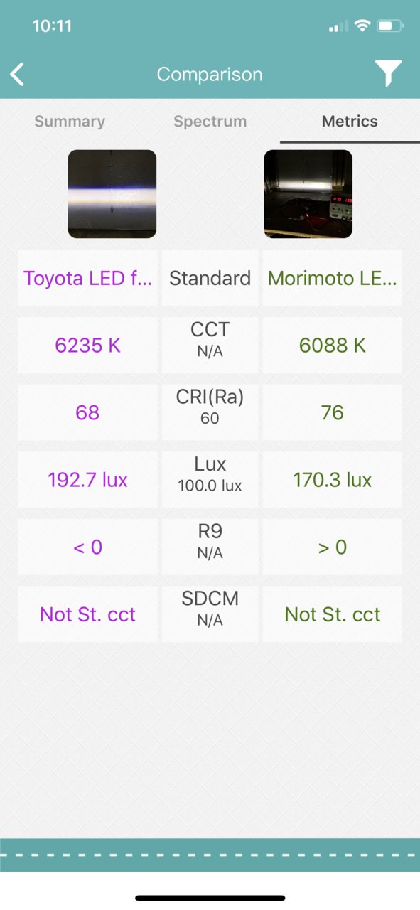

    Cruising through some of your posts it looks like you have tested the newest Hikari Ultra H11's ..from pics it looks like Toyota LED fogs are a better color temp match to the Hikari Ultras vs the Morimoto LED fogs. Would you agree or be able to confirm? I like the Morimotos and they have held up well but the color temp difference has always bugged me a little. I would be willing to swap for Toyotas LED fogs just for the sake of a closer color temp matching.

    I measured the Hikaris at 6664k color temp. You can see the comparison between the Toyota and Morimotos below. It certainly moves it in the right direction but still leaves a 400k+ gap.
    The PIAA LED fogs would be the be the match, but their performance is awful. Next closest would be the ORTown fog pods. (Color temp chart in the OP).

    Looks like you need to answer a very important question. What's more important, matching the color temperature or performance?

    Ya since majority of my night driving is in well lit city areas for these it's matching color temp. I have a LED bar stuffed in my lower grill for lighting up wooded areas and off paved areas. For the price the OEMs are not a huge expense. If I'm reading Crashburn80's charts properly they outperform the Morimotos as well so looks like a win win. For practical use of a fog light I would probably go the amber route: )

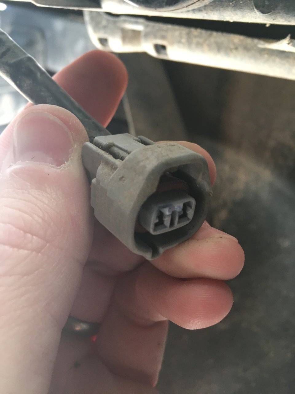

    @crashnburn80 what connector do you think this is for the gx470 fog light?

    Looks like maybe an 893 fog? Easier to look up with year/make/model of the vehicle.

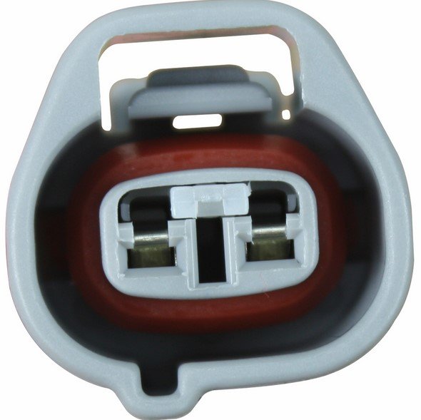

    Looks like the same plug for Toyota side markers 98-2011
    90980-11156
