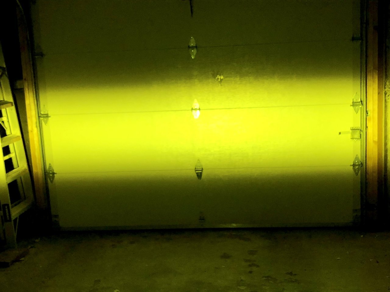

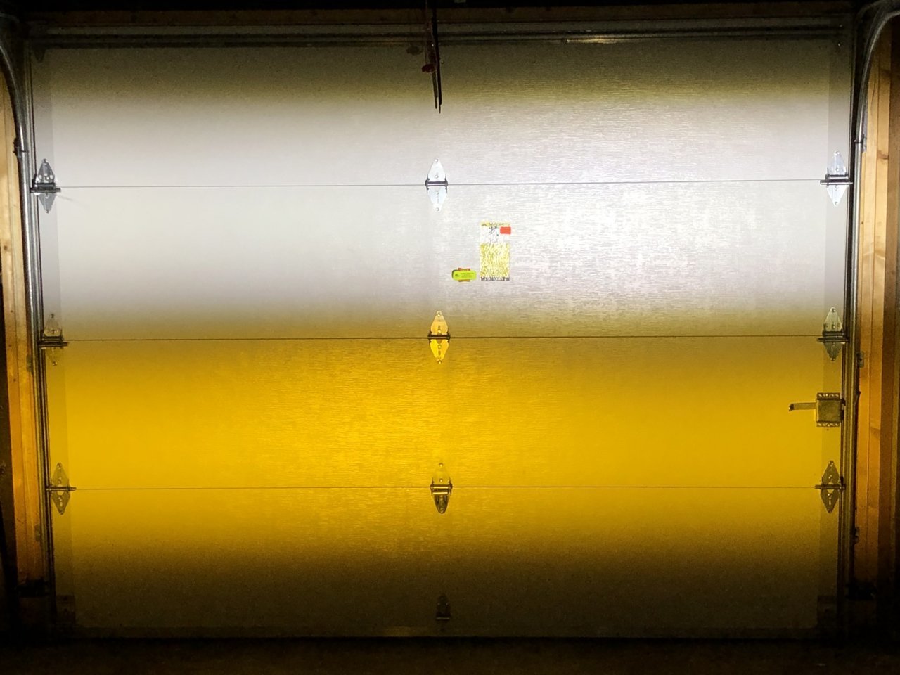

    Anyone have a picture of the rigid sae white with the amber cover compared to the sae selective yellows? Id like to see how the compare, i want the white but for the random few times im in fog/snow i can just throw the amber covers on. Also is there a huge difference in rain? Thanks

    Ideally you want comparison light source photos to have both light sources in the same photo to get an accurate representative comparison. I don’t have that for Rigid amber covers vs selective yellow Rigid’s. I do have separate photos.
    White Rigid vs w/ Amber cover
    Selective yellow Rigid
    The selective yellow is a brighter yellow vs the amber covers which are a lower color temp closer to amber and not as bright.
    Note that using the covers in snow will likely lead to icing over of the pods. The best pod for ice resistance is the selective yellow Rigid’s as they currently are the only fog pod where the lens will get warm.
    See the prototype comparison here.

    All the data is in that comparison link at the bottom of my previous post.
    Rigid lux comparisons:
    White: 395
    Selective yellow: 318
    Amber cover: 195
    So yes the amber covers do cut output nearly in half. I agree on the Baja form, I’m waiting to see what is best in selective yellow and will mount whatever is best on my truck.

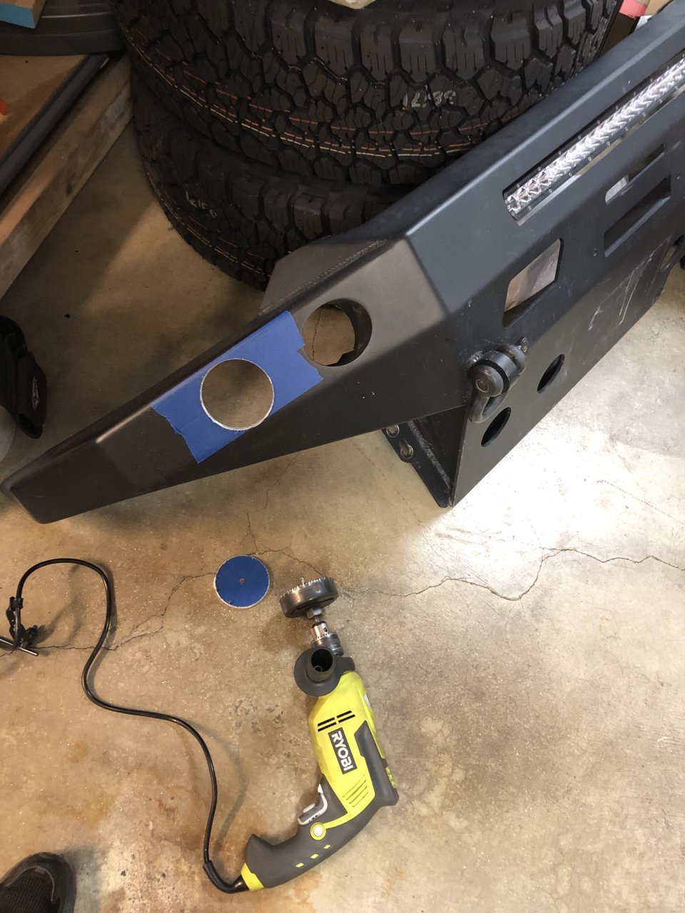

    About halfway done...
    Well at least you didn’t attack your plate bumper with a 4” hole saw...:anonymous:
    Because I’m maybe a little addicted and thought having 4 fogs I could use on the street was helpful

    Fortunately Bajas will fit a 4” round hole nicely!
