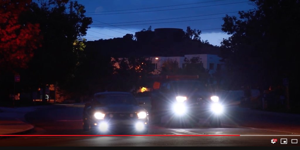

    37 second mark. stop light screenshot
    Come on BD. Don't let me down like this.
    I regret selling my Rigid SAEs if this is what the output looks like. the camera isn't even below the headlights so why are the fogs glaring :confused:

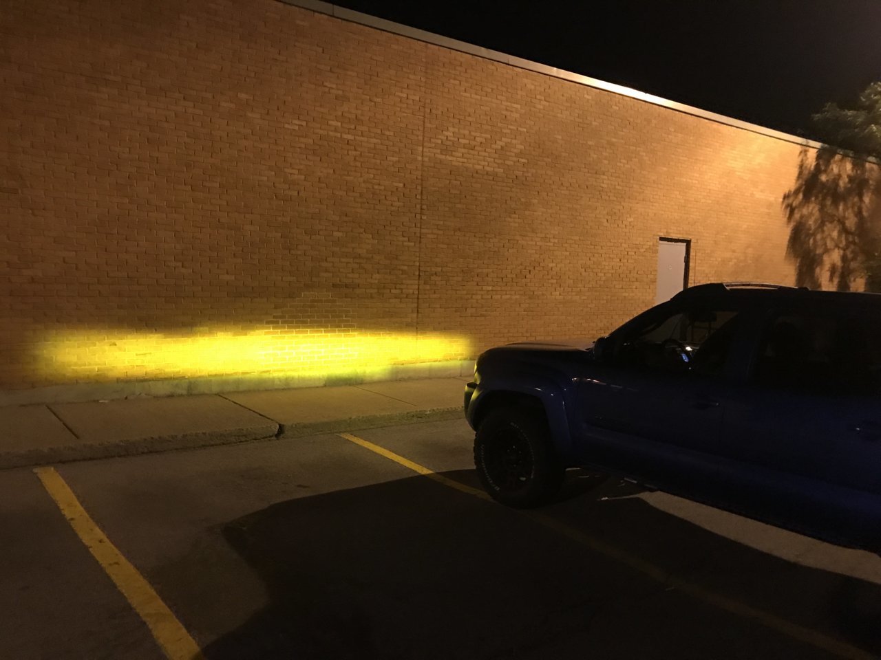

    Rigid Selective yellow
    Baja selective yellow
    Rigid left vs Baja Right
    Baja does not use projectors for cut offs just as many have expressed significant concern over for these lights after seeing marketing output pictures. The lights emit significant upward glare as expected from a forward facing LED pod without projectors. Projectors are industry standard for fog pods. The focus area of the Baja pattern is certainly taller than Rigid, but without the cut offs to cap the output, this blends the pattern extremely vertical causing significant glare. Waving my hand above the Baja light creates shadows on the ceiling, waving my hand above the Rigid SAE fog light produces no shadows, because no light escapes upward from the cut off. Standing in front of the Rigid lights is not offensive at all. Standing in front of the Baja lights is blinding and causes one to see spots and have trouble focusing afterward.
    I will do my usual full proper review and performance analysis of the Baja SAE lights very soon, but I’ve had many members PM me questioning the cut offs based on the released marketing materials and wanted to share this initial info without delay for a full comparison write up.

    memario1214

    I suppose it's a good thing that I sell Rigid gear too! That said I still love Baja gear for offroad only applications. Thanks for the quick review!

    Initial reaction;
    Are you effing kidding me BD? Many months of r&d and we get the same wide cornering version. These still need work. i can't believe they're marketing this and think this is fine for road use.

    That’s crazy how much light is on the ceiling! How the heck did they get these SAE certified? Who did they pay off!?
    Glad I went with the KC G4’s after seeing these pictures.

    That's enough of a review for me to decide to stay with my Rigid selective yellow pods. That looks about right with their promotion pics and videos. How did that pass?

    I love Baja’s pods for off road! They have by far the best form factor and great output intensity and color quality. I was really hoping to love their SAE lights as well. I’ve had the Rigid SAE selective yellow fogs for a while and not installed them in anticipation that Baja would come out with something better.
    I wouldn’t call this a review though! I set the bar much higher, this is just a pattern comparison. Full review coming soon.
    They claim to have adjusted the optic and reduced the output for street use compared to the wide cornering. The lenses are labeled SAE F16, F=(Fog) J583 and 16 is 2016 compliance standard. There is an allowed vertical gradient in the fog pattern, but I don’t see how these could meet it. I’ll have to see if I can dig up that gradient test spec.
