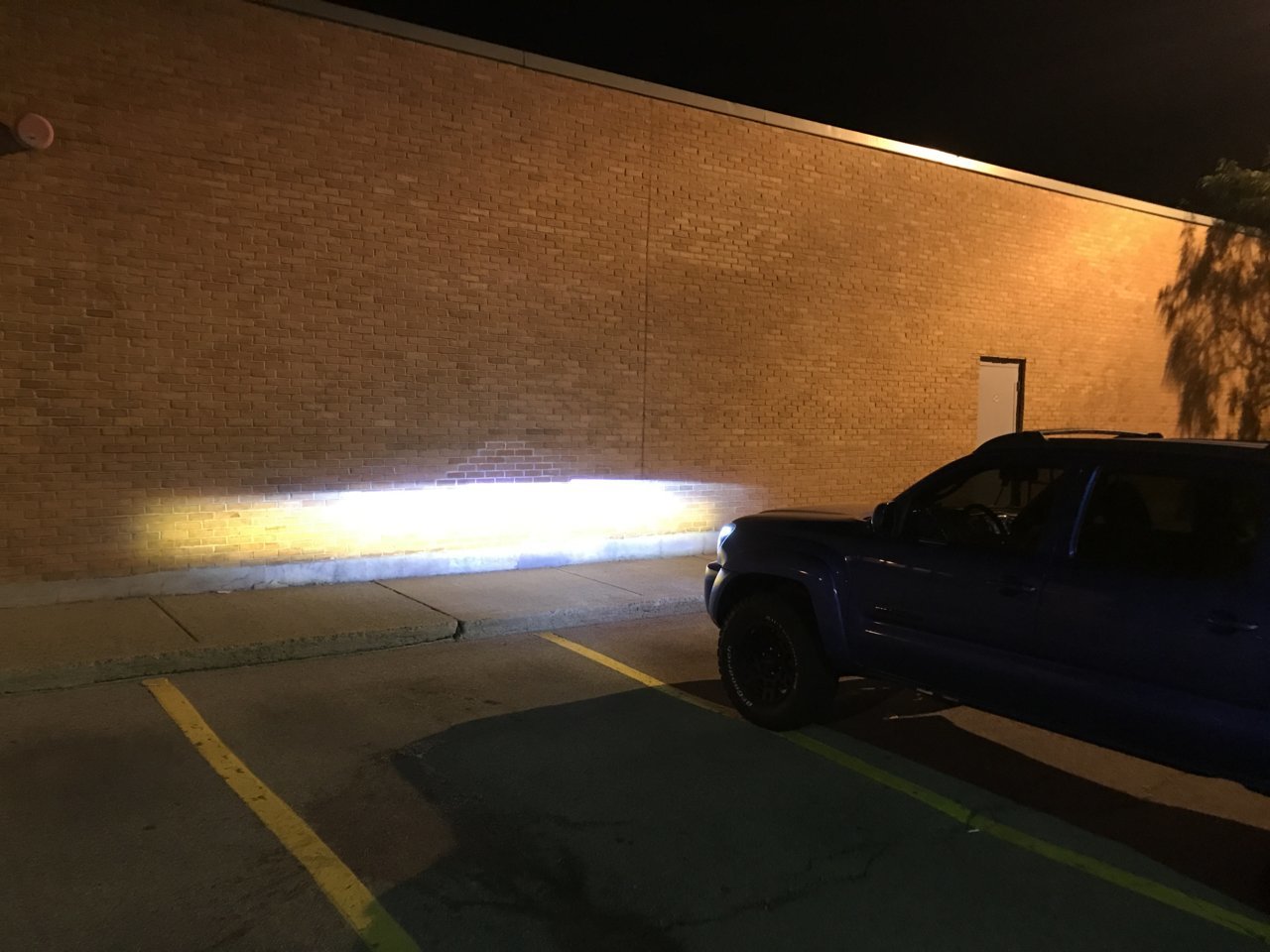

    lower and under. i think my lights need to be aimed up a little bit so the fogs sit underneath.

    As mentioned, definitely lower and completely under the headlights on a wall shot. @TRD2010SpeedwayBlue has some adjusting to do. :)

    going to try to do that this weekend.
    have to find a long screw driver as i’m told that will work to adjust the cutoff of the headlights i should 100% be able to see the fogs separate under the low beams like this right?

    Yep, they should be clearly distinguishable separate patterns in a short range wall shot.

    sweet
    yep got work to do

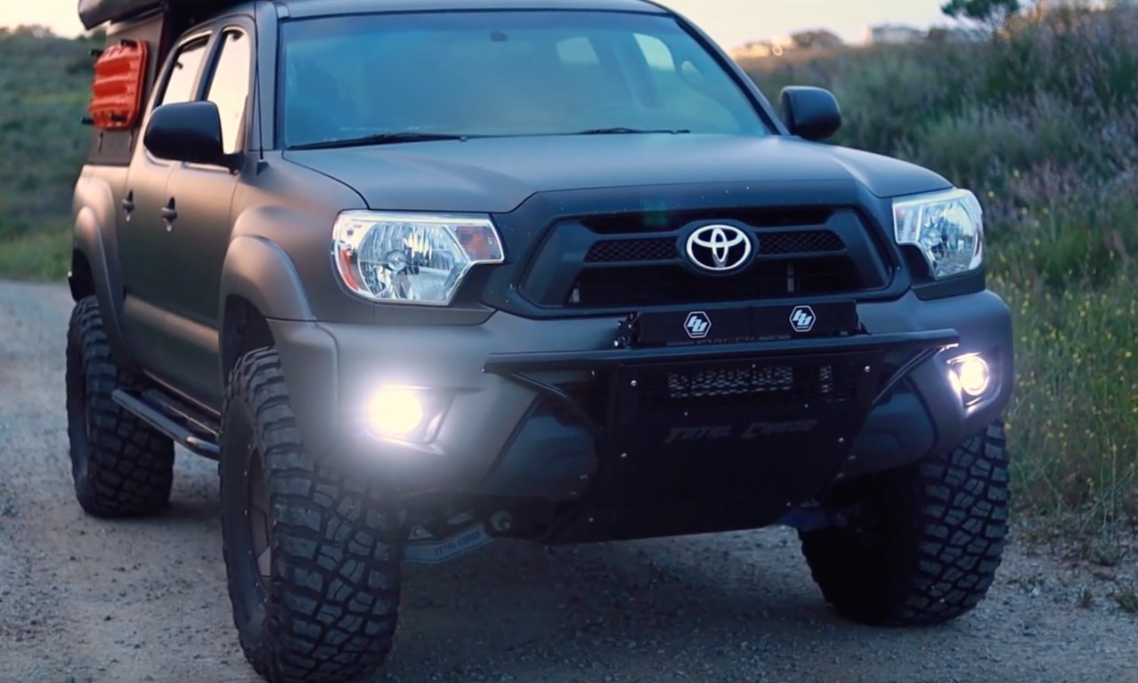

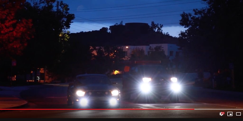

    Thank you for chiming in BD. I'm hoping to see these bad boys in action irl if they aren't really as obnoxious as they are in pictures. atm I'm expressing my reaction to these pictures. I hope this in-depth review changes our minds and the scattered light is acceptable to our eyes on the road. fingers crossed!

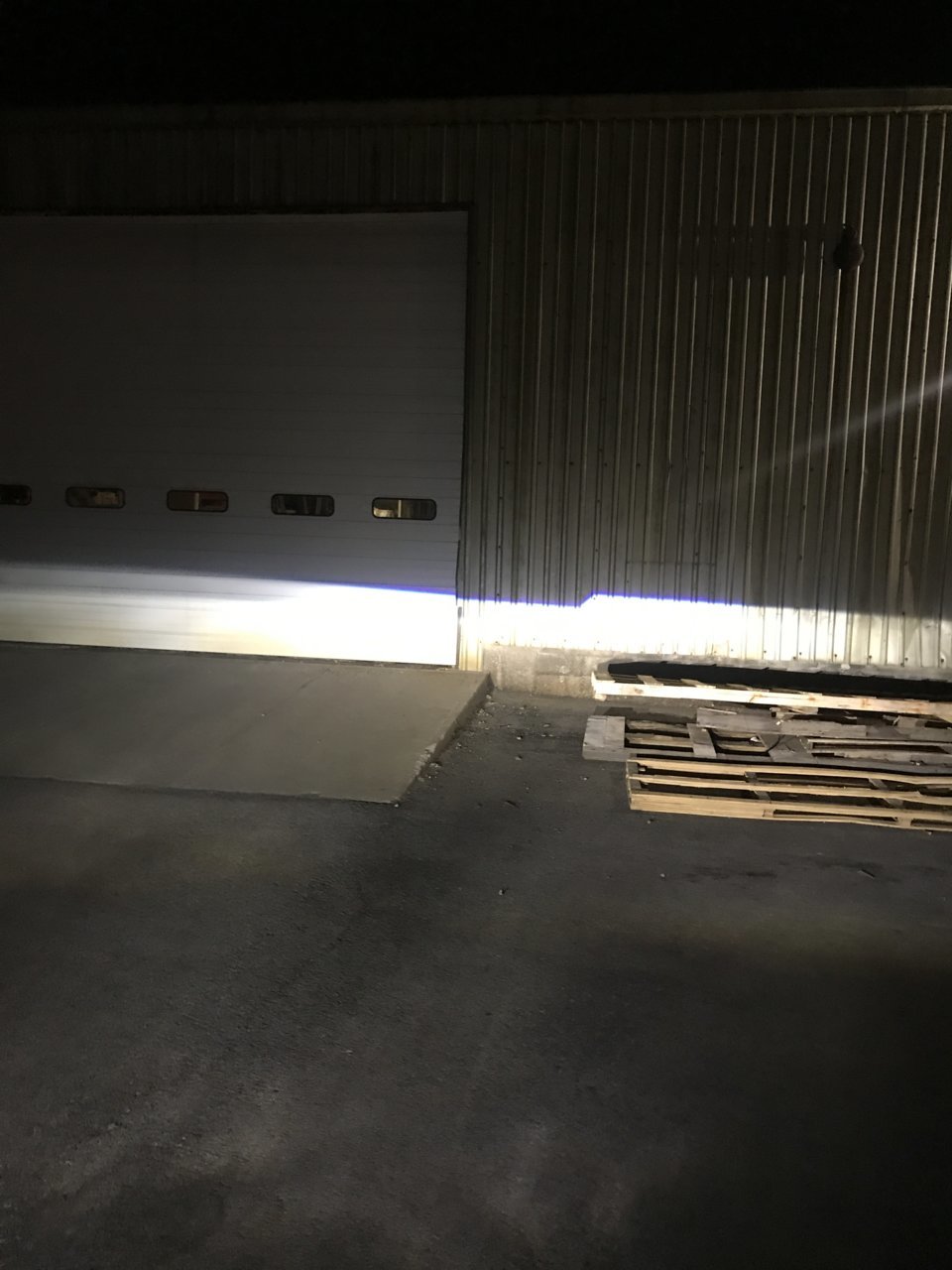

    Rigids look nice and perform great! =P
    ps; theyre clocked outwards just a tad bit. the overlap in the middle is more than enough light and i can see pedestrians clearly at night

    looks nice
    any pics with the headlights on too from that angle?

    Sorry i dont but theyre aimed correctly above the fogs.

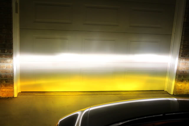

    never mind, found some old pics. yellow vinyl made them look green and i took them off a few weeks later. not sure if this is what you want but i assume you wanted to see the beam patterns.
    Edit; I used yellow vinyl over the clear Rigid covers. I think amber would better suit the the color temp for selective yellow.

    I can tell the fogs will fill in where the fxr's won't. NICE,

    nice! yeah my lights need to be adjusted.
    have to work on that
