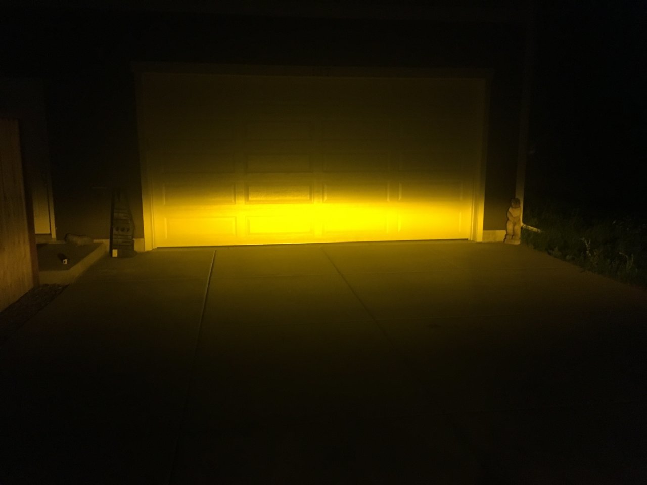

    These lights are very different than anything we've seen before for in an LED fog light. Thus far all LED J583 fogs fall into two categories, 1) forward facing LED emitters with projectors for glare control or 2) rear/vertical facing LEDs bounced off reflectors for pattern and glare control. Baja Designs has built (to my knowledge) the first SAE LED fog light to break that mold, using a series of multiple optics without projectors to provide pattern and glare control for a forward facing LED emitter. Projectors are actually not that efficient as a projection technology since by nature they cut out some of the output. However nearly every manufacture uses projectors with a forward facing LED emitter fogs, including Toyota OEM LED fogs, Rigid (Toyota's OEM supplier for Pro) and Morimoto among countless others.
    Also while these lights are listed by Baja as 'Amber' they are not an Amber light, they are Selective Yellow. So how does Baja's new innovative design stack up?
    First off, these lights do not have clean cut offs like all the other SAE lights in this thread. These lights emit more glare than any other SAE LED fog light on the market that I am aware of. SAE compliance allows a glare gradient threshold in the pattern, it is as if these were designed to pin to that maximum glare threshold. I'll come back to this later but feel the understanding is necessary before reviewing the output photos.
    It is a little hard to determine in the photos, but the heart of the beam pattern is 2.5 panels tall when projected from my standard 18'. However you can see that the cut offs above and below the 2.5 panels main pattern still is covered in a lot of light, meaning the pattern 'cut offs' are very weak and will provide significant glare.
    To compare here is the competing Rigid Selective Yellow light pattern. ~1.25 panels with much stronger cut offs thanks to the projector optics. The main pattern area is roughly 1/2 that of the Baja Designs main pattern area.
    Measured data for Selective Yellow Rigid vs Baja

    Both Baja and Rigid spec 22w as the power consumption. Baja's ultra wide angle fog design has dispersed the light over a much larger area while Rigid's design focuses all the light into a more condensed fog pattern region. The horizontal width of the pattern projection is very similar.
    While Baja has 2x+ the vertical area coverage by spreading light out more, Rigid has 2x+ the intensity over Baja by focusing all the light into the fog pattern region. Aka in the desired fog pattern region the Rigid lights are over 2x brighter, because their lights are more focused.
    What I find particularly interesting: Baja has some of the best in class light color of 5000k, while Rigids 'white' light color is way too high of a color temp at 7000k+. Why is this important? Because Baja then should be able to use a lighter lens to achieve selective yellow compared to Rigid. The further you are from the correct color, the darker the lens will need to be to correct it, and the darker the lens the greater the output loss.
    Note that Rigid lens looks more amber, vs Bajas that looks more yellow. Yet output color is extremely similar. Baja's yellow lens is more efficient for color correction to selective yellow compared to Rigid. However, there is one benifit to being less efficient. The Rigid lens will run a little hotter. Recall that light energy cannot be destroyed (law of conservation of energy), so if light is filtered it is converted to heat. Meaning the more filtering, the hotter the lens becomes. Hotter lenses are good to avoid freezing in snow conditions. Baja's yellow lenses still produce a good amount of filtered heat.

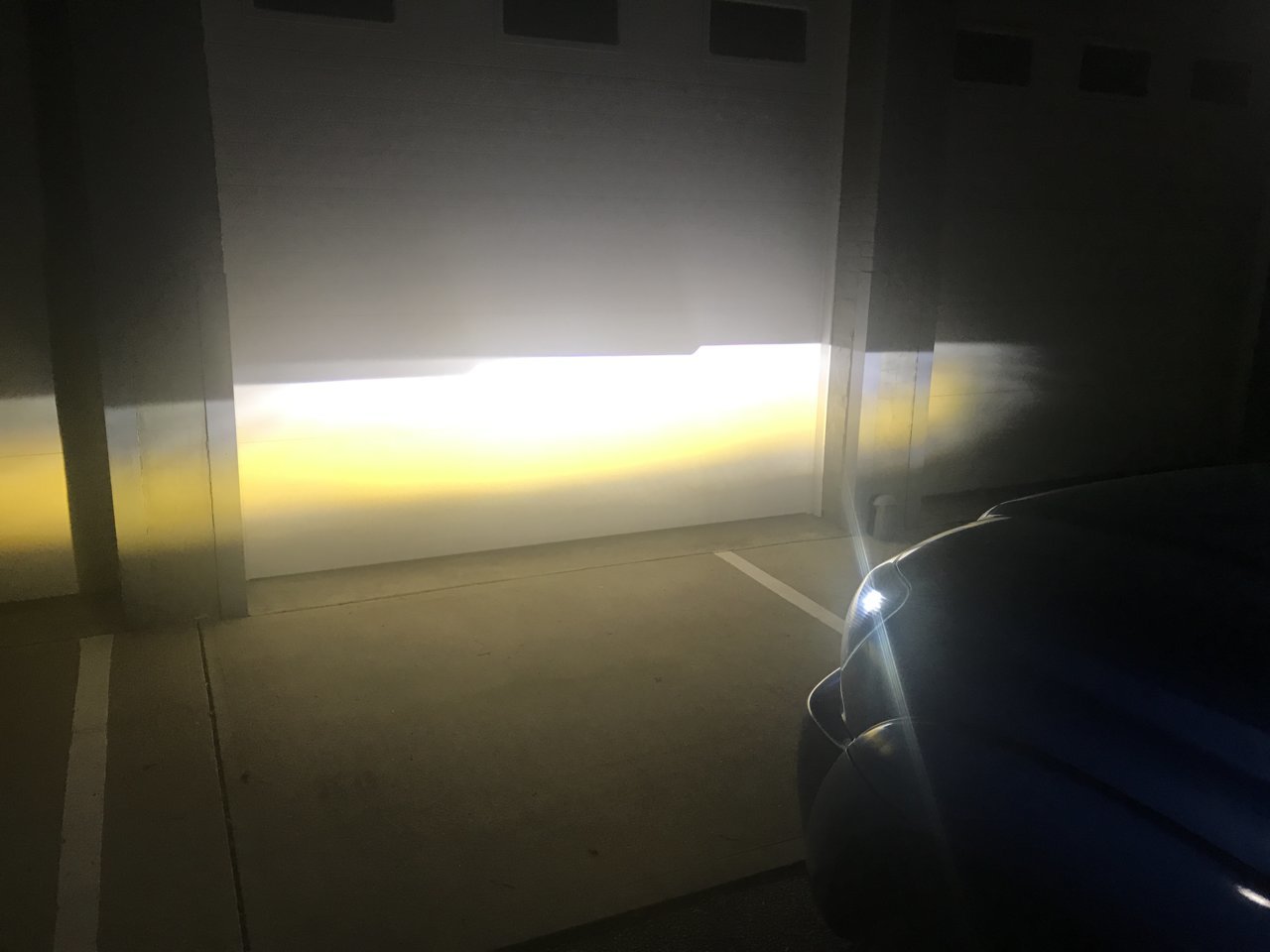

    A wider angle Rigid SAE fog output shot
    vs a wider angle Baja SAE output shot
    The Baja light does not have the strong cut offs as the other SAE lights, and light up nearly the entire garage. Personally I actually prefer soft cut offs, as the hard projector cut offs do not blend as well into the headlight pattern. KC's G4 reflectors have great soft cut offs that blend very well. Baja's lights really have minimal cut offs as they literally light the ceiling almost directly above their SAE fog lights. SAE standards do specify a legal level threshold of gradient glare, I'd speculate these lights were designed to nearly max out that legal SAE glare level.
    Selective yellow glare is difficult to photograph. Here is a head on photo. Baja left vs Rigid Right. The orb of Baja glare is somewhat difficult to see in the photo.

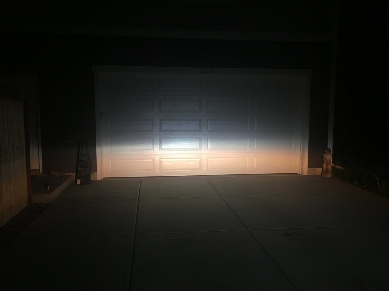

    But what about the SAE white Bajas?
    Baja has one of the best color temps out there for their white LED lights. Pattern is identical to the selective yellow Bajas. 2.5 panels in height. Comparing the selective yellow Bajas to the white Bajas:
    While Baja uses 5000k LEDs, my readings were slightly less at 4800k. It could be the multi-optic caused a small loss in color temp. Looking at the comparison between the white SAE Bajas vs the selective yellow Bajas, the selective yellows have less than a 15% filtration loss with the colored lens, compared to Rigids 20%+ loss. Which makes sense, as the Baja light source and lens are closer together in color temp than Rigid's color temps. The small filtration loss is worth the color temp optimization IMO. And while both lights produce glare, yellow glare is much easier on the eyes than white glare.
    Comparing white Bajas to white Rigids.
    Pretty similar match up to the selective yellow Bajas vs selective yellow Rigids. However in white, the Bajas have a far better color temperature at 4800k, than Rigid which is a bit blue at over 7000k color temp. Baja's white color temperature is the best white LED fog color yet, with KC close behind with their 5000k white G4 fogs.

    The Baja SAE pods produce best in class pattern area coverage, but also worst in class glare. While they produce 2x the area coverage of the competing Rigid fogs, they are also less than 1/2 the output intensity (since their light is spread over 2x+ the area). Meaning Rigid is twice as bright in the fog pattern region with 2x the measured lux output.
    While I appreciate what Baja was trying to achieve with their unique approach, I think people expected better cut offs from such a major name brand lighting corporation. Rather than trying to produce near the legal maximum glare level, most other companies have tried to go beyond to create much brighter lights while producing far less glare than legal limits regulate to manufacture more street friendly high performance lights. Rigid's SAE lights pack far more punch in a much more street friendly beam pattern with strong cut offs compared to the Baja SAE lights, though the Baja lights do cover a larger area. I may use the selective yellow Bajas in an upcoming project as additional aux fogs that can be turned on/off independently from my primary fogs depending on traffic for their wider area coverage.
