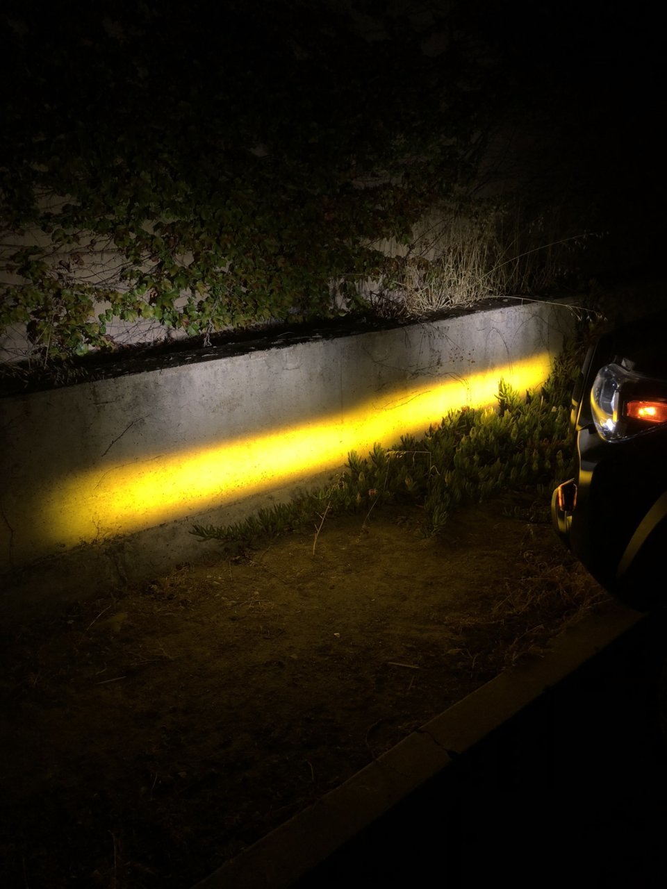

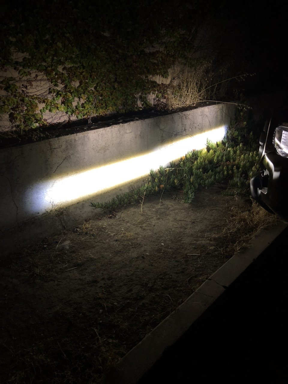

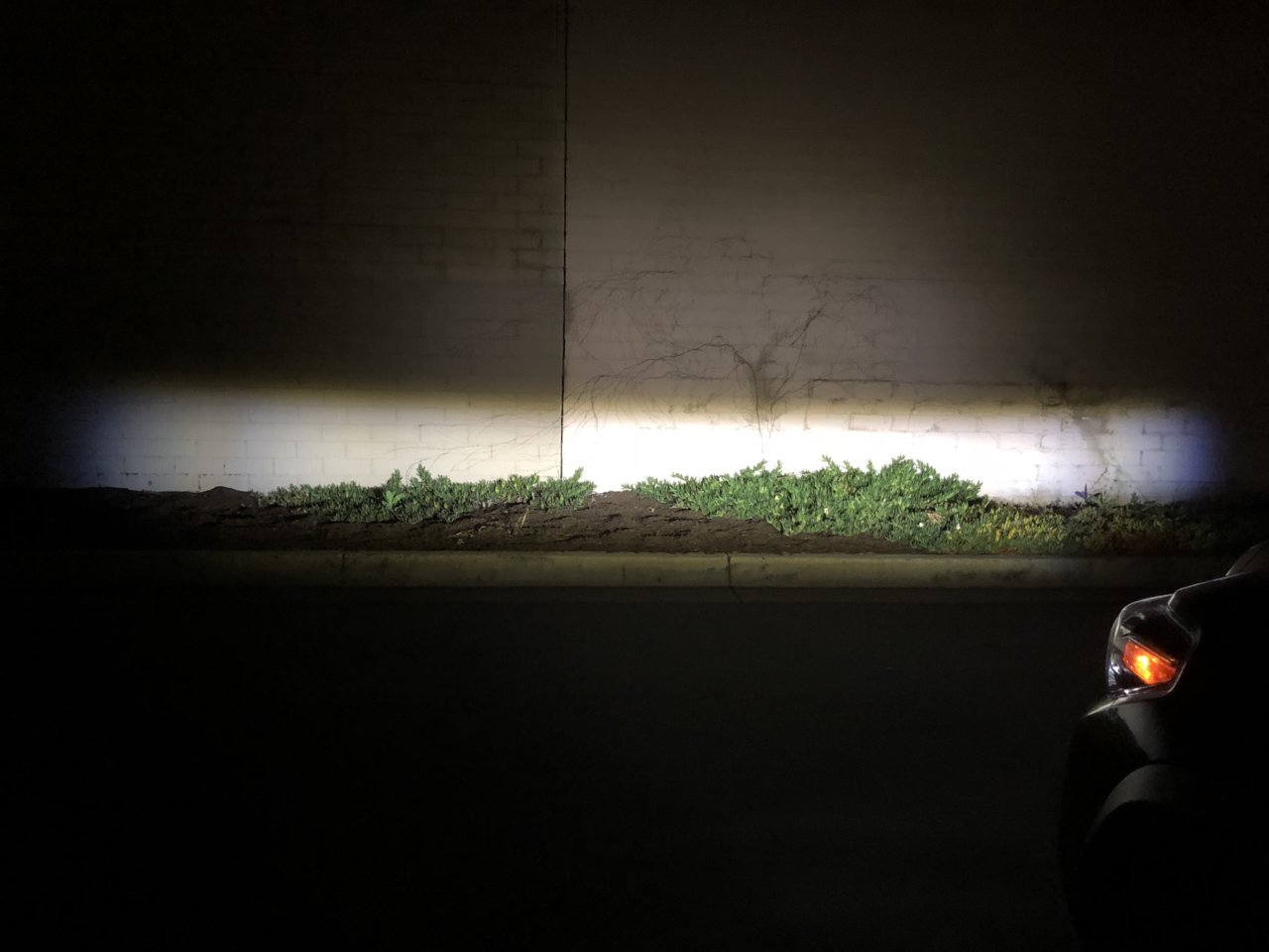

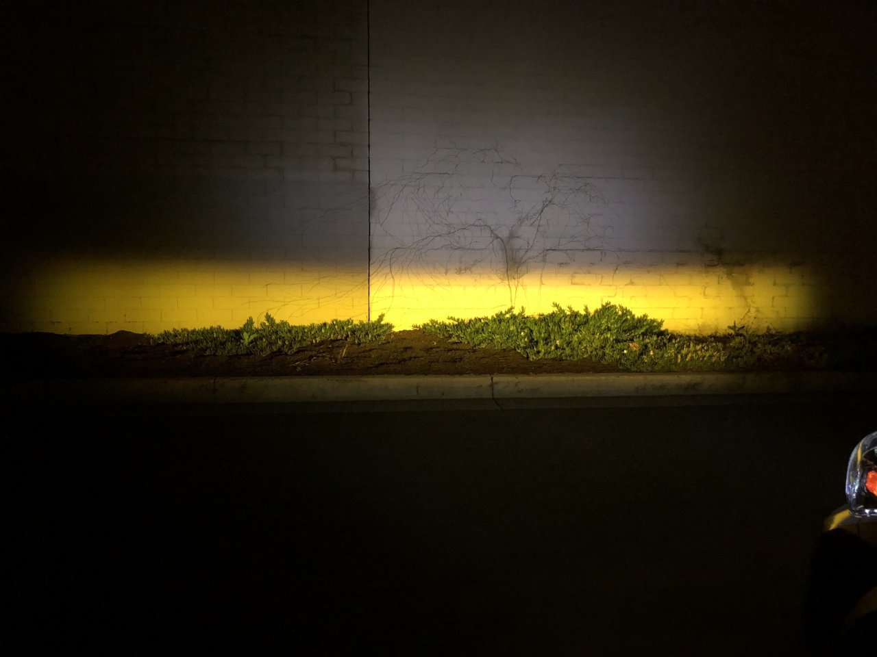

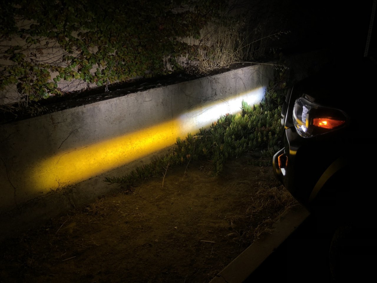

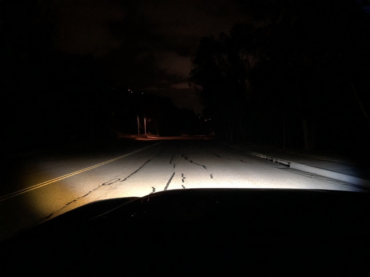

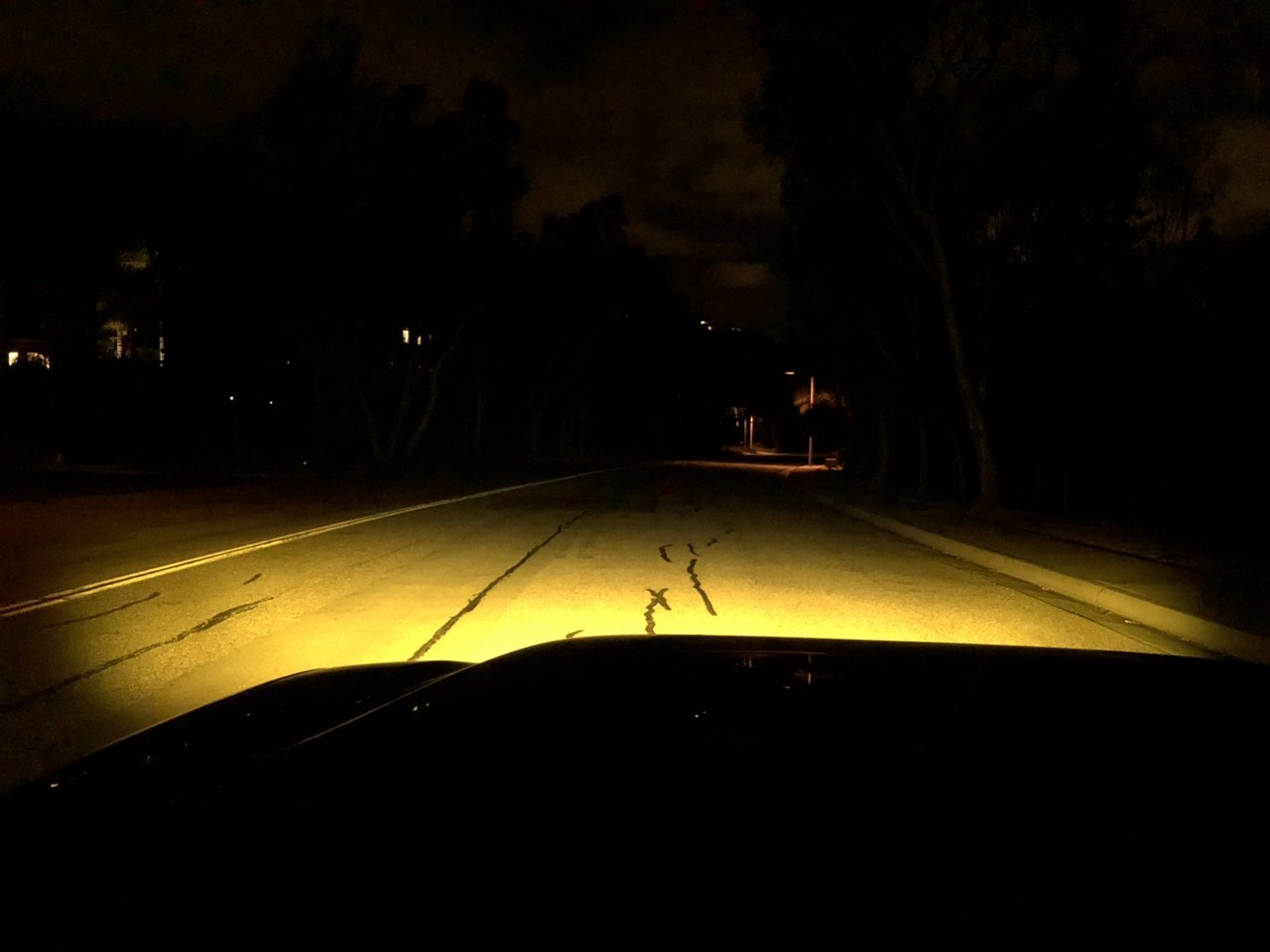

    Alright here are some night shots for @TRD2010SpeedwayBlue and @crashnburn80. I hope these help show a bit of the amber covers vs. the white light on the Rigids.
    ** All photos were taken with the Fog Lights on and Headlights Off. My LED DRLs were also on as I cannot power my fogs without them because I'm wired into the factory switch. The DRLs don't put out much light though when the fogs are on.
    Driving with both Amber covers
    Driving Amber Cover on the Driver's Side, No Cover on the Passenger Side
    ~ 15 feet away from wall, Amber Covers on (*this wall is raw brick on the left and painted brick on the right. I thought this would be nice to show a variety of surfaces and how the light reflects off them.)
    ~15 Feet away from wall, Amber covers off (*this wall is raw brick on the left and painted brick on the right. I thought this would be nice to show a variety of surfaces and how the light reflects off them.)
    ~3 Feet from wall, Amber covers on
    ~3 Feet away from wall, Amber covers off
    ~3 Feet away from wall, 1 on, 1 off

    o wow these look good!!

    Yes! They are pretty impressive. I haven't been offroad with them yet, but these combined with the H9 headlight upgrade I did are super nice on the roads. Night and Day compared to stock.

    Great looking pics, thanks for sharing! One nice thing about the covers is the ‘adjustability’ of the color.
