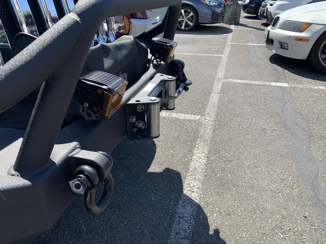

    Saw this Jeep in the office parking lot today. This demonstrates the need for an SAE light with compliant cut offs. These were pointed so far down toward the ground to presumably mitigate the glare they would not be very effective in lighting the street ahead. The picture doesn’t do the best job at showing the extent of the angle. They were Rigid non-SAE pods.

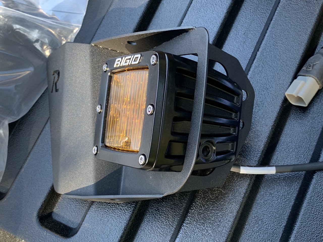

    Was installing the Rigid selective yellow SAE fogs this evening and my Rago mounts appear to be manufactured incorrectly. I’ve purchased them in the past without issue. The backing mount plates have been welded on up-side-down so the bottom mount hole is now at the top. :annoyed:

    Yeah, that's gonna be a no from me dawg.

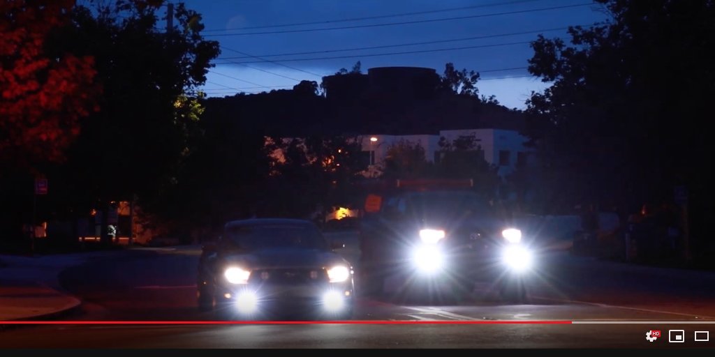

    I am confused. Are these driving lights or fog lights?
    You mention lighting up street signs, hazards, and other obstacles. Fog lights should never be lighting up street signs that are at a height of 6ft.
    I don’t have any distracting cutoffs with properly aimed fog lights and headlights.
    Your promo video shows a lot of glare coming off of them compared to the headlights on the same vehicle. How can you tell me that is not distracting to other drivers?

    Wasn’t planning on it, but I could certainly take measurements above the cut off for relative comparison. Measured data is far more telling than subjective ‘opposite driver direction’ tests.
    Need to up your SAE membership level for free access. :)
    If you are running low performance 9003s they technically could be brighter in lumen output. If you are running H4s that is highly unlikely.
    Yeah, wide-cornering squadrons should have never been promoted as a foglight. They are effectively super-bright high beams that were dangerous to oncoming traffic on the road.
    Fog lights should definitely not be lighting up street signs.

    No amount of explanation will make your pattern safe. How the street signs are illuminated is not ok. All this light will do is get law enforcement attention and hurt the progress trying to be made with sae led lights. It is no different than those who drive with hids in halogen reflectors, blinding. But I am honestly not surprised at all coming from a company that told everyone their squadron lights were "street friendly." Well those aren't either and we all know it. All to make a dollar, right?

    They are within the legal limits. What's the point of legal limits if they are unsafe? Did you have input on the SAE regulations and get overruled?
