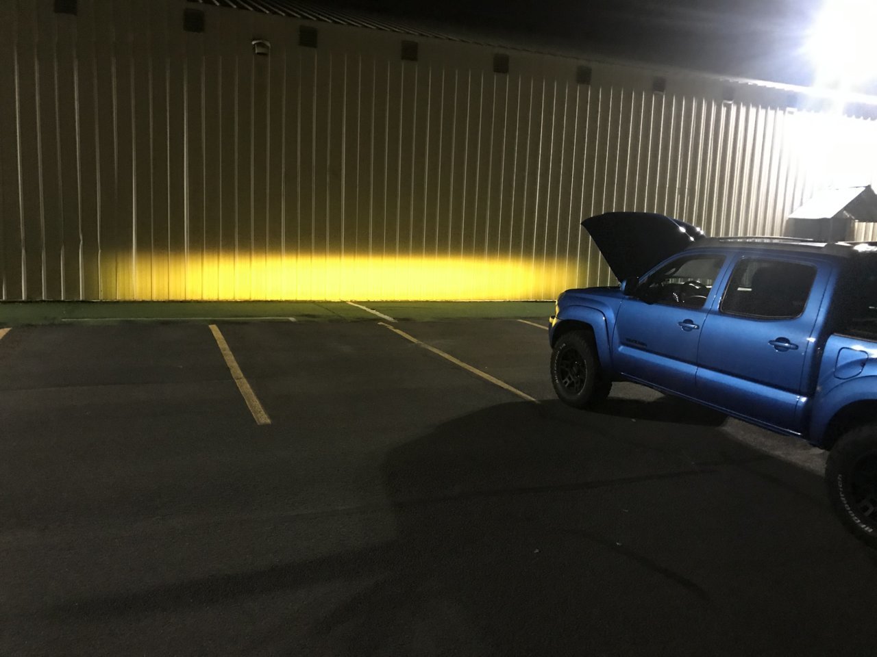

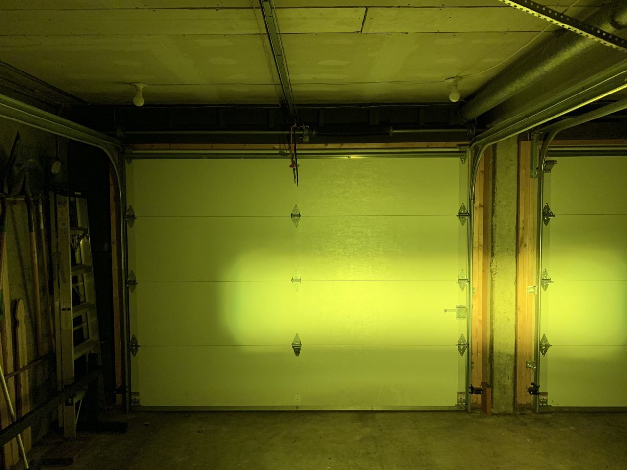

    messing with this aiming. idk in person it doesn’t look terrible.... 25 feet from wall

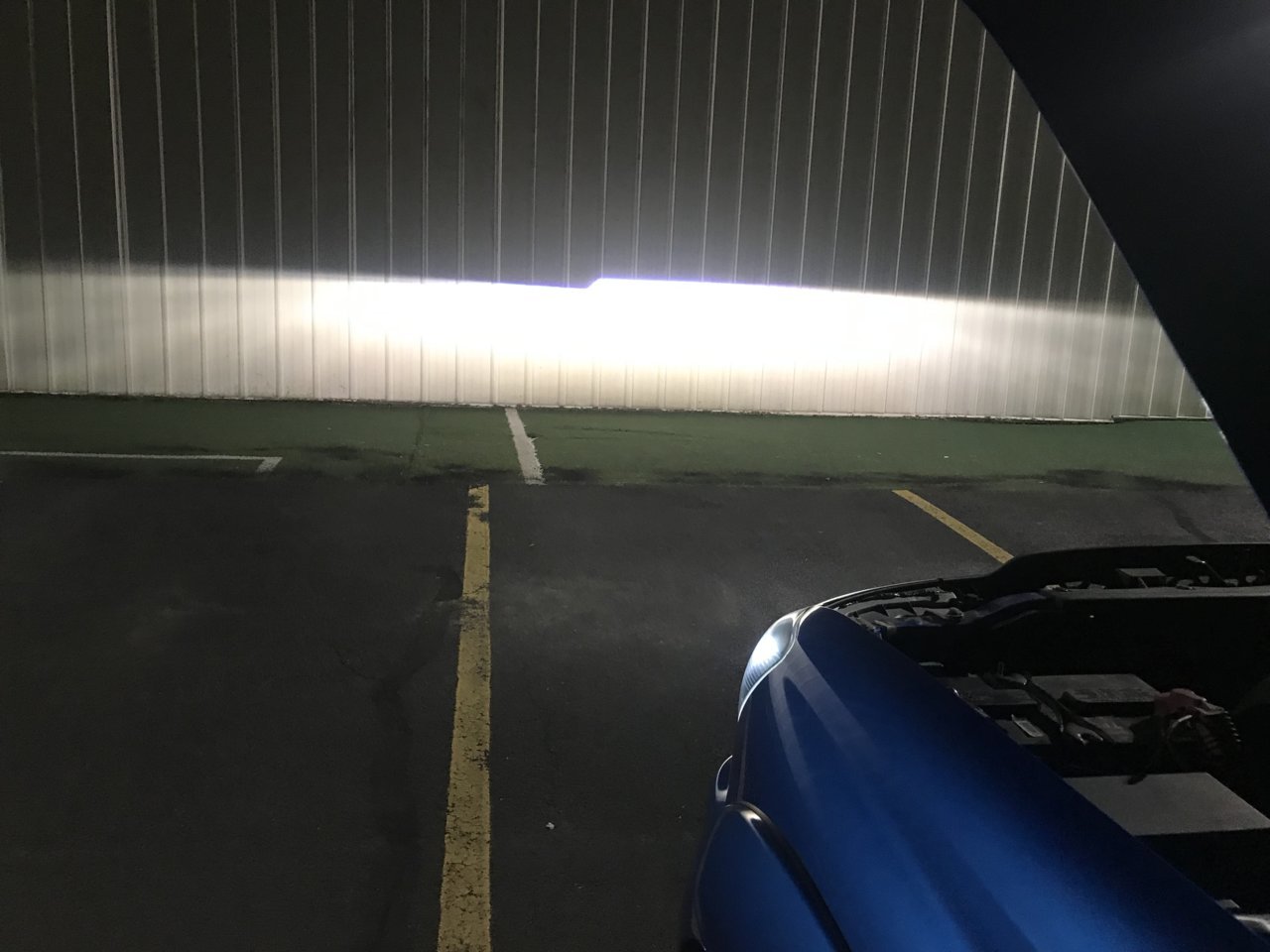

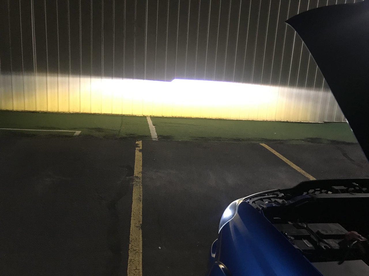

    messed with my fogs some more like 40 inches off the ground... is that too much??? adjusting these up and down is a nightmare

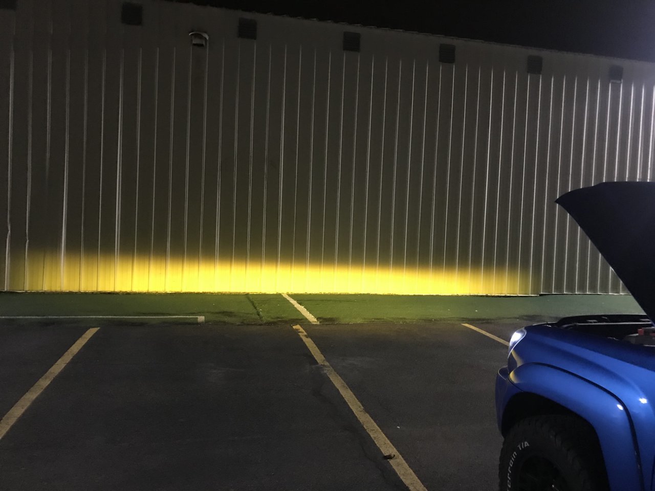

    Looking much better!

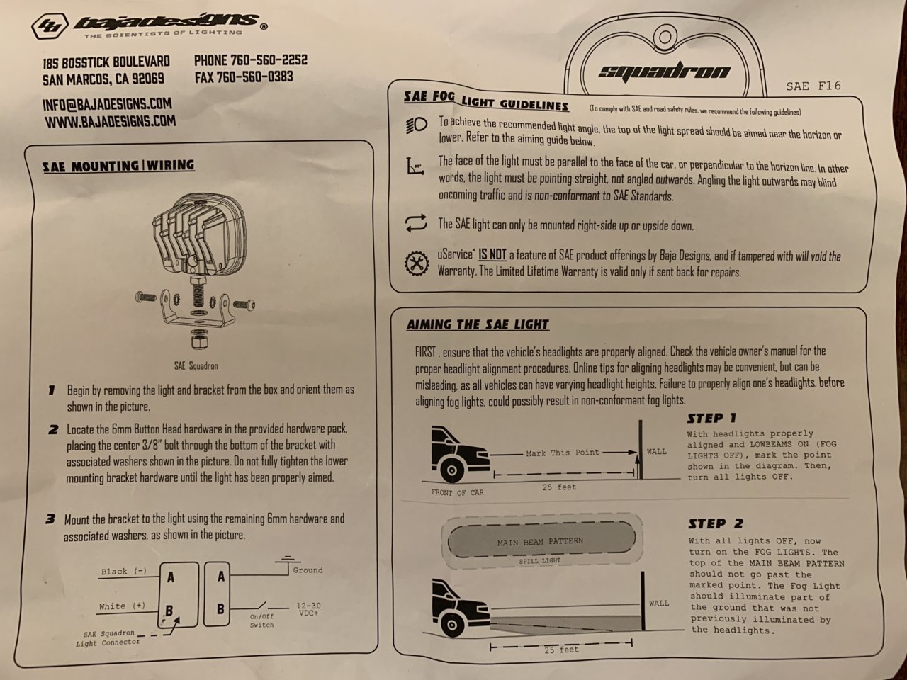

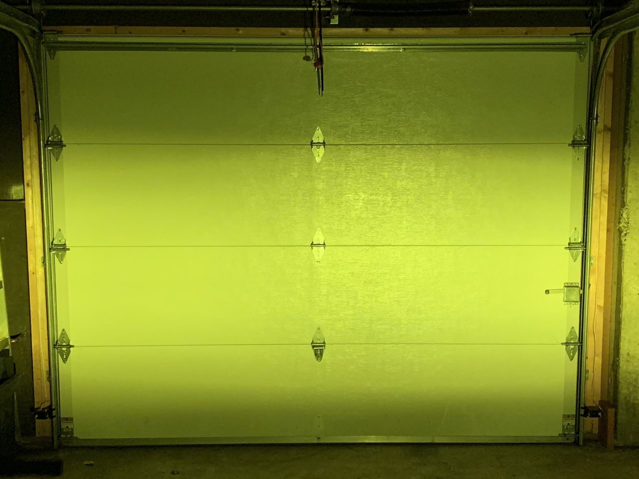

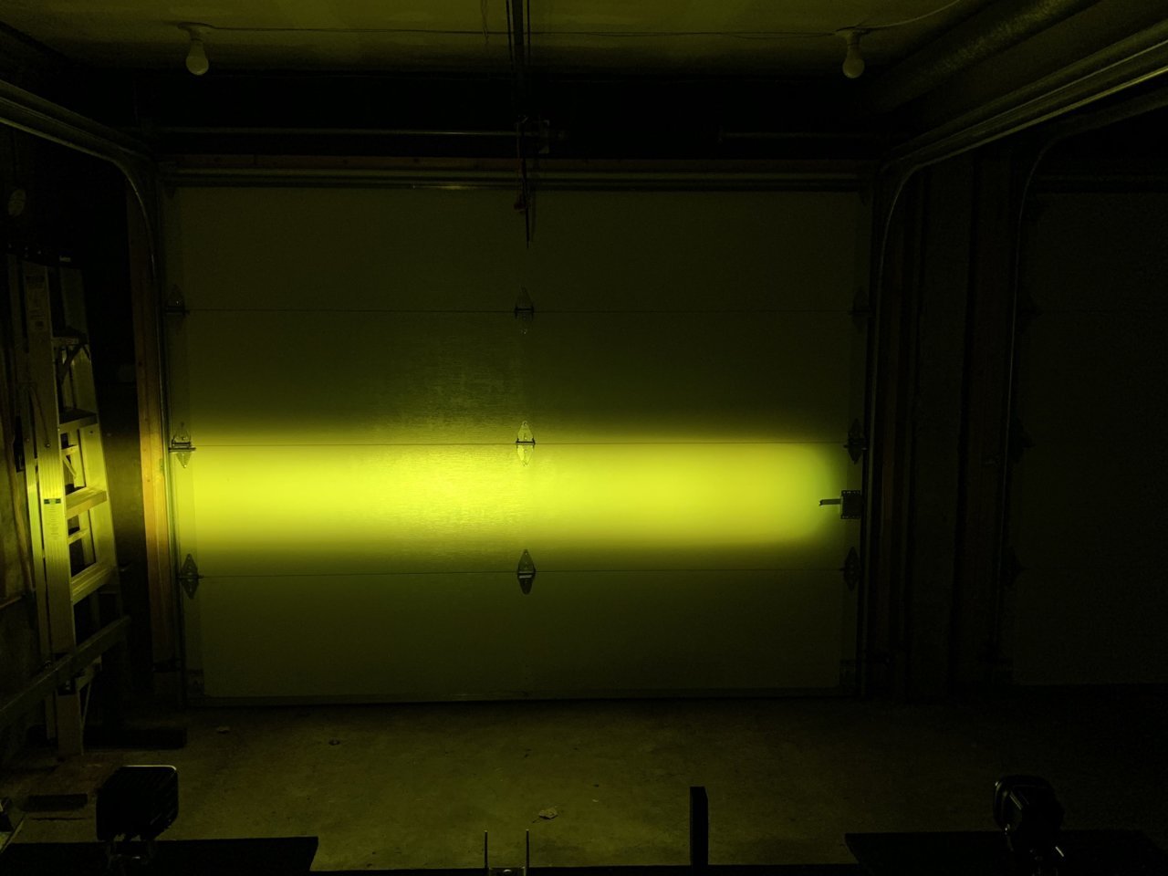

    Definitely 100% agree on the BD design aesthetics. However no amount of aiming will keep the the BD lights from illuminating street signs unfortunately. Per BD this is ‘by design’. Fogs have no business illuminating street signs, as that is what your headlights are for, so the confusion in aiming is quiet understandable.

    It's a pain the ass for sure, but it seems you got it. Looks great as far as i can tell.

    o yeah i was out for like hour and a half i think i have to lower the headlights a little bit. but it was nice bc no one was bothering me. and was talking with @crashnburn80 and he was helping me. he is a good guy and very knowledgeable when it comes to this stuff!

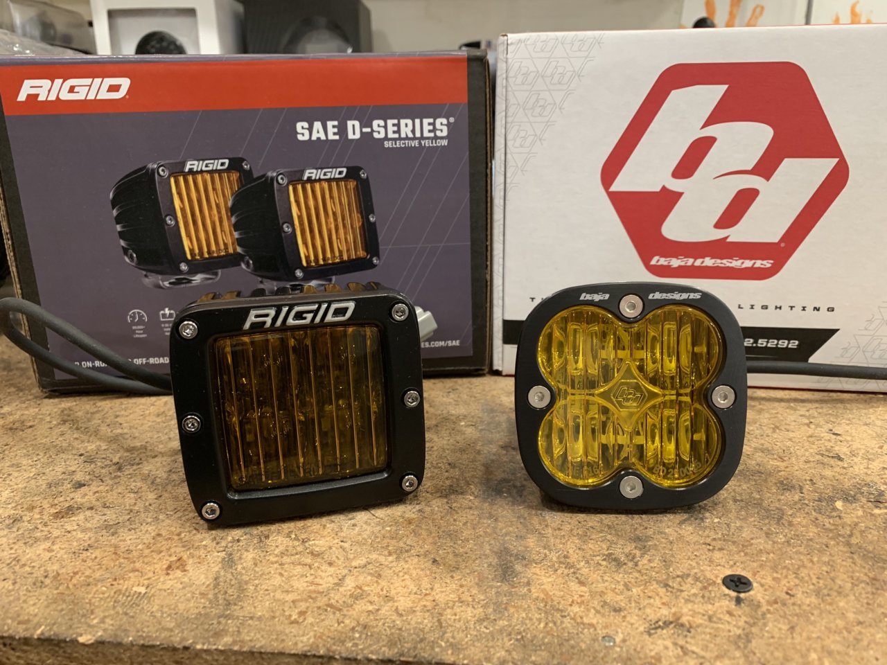

    Man I'm so disappointed about the BD SAE fogs. So strange they decided that illuminating street signs was a good idea. Can I please have the Rigid fogs in the BD color temp?
    Does anyone think having 4 Rigid selective yellow fogs up front would be useless? I was planning on getting 2 white, 2 selective BD fogs to fill my 4 bumper holes but now I'm not sure what to do. Is there any other SAE white fog that comes close to the color temp of the BD (has to fit in a steel bumper square hole.

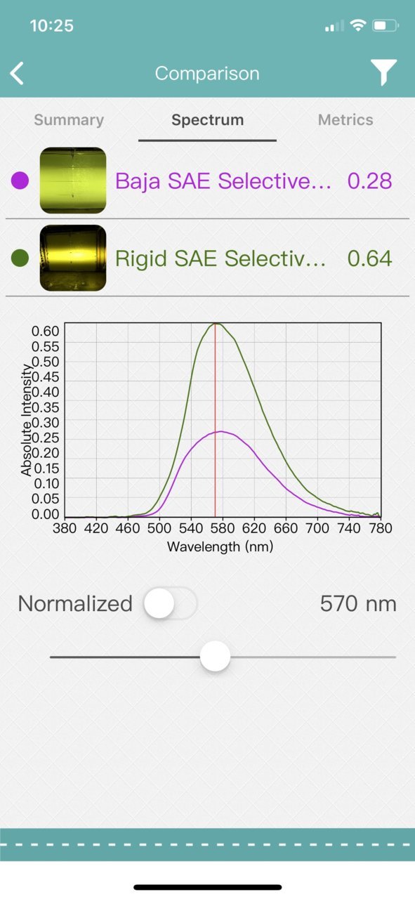

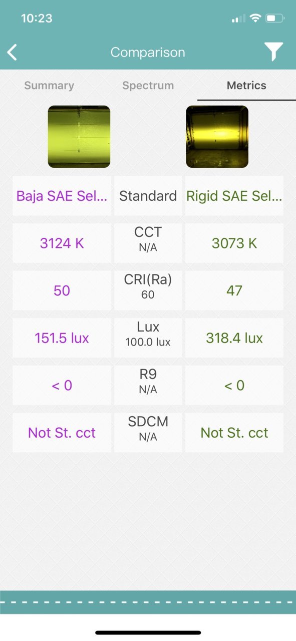

    I would opt for 4 Rigid’s in selective yellow anyway (vs white + yellow), the color is better for the purpose. You might measure the bumper holes and see if the KC G34s would fit, their color temp is similar to Baja.
    I’m going to run the Rigid’s as primary fogs, then the BD as aux fogs and wire it so the BD fogs are independently controllable when the main fogs are on, so the main fog switch will be effectively the master fog switch. This way I get the sharper cut offs and higher intensity of the Rigid’s, but then larger pattern area of the Bajas when I’m in areas without traffic.
