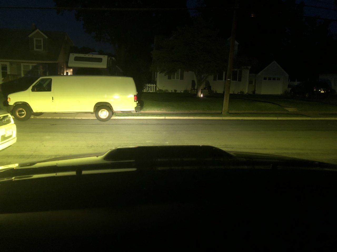

  20. Jul 27, 2019 at 6:11 PM
    #1060
    bruciep07
    bruciep07 Well-Known Member
    Apr 11, 2017
    #215995
    114
    Bruce
    Central NJ
    2015 Sport
    Thought since I ran out of sunlight putting in my new BD SAE fogs, and since I haven’t seen this anywhere yet, thought I’d take the opportunity to snap a side-by-side shot of the light output of the squadron pros vs the squadron SAE. Both have amber wide cornering lenses, and in case you can’t guess, the pros are on the left.14137FF5-F1DD-4E0D-AC18-CC086F01EC7C.jpg
