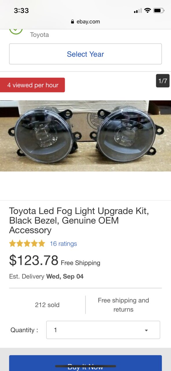

    Is anyone running these?

    Can’t be 100% certain but that kinda looks like the first set I had before my KC’s. They eventually fogged up with condensation.

    I got them for my wife's 4Runner. Awesome fogs for the money and better than the Morimotos. Crash test these in the OP.

    Covered here in post #733: Toyota LED fogs

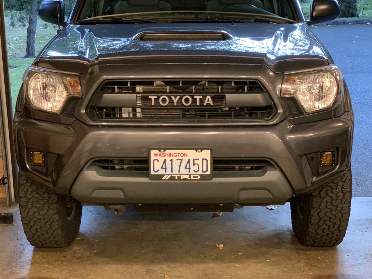

    Test fitting the Rigid Selective Yellow fogs with Rago mounts. Initial night output tests are exceptionally promising.

    how are you liking these? almost bought a pair of the BD SAE'S but then I saw this and it's beautiful. seriously contemplating doing this exact same thing.
