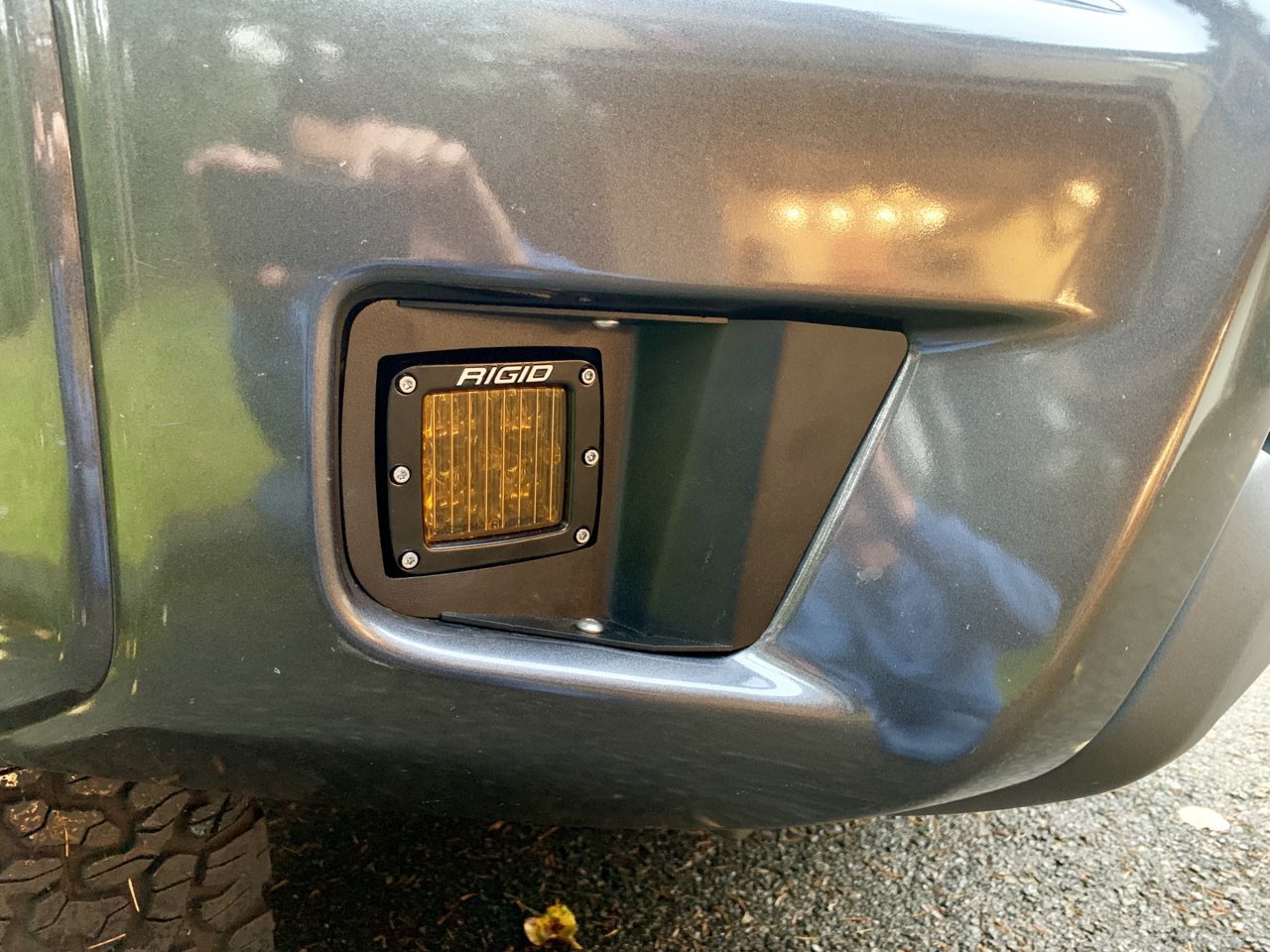

    Finally finalized my Rigid Selective Yellow install using Rago mounts.
    I like the recessed mount on the 12-15s, looks very clean for a traditional pod.
    Here is Rago’s install video:
    https://youtu.be/T67hhWIsIw0
    One of the problems with recessed mounts is very limited adjustability, since the small opening prevents much pivot of the light assembly. The mounts have a bit of play in how they fit, meaning if you drill and bolt them in before checking your pattern, it is very likely you may not be able to align the beam correctly. So I installed mine with the lights powered on. Even then, I couldn’t get the beam pattern correct.
    I then made the mounting holes in the bumper slightly oversized, allowing for some play and small aiming adjustment in the mount assembly depending on how it was seated. I then used larger washers on the backside to secure it in place and tossed the included nylon lock nuts and replaced them with lock washers on the back of the larger washer, followed by the Rago supplied supplied washer and a 3/8-16 x 1-1/2” hex bolt to thread onto the Rago supplied bolt. This makes it easier to loosen/adjust/service compared to the nylon locknut, and in my experience nylon lock nuts have a tenancy to seize over time, so I prefer locking washers.

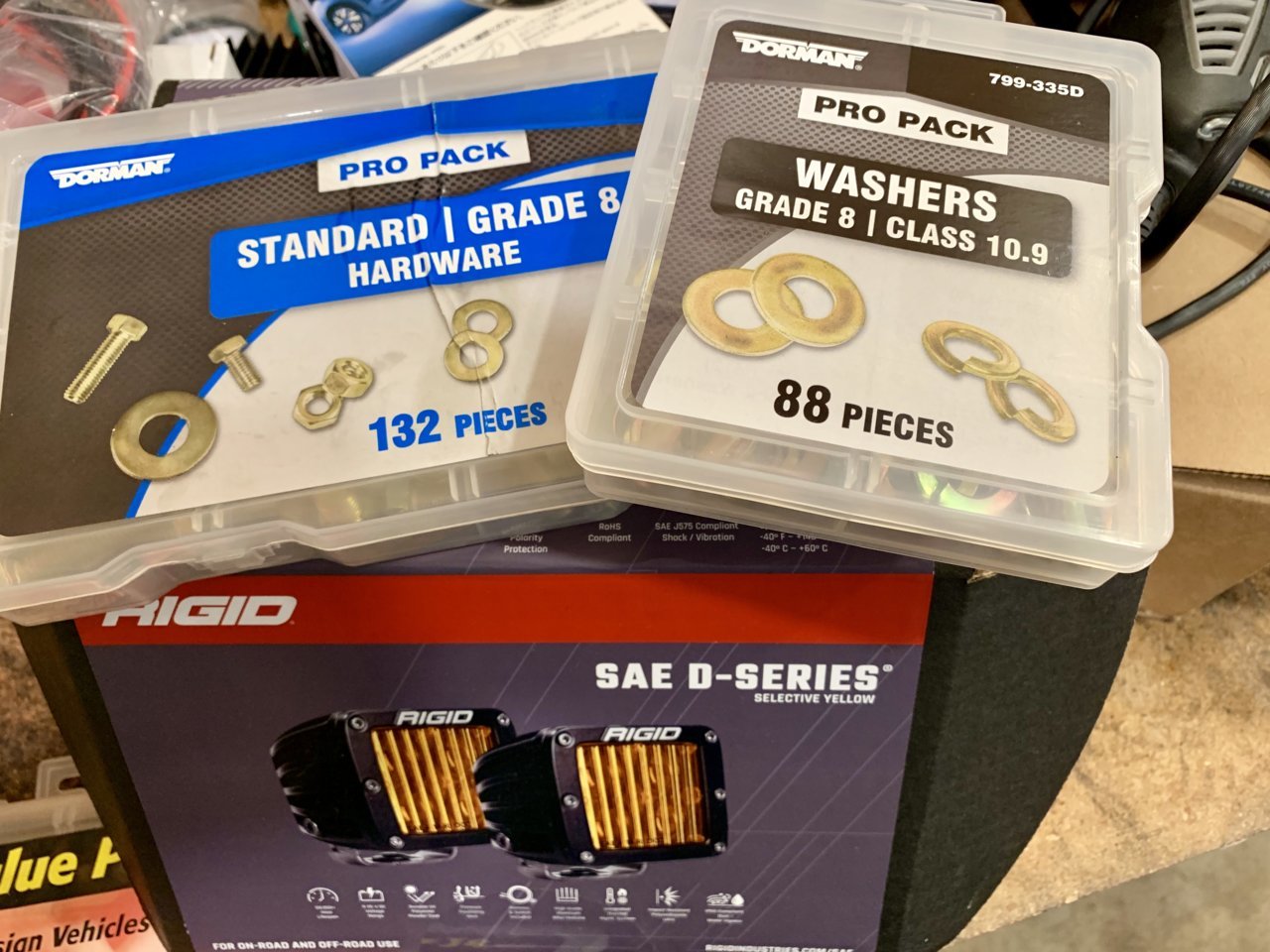

    If you don’t, I highly recommend keeping boxes of washers and hardware packs on hand to make these kinds of projects so much easier.
    With the oversized mounting holes, backed by larger washers, and using locking washers instead of nylon lock nuts, I was easily able to align my fog beam pattern before tightening everything down in place.

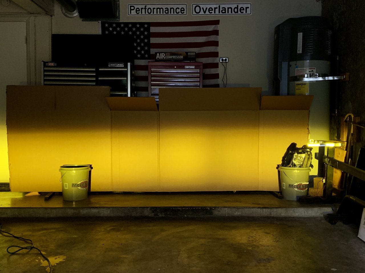

    The truck is angled up in this photo with only the backend out of the garage making the pattern appear high, but it fills in nicely below the headlights.
    Looking forward to testing these out on the street, and not too far behind looking to add the Baja SAE fogs and secondary aux fogs in the lower valence that I can control independently.

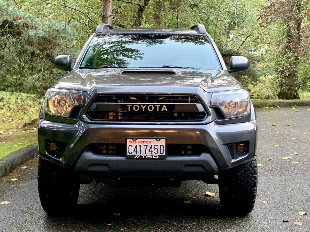

    It is nice how that setup utilizes the factory plastic bezel. The question is, is the light adjustable? Adjustability and aiming is critical for fogs, unlike a flood pattern. It looks like the pod face bolts directly to the plate in the instructions, which makes me think it is not, however the rear pod mount looks slotted rather than fixed, which would make it appear that it is... hmm.

    Yea, I feel like it may be adjustable to an extent because of the amount of movement the mounting brackets appear to have w/ the slots.
    But, there may just be some gaps between the round metal face and the back of the factory black plastic facia since it isn't technically connected (just pressed up against it).
    Edit: after closer inspection on the 4Runner at least, it looks like that plate gets wedged between the bumper cover or something. Hmmmm

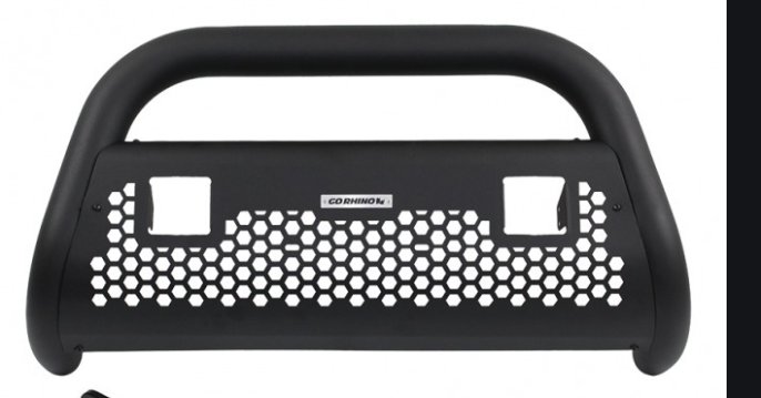

    Going to need help on this one. My girl gifted me a Go Rhino rc2 lr bull bar but without the lights I really don't need lights but the holes are there so wanted to go with the OFFROADTOWN but I need to know what kind of harness or brackets I need. I have no experience on this so asking the gurus. Capture.jpg

    How do you want to hook them up? Do you want them to come on with your fogs so you don’t need to wire a custom switch?
