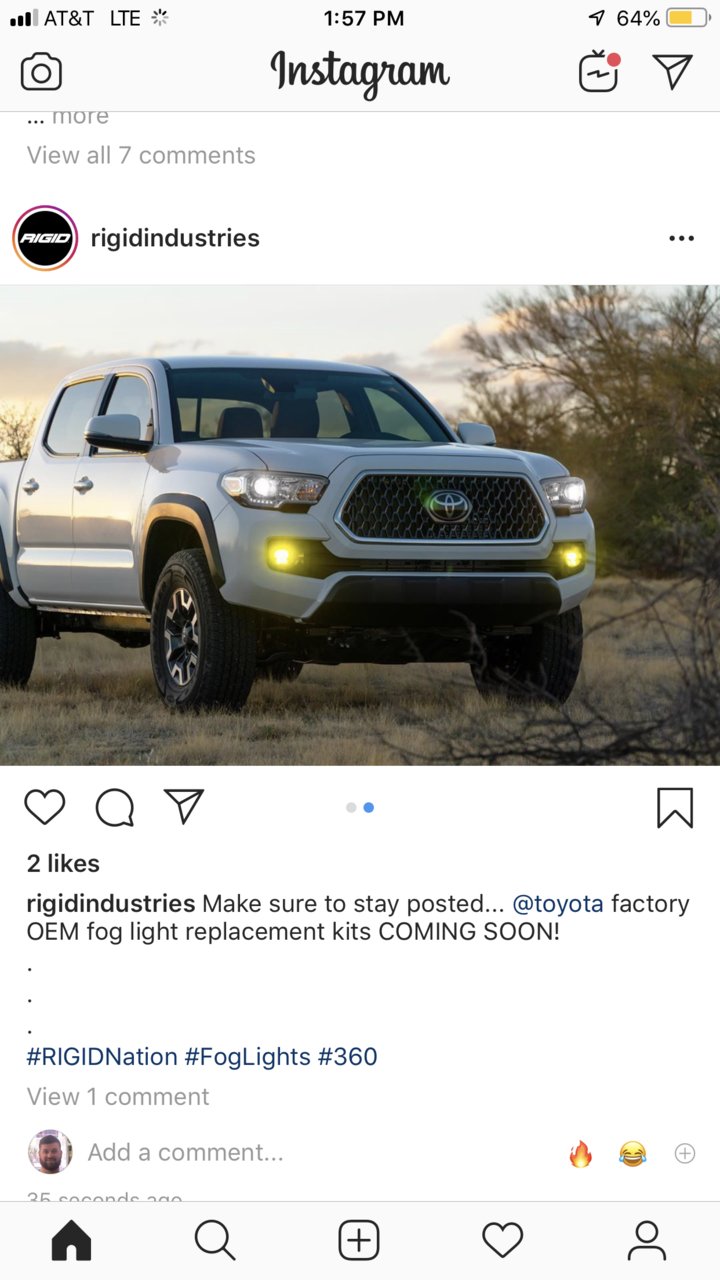

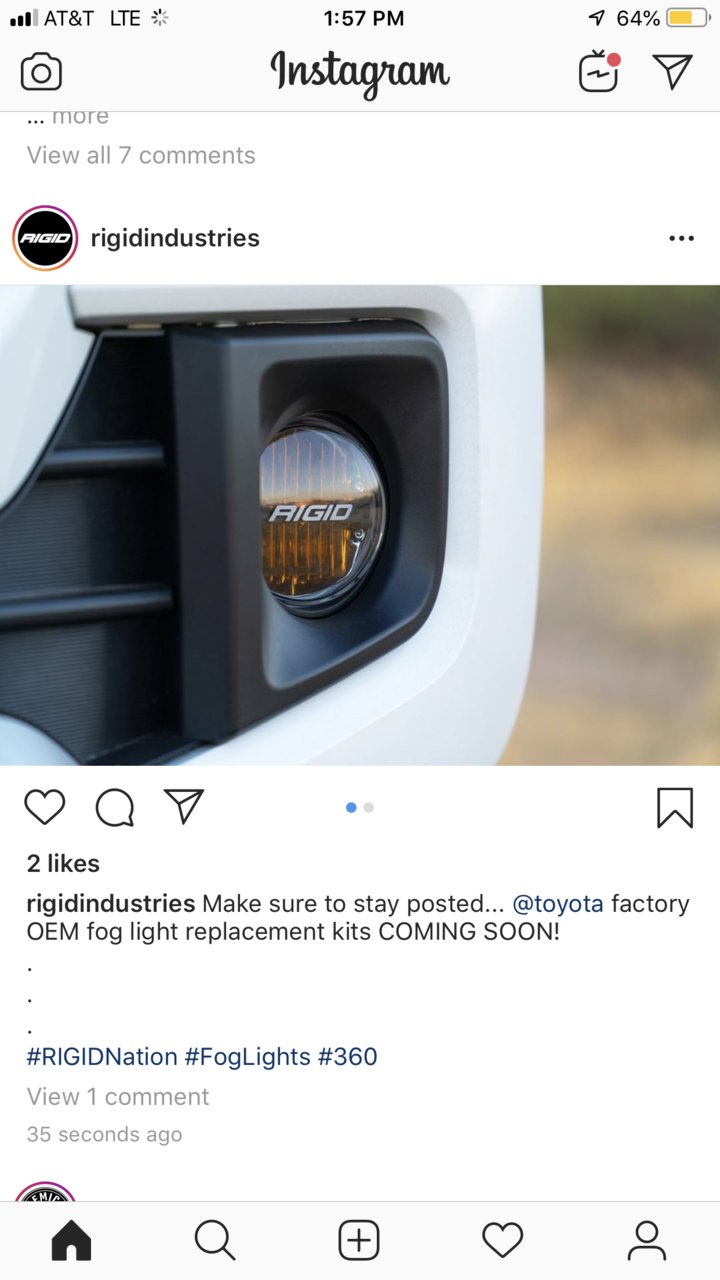

    Nice! Last I heard the OEM mount kit will launch end of October. I should have it for testing a couple weeks in advance.

    awesome they loook super clean for being round.

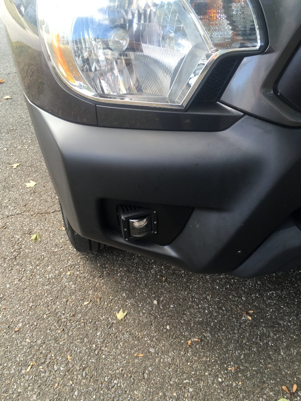

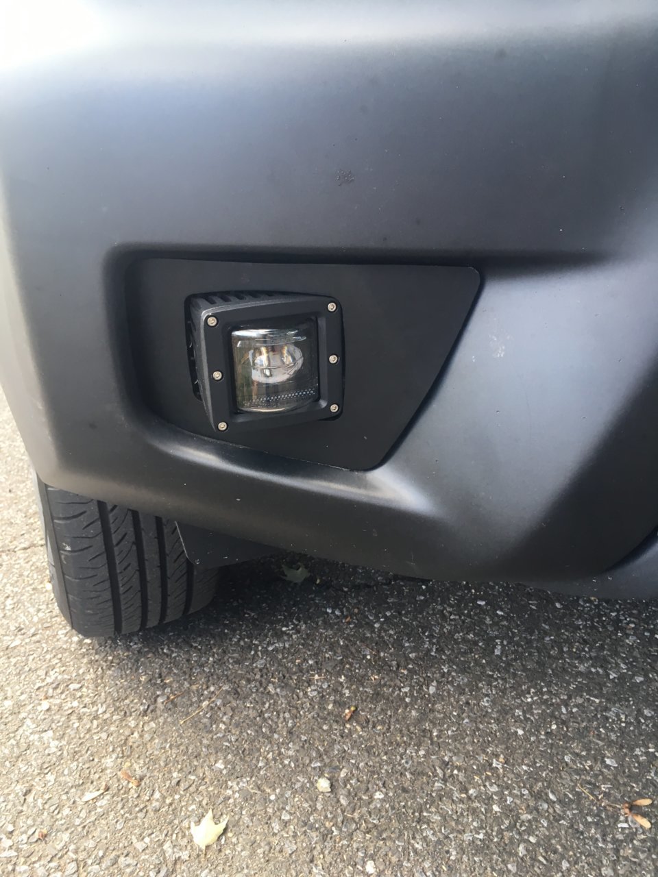

    Thanks for the help guys, got it all worked out. first mod on first vehicle (except dropping a cap on it)

    Be sure to wall check your beam aiming, you want them pointed slightly down to fill in below the headlights. And not up to cause glare at distance.
