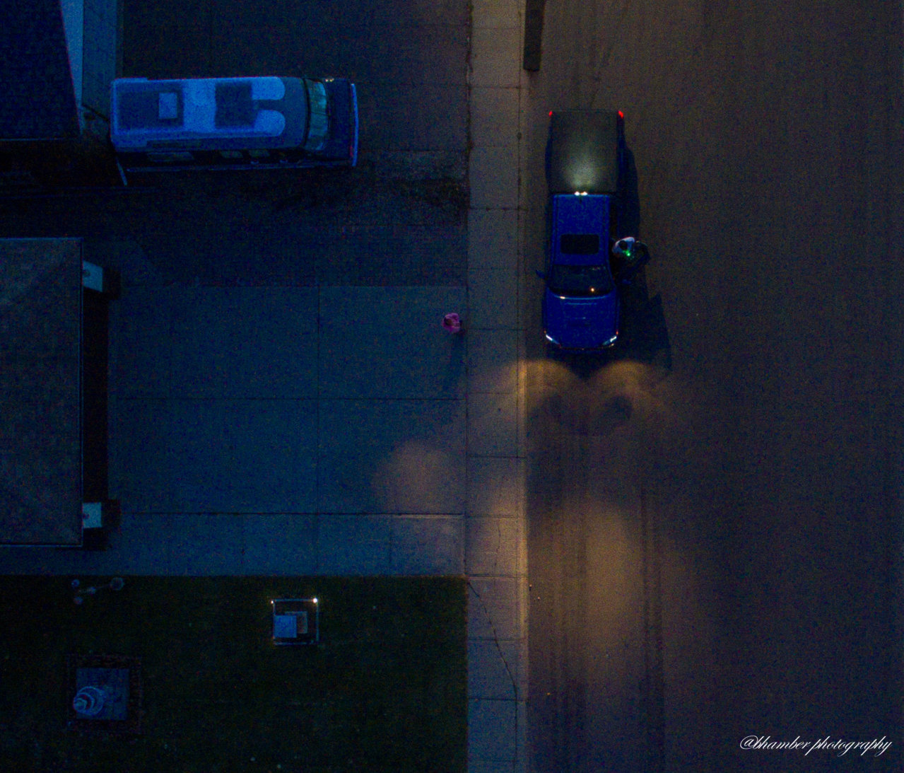

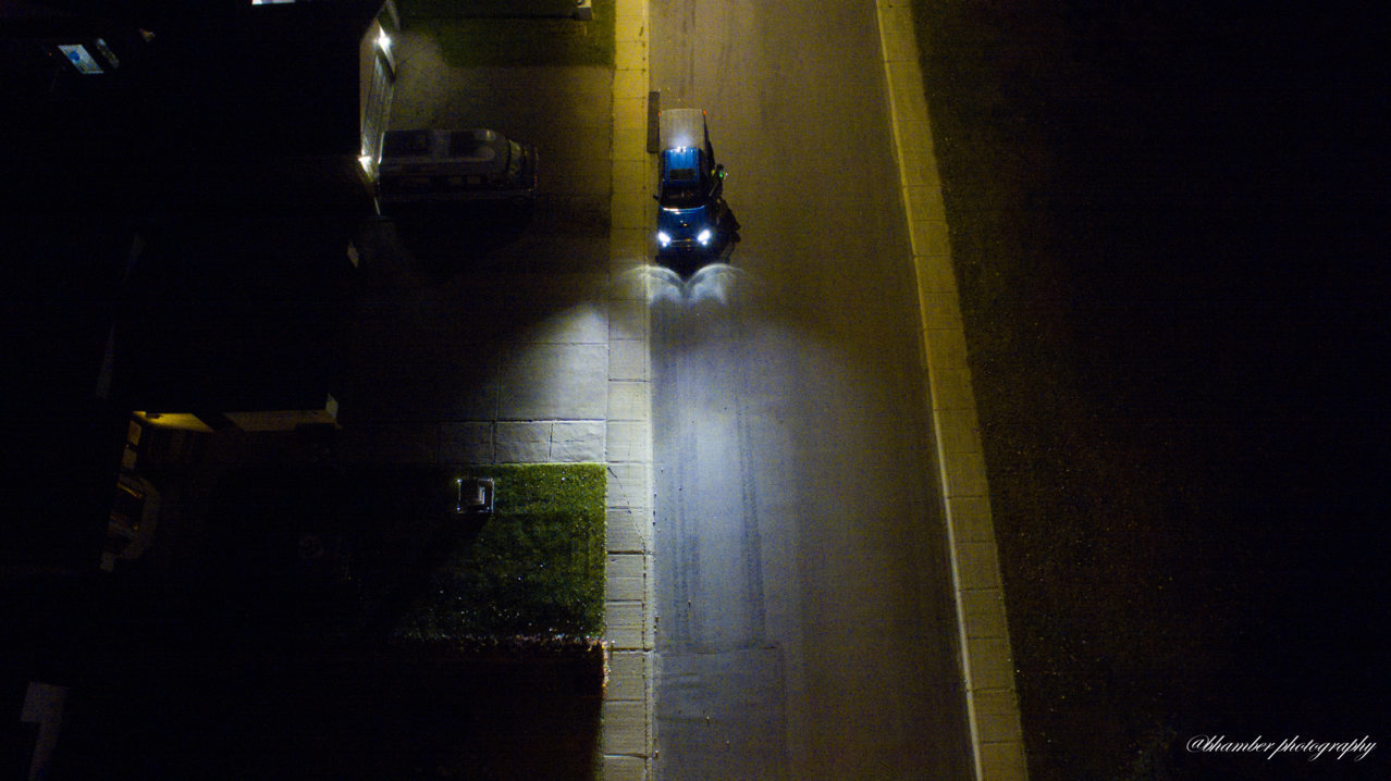

    I finally pulled the trigger after browsing this forum for several weeks. @crashnburn80 did a fantastic job at creating a unbiased scientific approach! I went with the Gravity G4's - the price was a bit steep, but I didn't want to be underwhelmed with the Morimoto's and OEM options nor did I want a square pod design (although RIGID is releasing a drop in pod version very soon). The fantastic warranty also made the decision easy.
    Initially, I was underwhelmed at the output, but I think the important thing to realize is that fog lights are just that - they are not headlight replacements. After driving for a few miles in some dark alleys, they actually compliment my headlights perfectly and allow enhanced peripheral vision. Comparing some drone shots of the OEM fogs and KC's, the difference is pretty evident. I'm actually impressed.
    OEM Fogs
    KC Gravity G4
    Xtreme Pro Led Headlights + KC Fogs
  18. Oct 18, 2019 at 7:45 PM
    #1338
    crashnburn80
    crashnburn80 [OP] Vehicle Design Engineer
    Jun 6, 2015
    #156893
    14,764
    Kirkland, WA
    2003 DCSB TRD OR
    Awesome drone shots! I’ve often thought about using a drone in a similar fashion, but just never pulled the trigger.
    Yes, you are correct, the fogs should ideally fill in nicely under the headlights and significantly improve peripheral vision. They should help illuminate the shoulders/ditches, but they are not headlight supplements. The G4’s are really nice fogs, they fill in a much larger area with a higher intensity and better light quality than the Morimotos.
