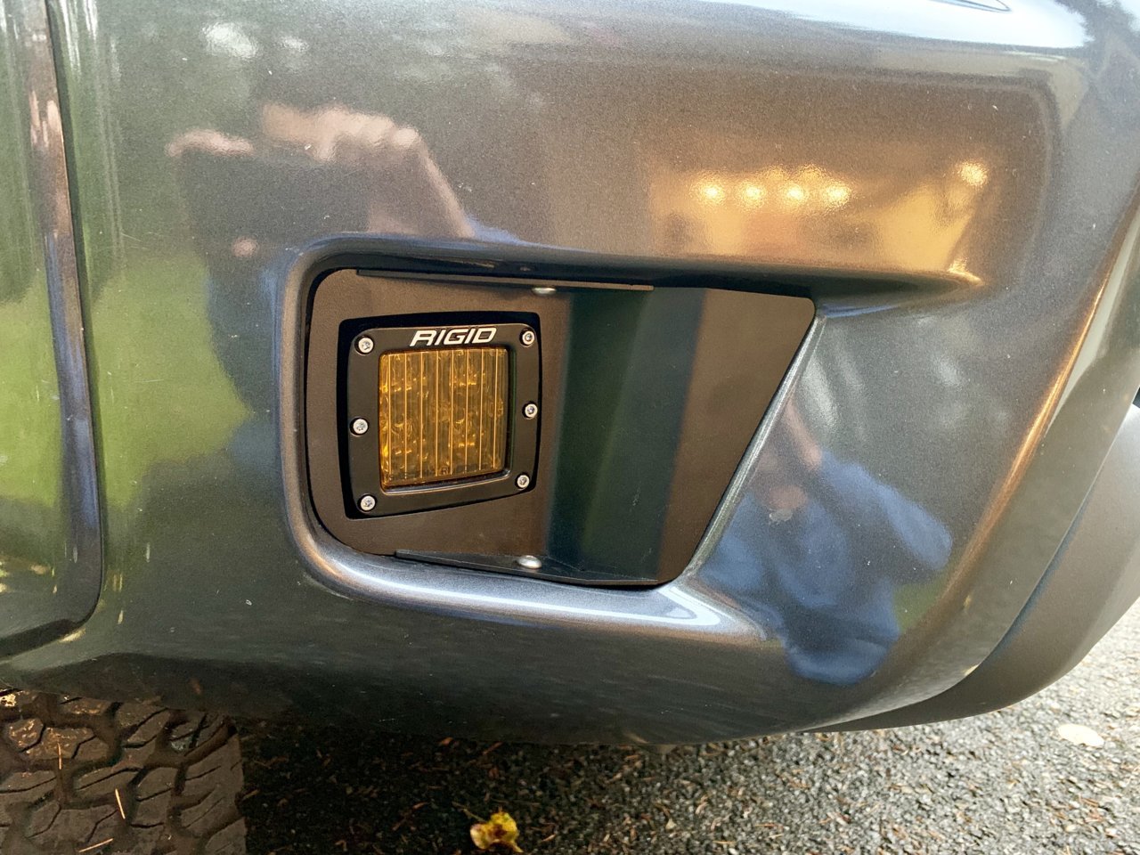

    What bracket are you using to mount the D-series? I got some Rago mounts and did a bunch of trimming and still couldn't get them to fit...

    Couldn't get them to fit? In what way? I used the Rago D-series mounts: CF52B473-6906-4A6F-A467-B2E2523E9BA9.jpg

    I couldn't get mine to seat all the way back. I will try and upload some pictures.

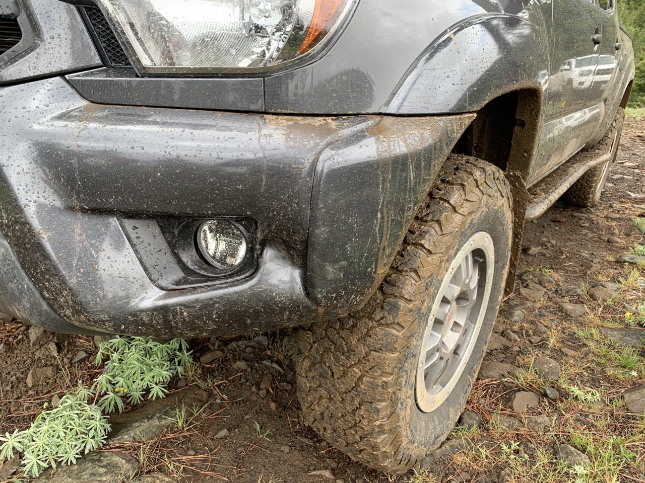

    You just sent the pics to me, but I had similar issues on the driver side, but my driver side isn't quiet square anymore after a trail impact so I chalked up the imperfection to the bumper. I was able to get them installed satisfactory to my liking. I over bored the drill holes in the bumper (not the mount) and used washers on the back side of the bumper to give me more adjustability in place, as I found trying to get the alignment/seating perfect with good aim with the exact right size hole was not very feasibible. It certainly wasn't as direct/easy of an install as I thought it would be, just took a little time to dial in. Did you trim adequate clearance behind the mount to clear the bracket? I had to clean mine up a couple times to avoid interference issues.
    My not so perfect bumper
    Pushing the damage back out. It is better looking now that pictured once I got it cleaned up and under the truck to deal with it.

    I worked it out much better than those pics not long afterward. The bumper definitely isn't in new condition anymore, but now I at least am less concerned on subsequent trail runs.
