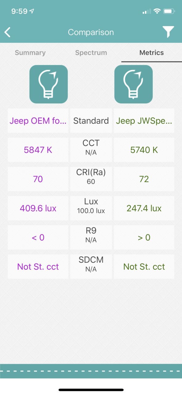

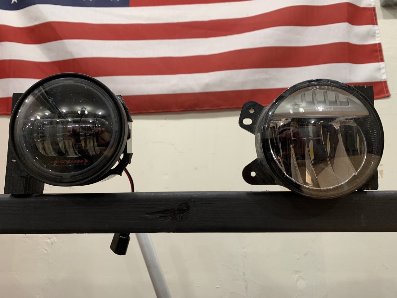

    Ok so would you recommend running these oem wrangler leds or the Toyota oem led fogs @crashnburn80 ive got the Toyota’s in my cart on Amazon but should I switch? Thanks for all the information and help

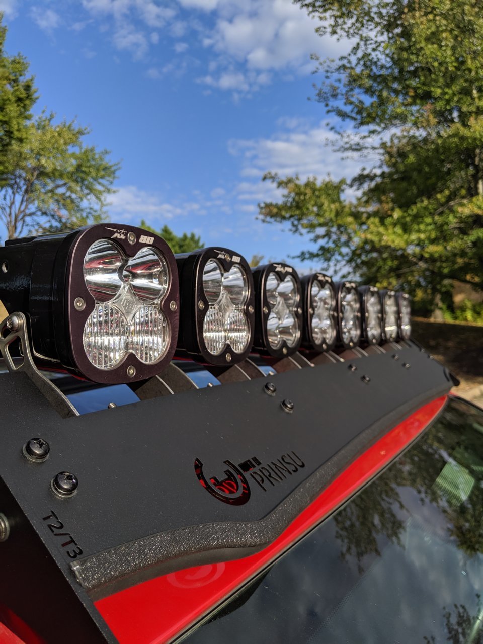

    The XL80s are amazing....

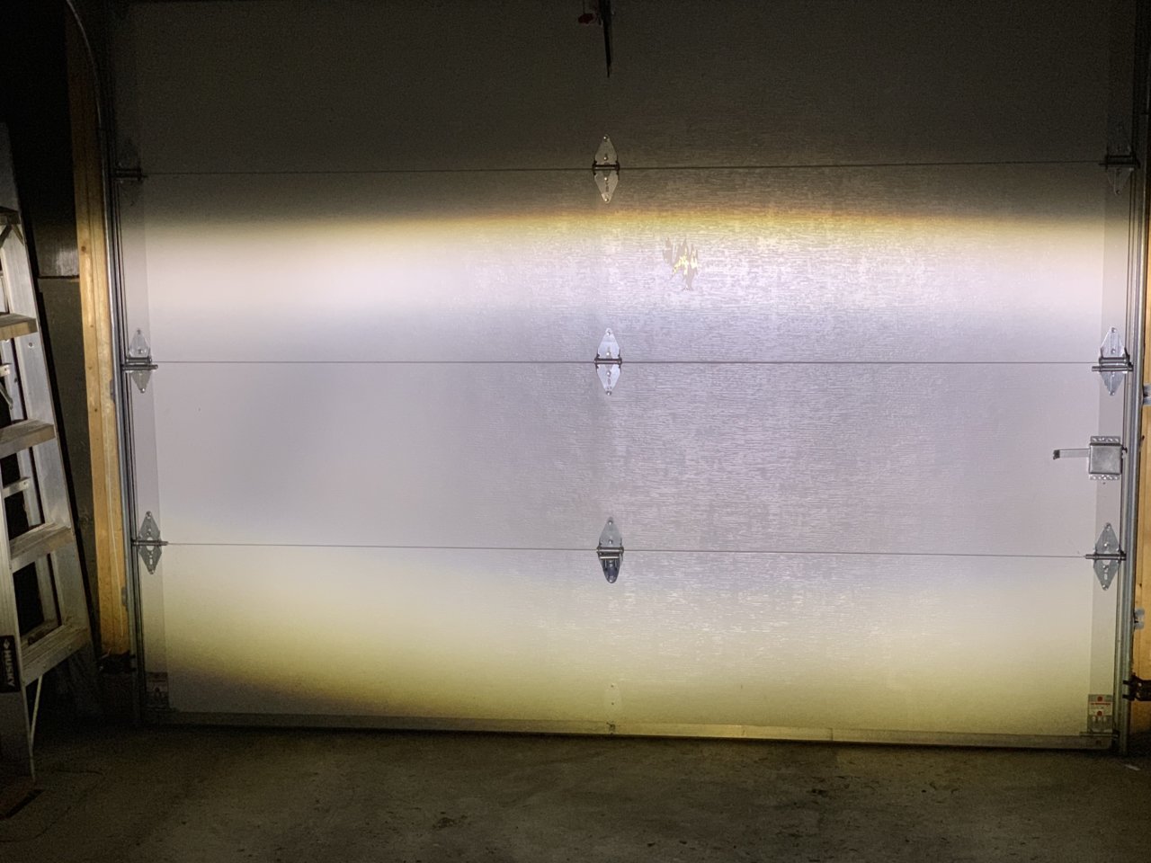

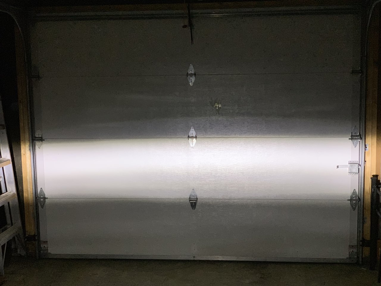

    Although the lights are the same 4" size, the Wrangler fogs will not mount to the Tacoma with their provided mounts, so it really isn't an option without some custom work. JW Speaker is a highly respected brand in SAE lighting and I was working on a Wrangler project with a JW Speaker SAE fog swap so I just thought it would be interesting to share the results, even though it didn't pertain to the Tacoma.

    That looks awesome, my D2 driving RI work for now but I'd love to have xl80s. Just debate of combo beam/ spot, white/amber..... to many choices. But that's a good thing.

    It's 4 XL80s in Driving Combo, 2 XL Pro High Speed spots, 2 XL Lasers. The idea being that it'll cover all the lighting zones at once.

    And drooling more lol. Killer set up. I'll just use mine for aux high beams, or anytime I need more light. Once I get a winch I'll start the light upgrade fund.

    Jeeeeez that’s badarse right there I tell ya

    This lighting stuff is kind of getting ridiculous and addictive to me!! Damnit man!! Those look awesome
