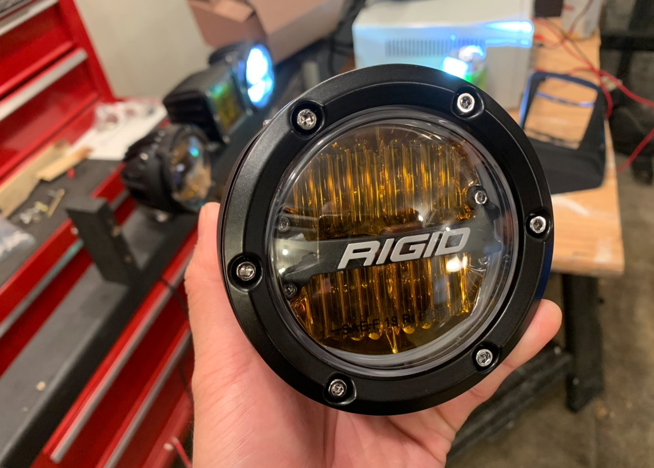

    Is it just me or do they look much better and more finished with the secondary lens cover on? Pics on the rigid website look like they don’t have the second lens and I thought the bar across the middle looked out of place. Not the case with the second lens.

    Rigid said that it was necessary to separate the upper and lower beam as if they overlapped in the pattern it would exceed the peak output allowed for SAE J583 compliance. The bar appears a simple way to prevent overlap in the pattern. I think it looks pretty sharp in person.

    I agree. I initially thought the outer lens was part of the fog mount kit based on Rigid’s IG pic shared earlier because the website photos do not really show the secondary lens. When I got them I was surprised to see the lens as an integrated part of the light. It does make it look like more of a finished OEM grade type product with the outer lens vs the traditional pod style lens.

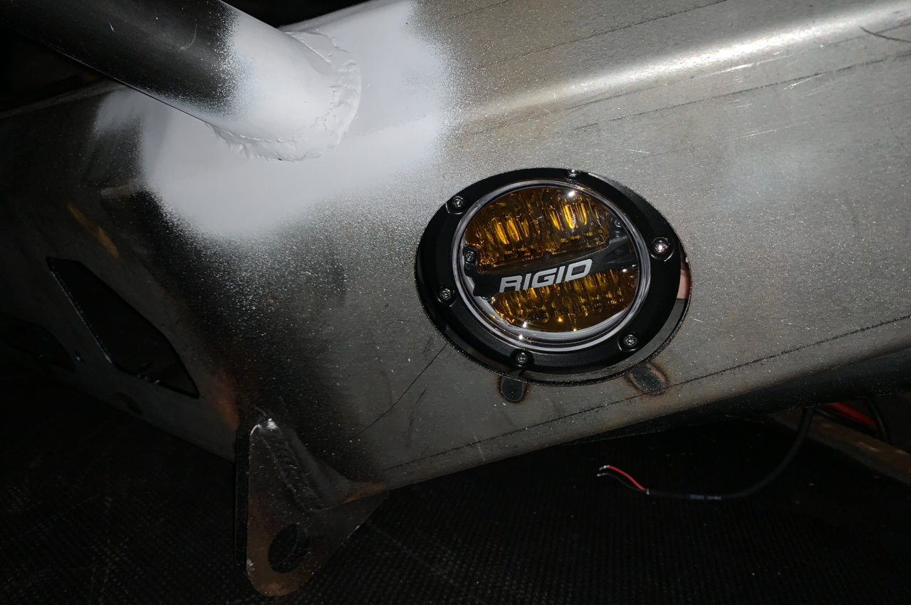

    Seeing these in person is amazing! I'm in love with the width.
    sacrificing a bit of brightness compared to the D-series for monster width is perfectly fine for me. Remember these are SAE and meant to supplement your headlights ON ROAD. The fog pattern fills in foreground and width on the side of the road, helpful for city driving to see pedestrians without BLINDING them. If you want width for OFF ROAD then you'll need ditch lights.
    Cant wait to have these in selective yellow before xmas!
    also look how sweet they look in my steel bumper.

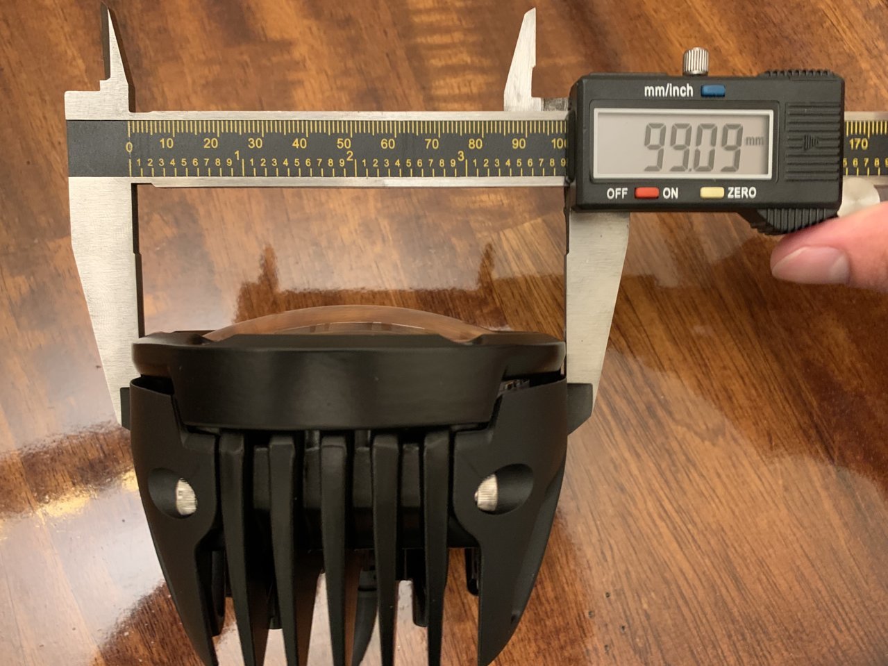

    That looks sweet. What size hole is that? Yet to see dimensions on the sae lights yet on RI website.
  16. Nov 3, 2019 at 4:04 PM

    @GhostedRaptor62
    The hole is 4" wide 3.75" tall

    99mm/25.4 = 3.9”
