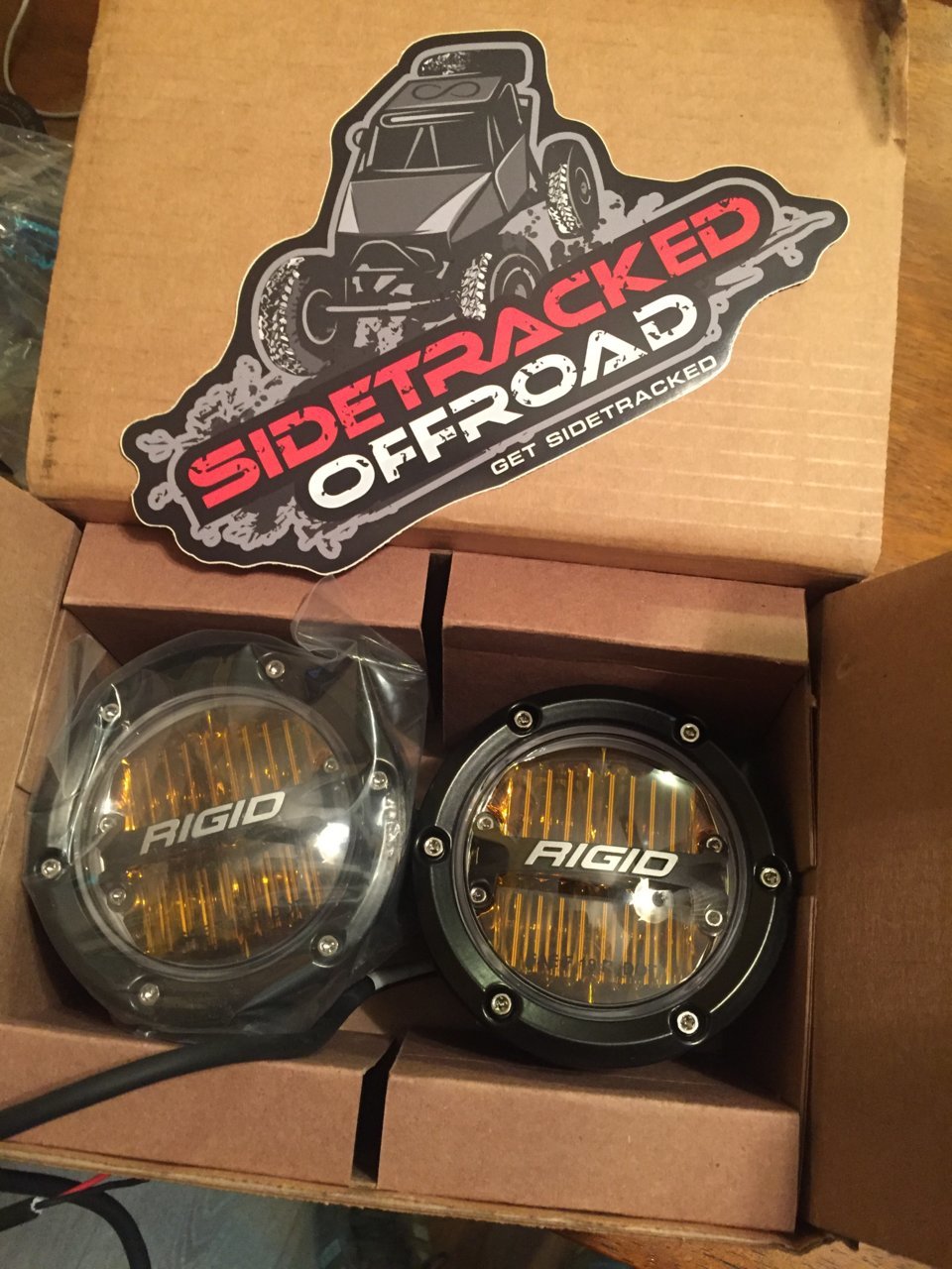

    Awwwwwwwwww snap! Look what just showed up! Now I just need to wait for my damn wire connectors to show up.
