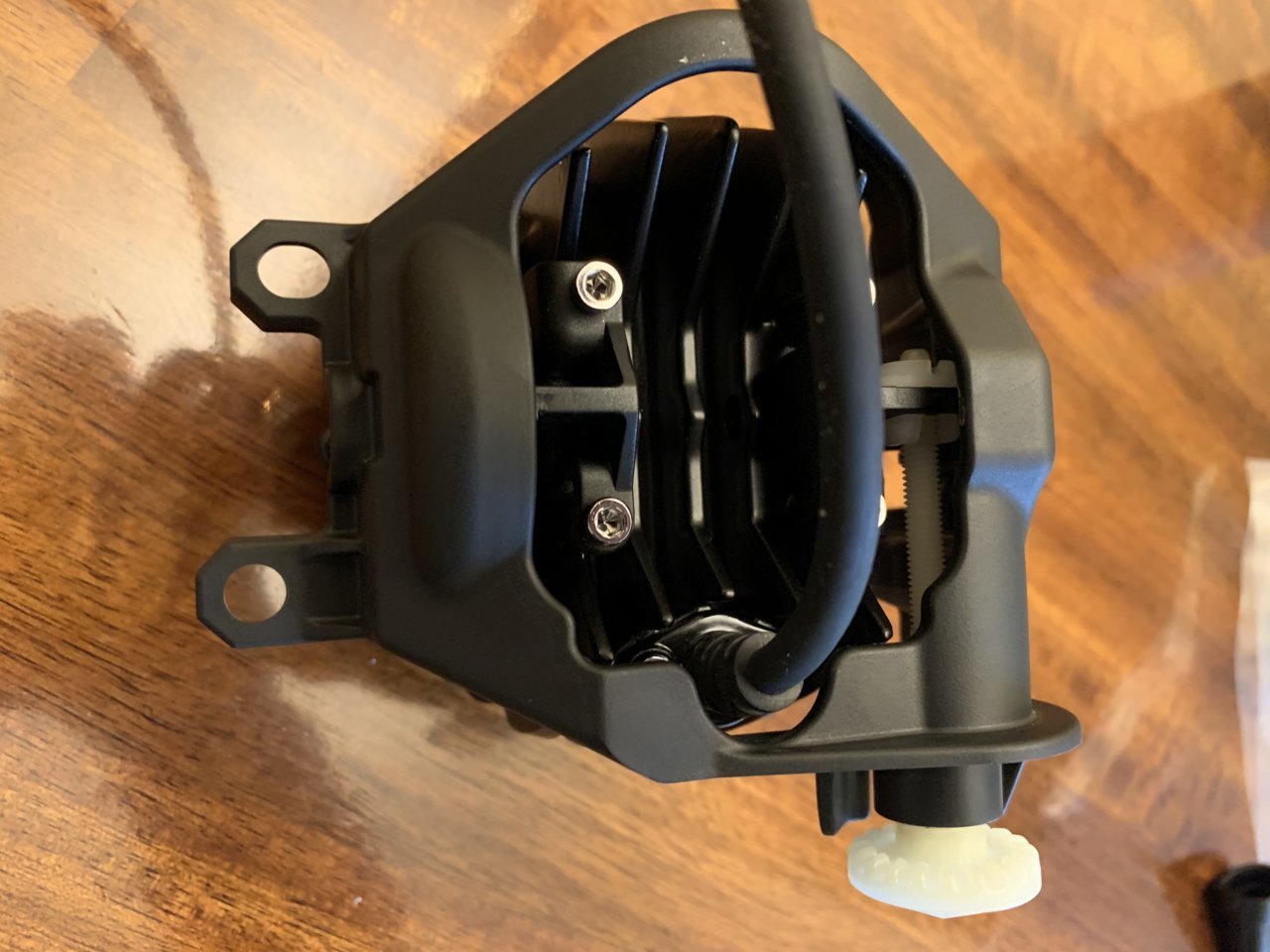

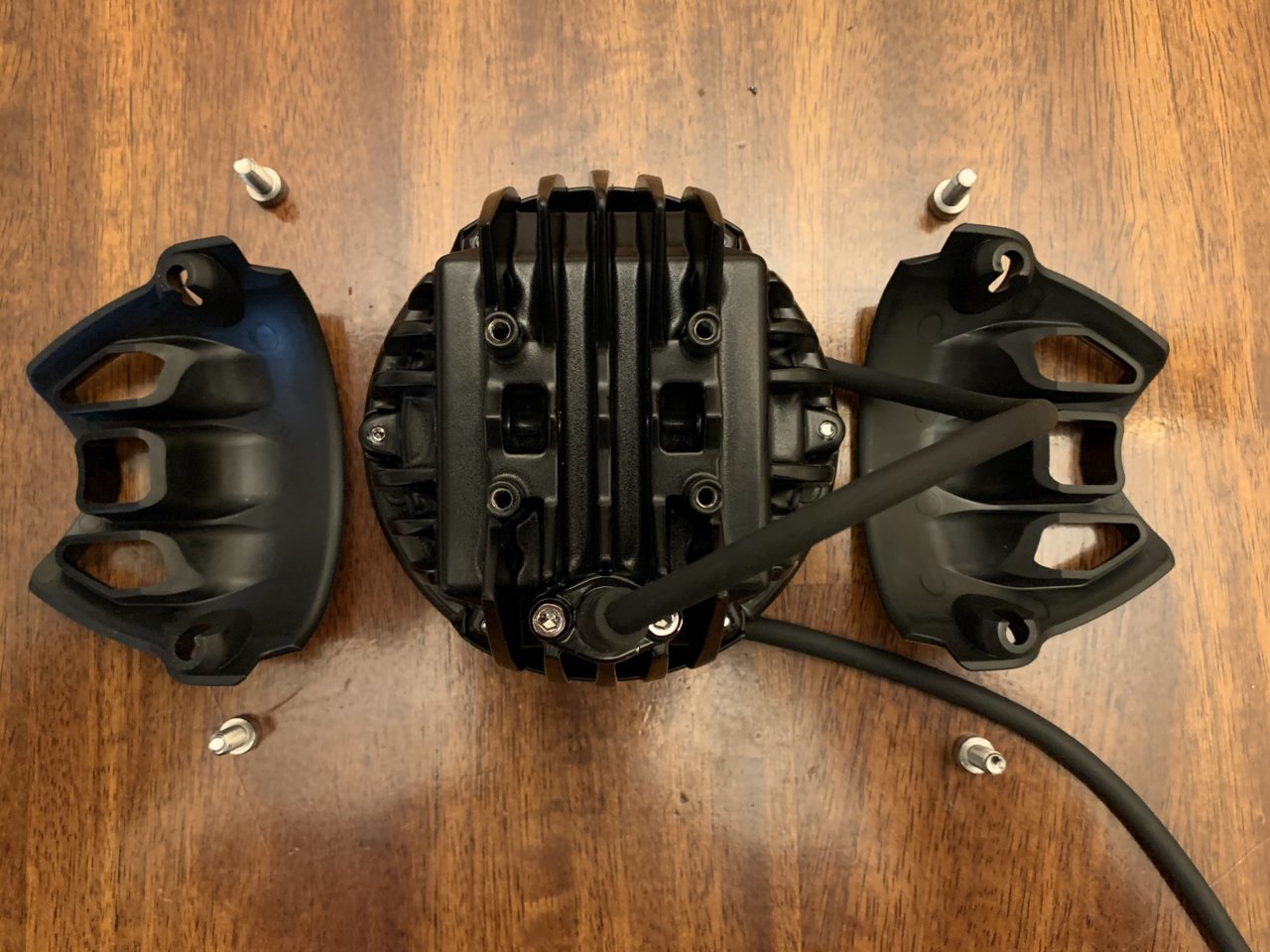

    Playing 360 transformers.

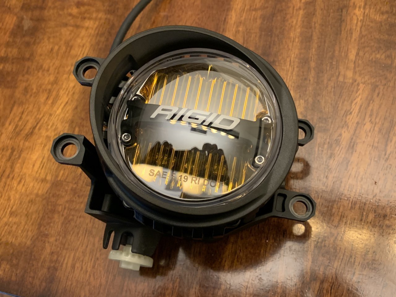

    Does it look like aiming the 360s will be easier with the new mounts?

    100x easier with OEM style threaded adjustable aiming on the mounts.

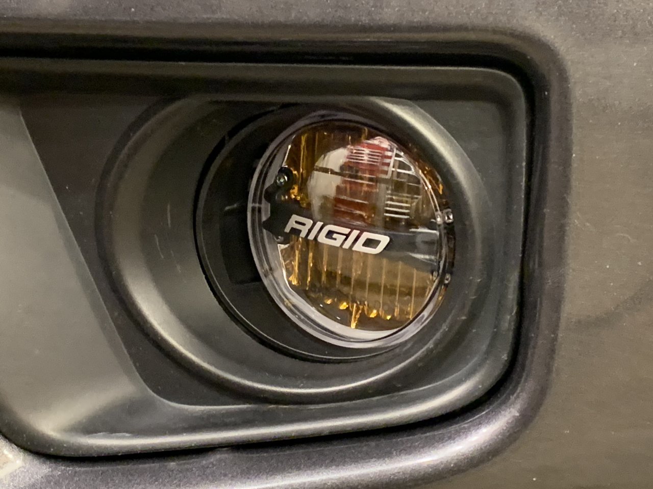

    3rd Gen mount kit installed on 2nd Gen with no modifications required.
    These things look damn good.
    There is some gapping around the light filler extension but since that is attached to the light face it needs room to allow movement for the aiming adjustment. More thorough details to come.

    Looks really good :thumbsup:.
    Now I'm debating on modifying my mounts or just doing a 2.5 gen swap. Damn it.

    Compared to the Rago mounts which are angled to the sides for flush mounting the SAE D-Series pods, the Rigid OEM mounts are true forward facing. This means more light intensity in front of the truck, and with the wide 360 throw there will be plenty of center pattern overlap increasing the forward intensity. Since the 360s have a wider pattern the shoulder should still be illuminated to a similar angle as the side pointing D-series in the Rago mounts, though to a lower intensity.
    Looking forward to nightfall to get some comparison output shots.

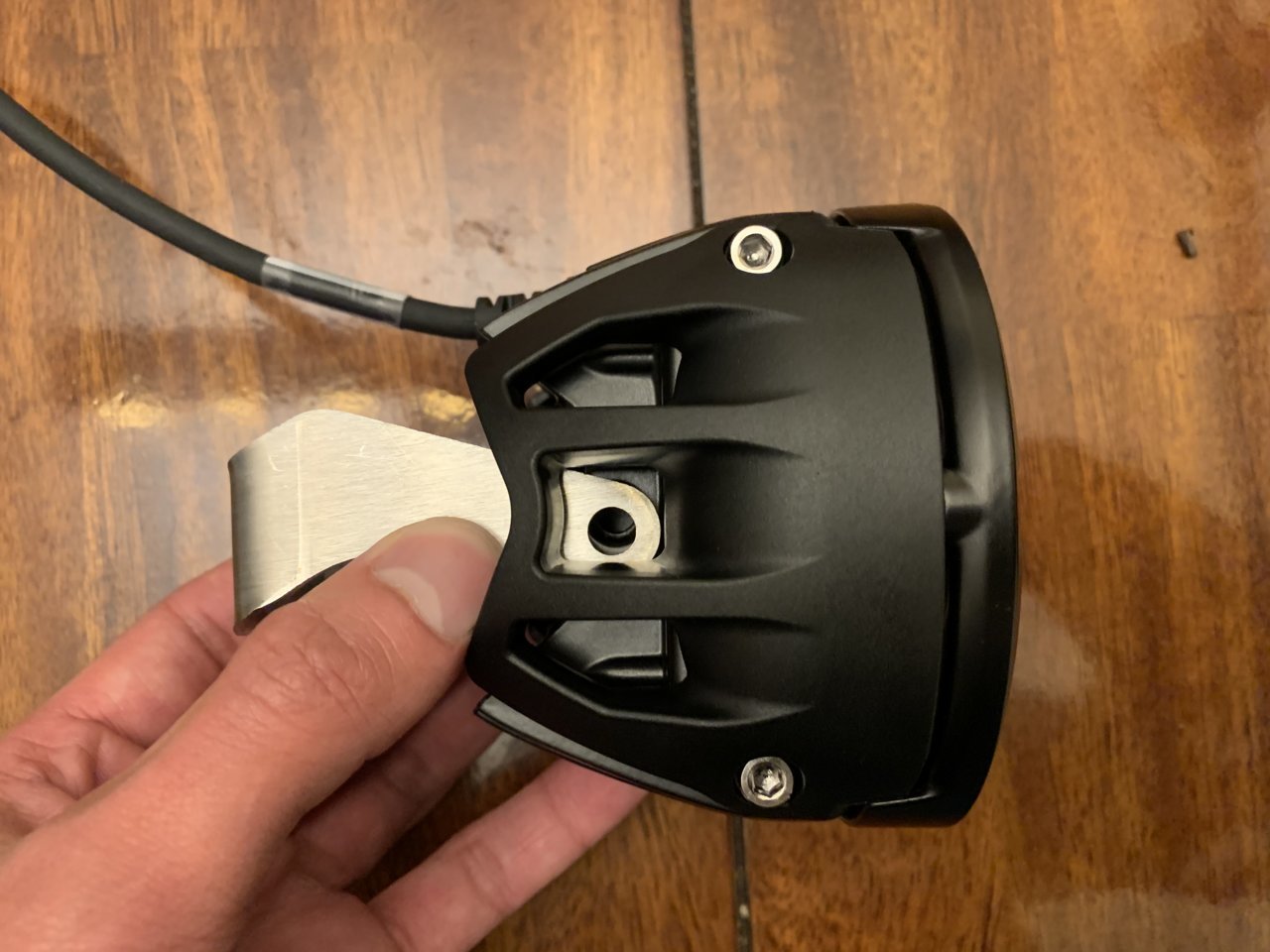

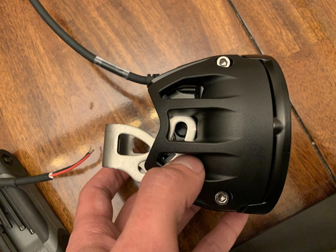

    As far as the included mounts for the 360s, can the bracket go straight back? The way the D series mounts in the RI mount for my 13 F150 the bracket on the D series goes straight back to the mount. I have yet to measure my fog opening but I thing they will fit, if not I'll just go with the D series one day. Thanks for the awesome work Crashnburn.

    They can but protrude further.
    You might be able to use the D-series mount, you may have to grind the leading edge for bolt clearance. The D-series mount is wider, you’d also need washers to accommodate the extra mount width.
    Then there is the light size issue, going from a 3” square to a 4” round.
    The D-series are a great performing light, and the peak intensity is higher though the pattern is smaller, I’d probably just keep that setup unless you were specifically looking to get a wider pattern.
