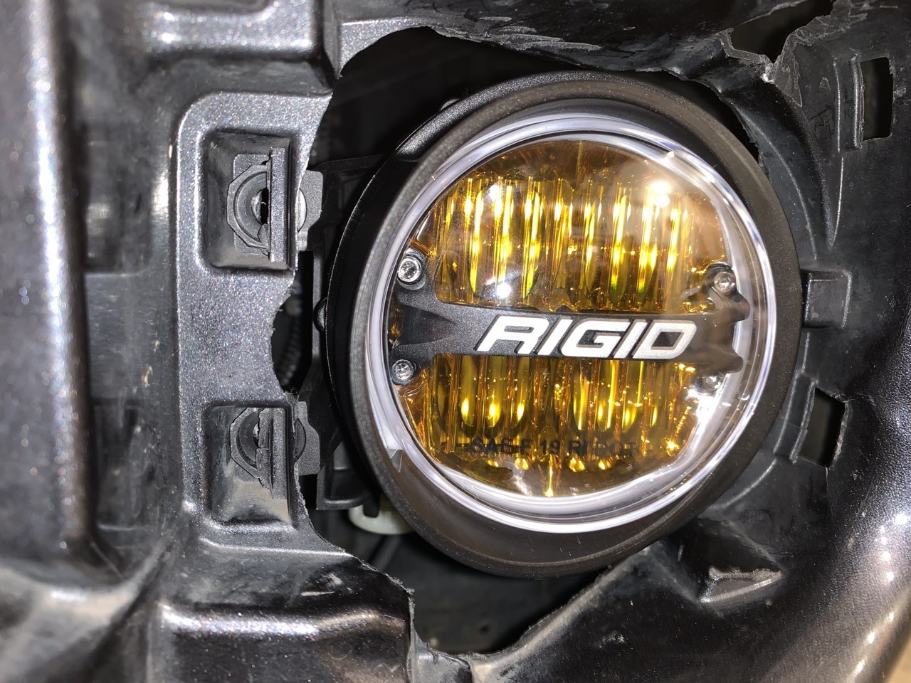

    I wasn't too keen on the bar in the middle in addition to all the bolts around the outside. But I think it looks fine once it's in the Tacoma fog light pocket.

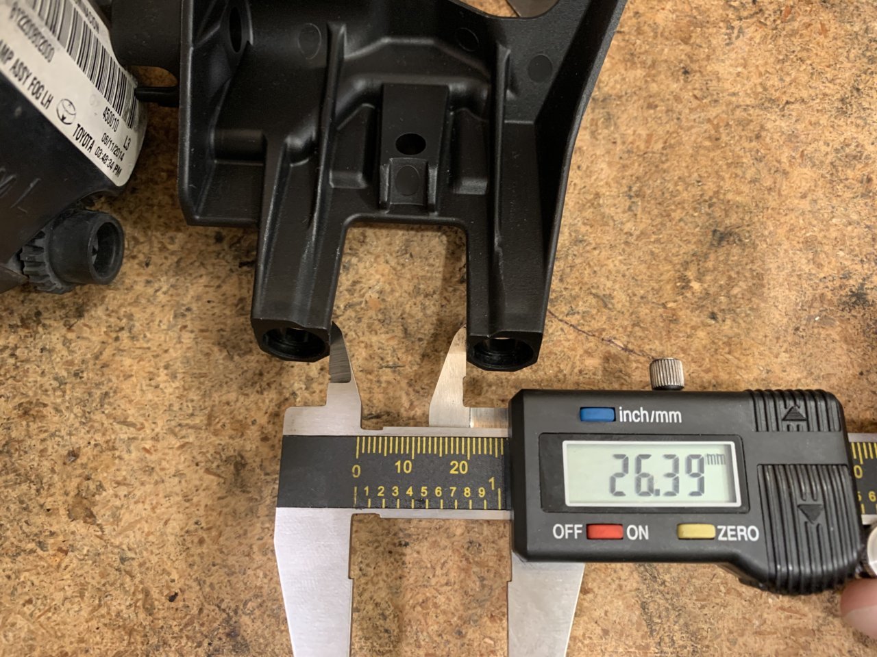

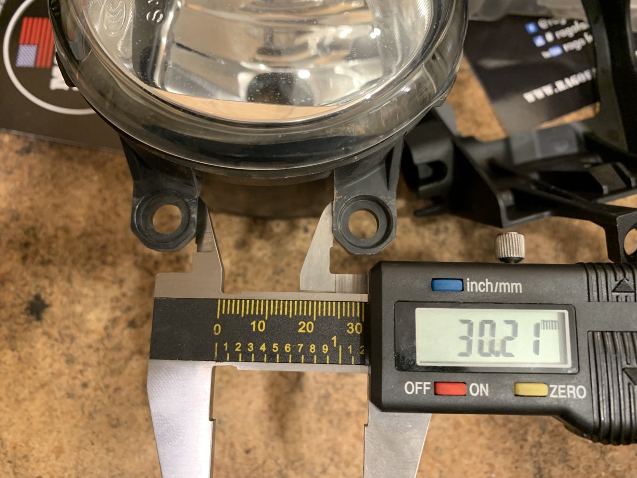

    Here is the cause of the tilt issue when installed on a 2nd Gen. The tabs are too close together for the 2nd Gen mount and while things flex to fit, it makes the light not sit level.
    Measuring the OEM mount spacing.
    Measuring the Rigid mount spacing.
    Approximately 4mm needs to come off the mount. Question is, is that ~4mm off one tab, or split between both tabs...
