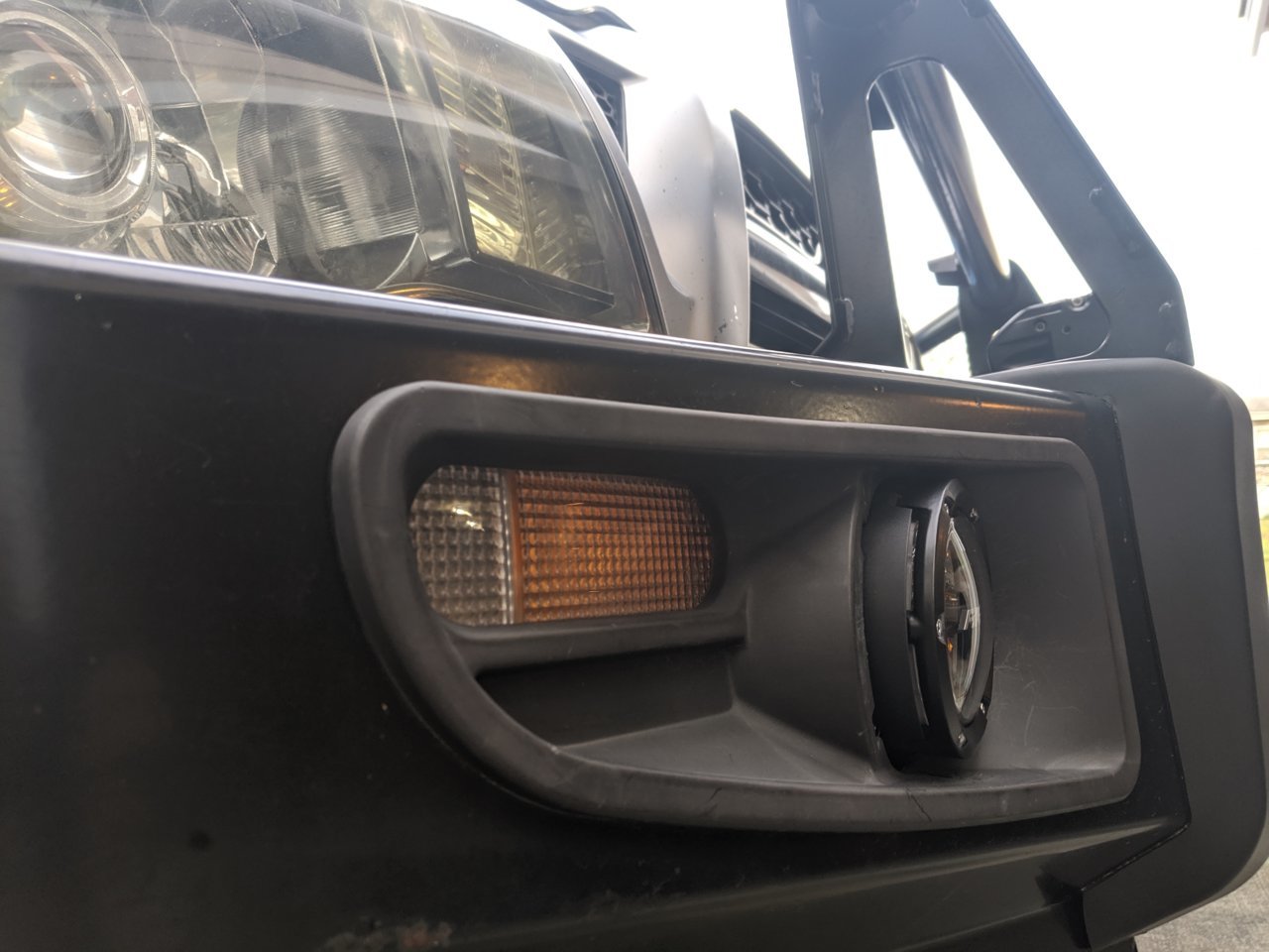

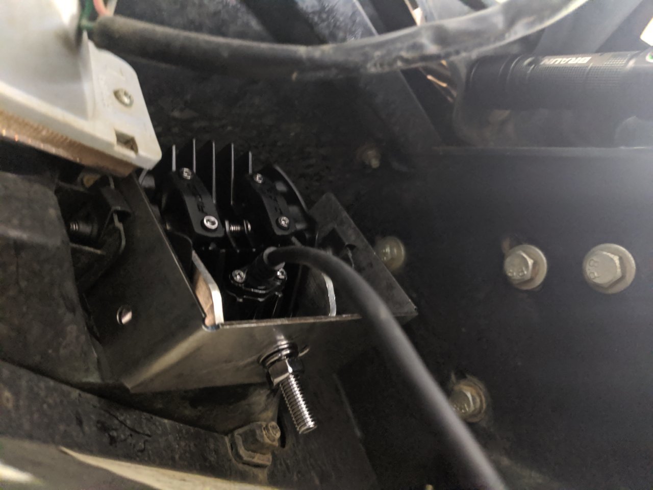

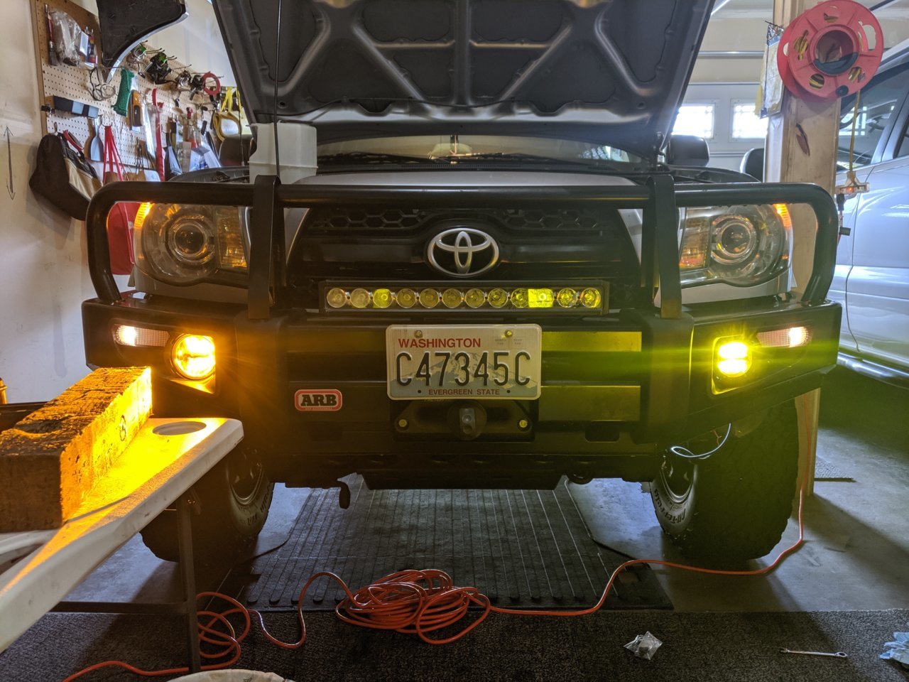

    Annnd they're installed. Paranoid Fabrications ARB mounts were used and had to be modified (extra holes added) because they are made for Baja Designs lights or other cube style lights. It is a tight fit. The ARB-adapted KC G4 Amber lights will be for sale.

    Looks sharp! Will be curious to hear your driving impressions! @paranoid56 makes some nice connectors, I have them as well and will look to be getting more.
