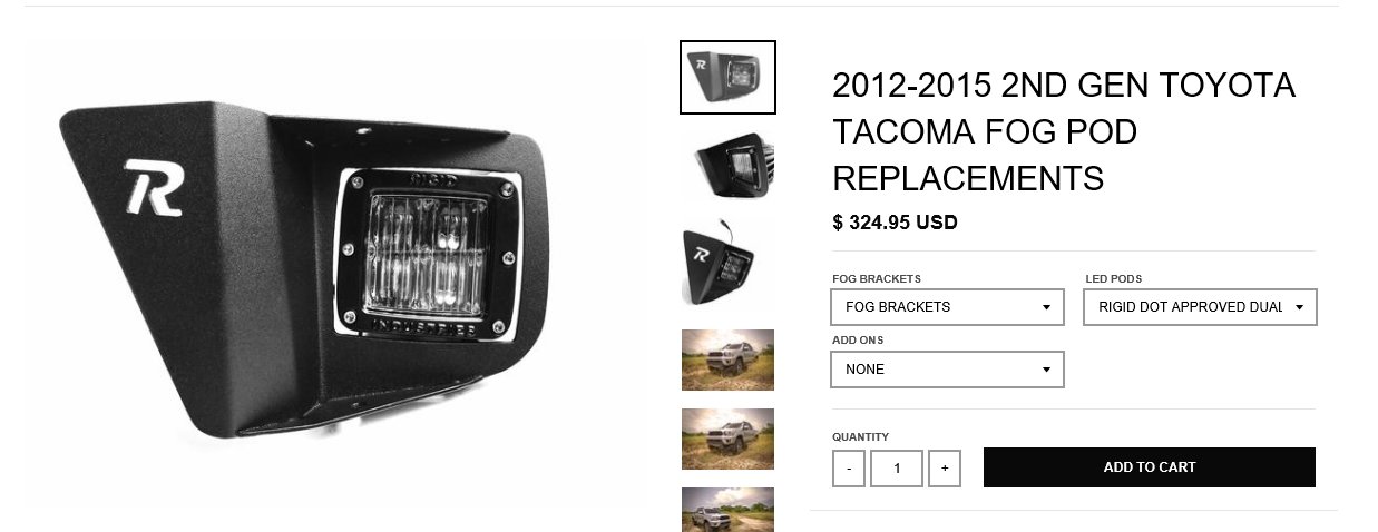

    How do these mount? I see the holes on top and bottom but are there already holes in the bumper or do you need to drill the holes? Do they use self tapping screws or bolts/nuts (I'm guessing bolts/nuts)?

    You need to drill holes on top and bottom. They use a nut and bolt. I found them difficult to get seated just right to aim and slightly oversized my holes with washers on the back side to give me more adjustability. If you put the stock cover plate on, the holes are covered. Here is the install video:

    Heads up, I ordered a set. Their website said two weeks for delivery/lead time, it took them five weeks to get me a set. Then the set they sent me had the bracket arms on the back upside down. Then replaced them at no charge but took another four weeks for them to make and ship them. Got them Felt like the fit was poor and not super factory looking like I wanted. Ended up returning them.

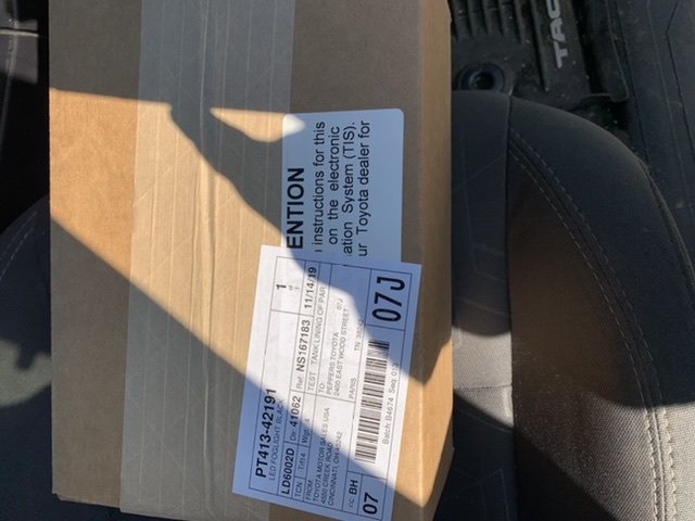

    Feel like a kid in candy store! Pair was $130 shipped to dealer.. thanks to @crashnburn80 for the detailed unbiased review my choice was made easily
