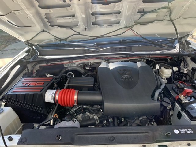

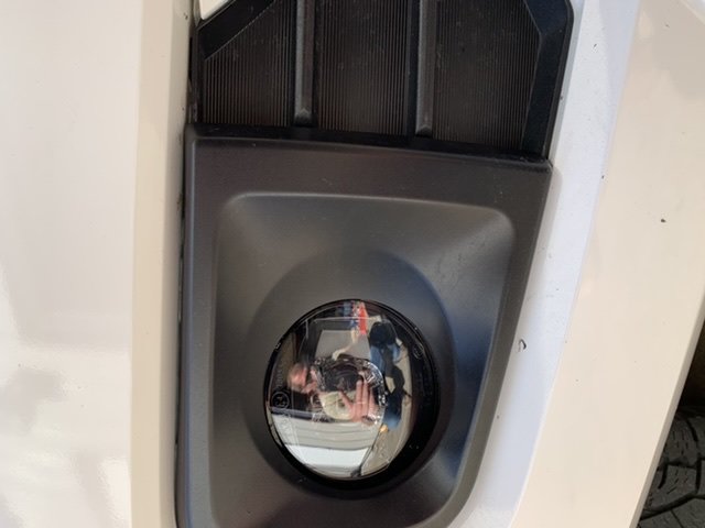

    C2B97F27-82FD-4052-8475-B4F7B706ACAD.jpg For ppl like the next poster @2006KJ who didn’t know they existed. Btw I did this today too @Bubbles... u still sitting on yours?401614F6-57B8-41FE-947E-1165716BBA02.jpg 401614F6-57B8-41FE-947E-1165716BBA02.jpg

    Who did this wiring job? I just wanna talk.

    Lol I did. The wiring up In the back toward cab is my noco maintainer/charger wire. As for the rest along the hood it’s cable tied to the wires that were factory clipped to the under part of the hood. Others hanging are to my ditch lights and they’re flex wrapped in the spots they make contact with actual hood. What else ya got? Talk

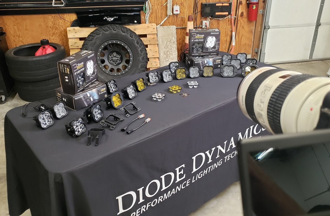

    They look pretty cool too, if a little derivative of the BD design. In addition to spot and flood for offroad use, they also have driving and fog patterns. According to their social media they will also have OEM application mounts for popular platforms at release.
    Very interested to see these shake out.
    Crash, on the off chance you peered inside the Rigid 360 lamps- how many chips do they have?
    72875730_10162832322655604_8232577885450_cf3afcc2208f1b69fc1bd6b9388bc3980fabe87f.jpg

    Spoke with them a couple months ago on these lights, they will have a Tacoma mount for the OEM location!

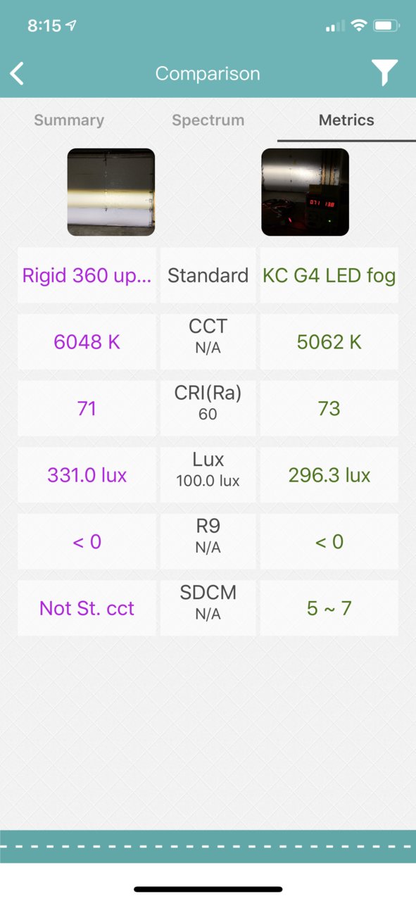

    Both have reversible mounts to mount from the top. Rigid 360s are a little brighter on top as measured at 18’ with a slightly wider pattern, but the KCs are not far behind and have a better (lower) color temp with a more uniform pattern. The 360s use different top and bottom intensity LEDs, so while the 360 upper pattern is a little brighter, the lower pattern is not as bright.
