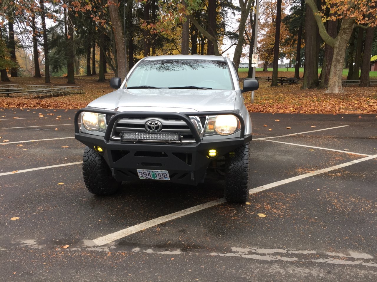

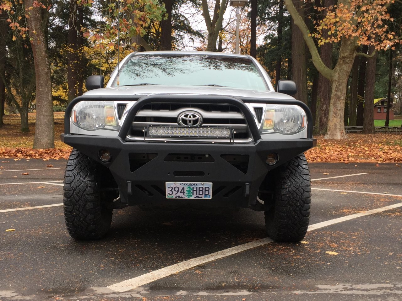

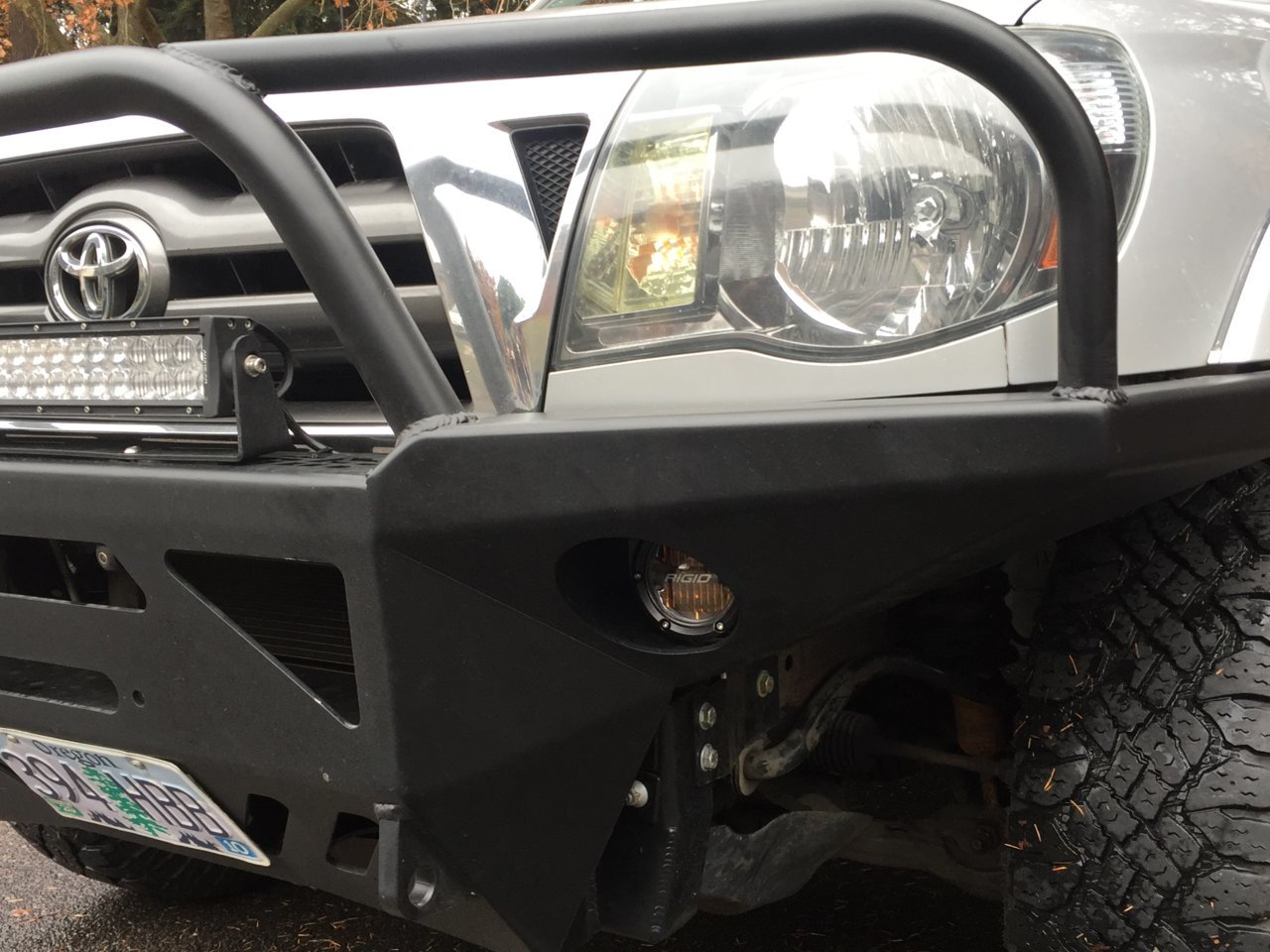

    Got my 360s mounted up about a week ago but had a wheel bearing go out the same week so was too busy with that to post pics.
    They fit great in my CBI Moab 2.0 - much better than the stock fogs. Output is nuts and I couldn’t be happier with them. I was alittle nervous I’d be wasting light with how deep set they are in my bumper but it actually worked out great. I aimed them out to the sides so they overlap about a lane’s width in front of me and have a TON of side lighting.
