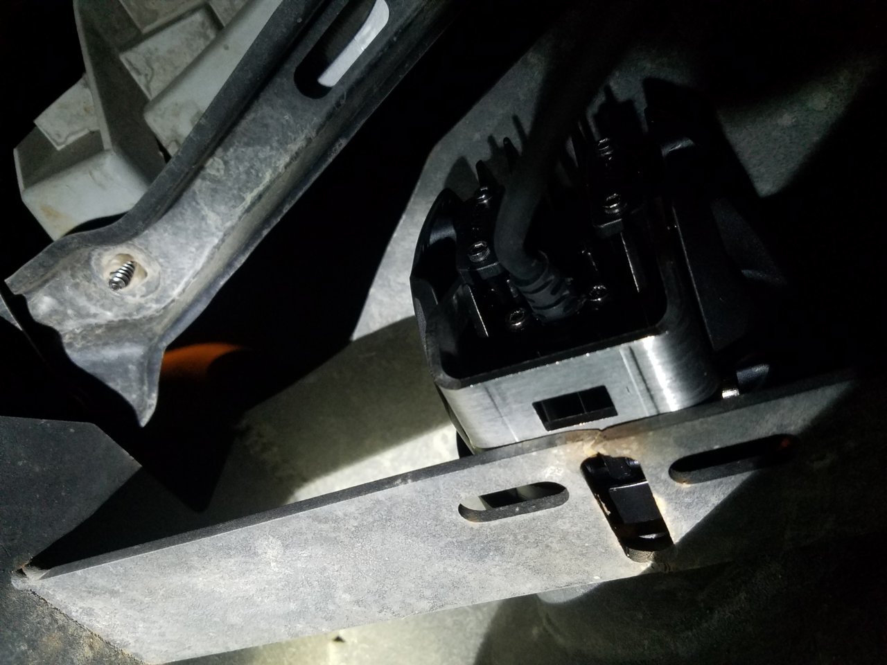

    Bad news....
    The angle of the mounting brackets on the 360 lights and the close proximity of the mounting point on the Demello bumper will require some sort of modifications to said bumper to allow for mounting of lights.....:help:

    Could you post pics of the issue?

    The issue more with the depth of the bracket not the height..
    This pic shows the 360 tight to the opening and the mounting bracket on extends out past the bumper mounting point.

    The bracket is angled IIRC, did you try reversing it to see about angling it forward vs back? I don't think it will buy enough distance though.

    I would just make a new custom bracket for the fogs. No need to mod the bumper

    Yes. This pic was taken with the angled bracket facing forward, if flipped the other way, it would further exacerbate the problem.
    Here is a shot of how the bracket is mounted:20191120_190330.jpg

    Will have to look into this option. Know anyone with the capabilities?

    how much room do you have without the bracket?

    @JimSnell has done a bunch of work for local members.
