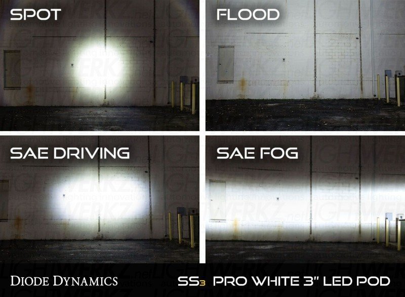

    That's awesome! Ya, I'm excited to see the results. I'm curious to see if the Pro models have to be aimed down significantly lower as the cut off line is quite a but "fuzzier" compared to the sharp cut off line produced by the sport series. I was told by DD that the sport series have substantially smaller chips then the Pro models and therefore have a tighter controlled beam to them. Do you have any thoughts on this? (No worries if you want to let your testing data form your opinion).
    I really like that they are using 4000k chips in their selective yellow and I'm curious if you could later swap out the yellow lens for a clear one and have a 4000k fog. Do you prefer selective yellow fog lights over white ones?

    Keep in mind your fog cut off horizon line should be well below your headlight cut off horizon, so while the Pros have softer cut offs you shouldn’t need to aim them down because of it. Correct that the Sports use smaller emitters for enhanced focus, the concept is not new. Headlight bulb manufactures have been doing this for decades with +xxx style stock wattage performance halogen bulbs, which use smaller filaments to enhance focus to drive higher intensity output without using a brighter light source. However in an LED pod, I believe DD’s TIR optics are uniquely positioned to make better and more effective use of a smaller emitter than traditional forward facing LED designs, because of their design emphasis on focus.
    It does sound like you can swap lenses, meaning it would be possible to get a selective yellow light and swap a clear lens for 4000k output, I also had that thought. However you wouldn’t want to get a white version and swap a yellow lens as the color would likely result in something more green hued than the ideal yellow.
    Personally I prefer selective yellow. Fogs should really only be used in poor weather conditions that call for them, and in those conditions I find I like the selective yellow better, especially over the higher color temp LED white options.

    Thanks for the info! And yes, I always aim my fogs 4" lower than mounting height at 25'(so quite a bit lower than low beams). In this case would you aim the pro model at the more crisp part of the cut off and not the very top of the beam then? As the soft light bleed would still be lower than the low beams I would think.
    I also use my fog lights in inclement weather and heavy fog, I just haven't had much experience with yellow fogs. I do realize that the warmer light doesnt reflect off of water particles as much and should do better in theory than a cool white with a slight hint of blue and also less fatiguing. Thanks for your expertise!

    Just to step in quickly to answer this: We would want to follow the aiming recommended by the SAE standards, which is based on the "maximum gradient" of the pattern - which itself is derived from a logarithmic equation to determine where the sharpest "step" is in the pattern. With this in mind, our Sport should technically be aimed 5 degrees down, and the Pro should be aimed 6 degrees down. That is degrees down from directly forward, not down from the max gradient at parallel. Essentially, if you center the pattern completely forward so it's dead center vertically, then aim it either 5 or 6 degrees down from that.
    That's a long way of saying yes, you are right. The Pro should be aimed one degree lower than the Sport. However, this is more of a function of the height of the beam pattern. The Pro isn't too much fuzzier (gradient values are nearly identical), it's just a taller pattern overall. I think that appearance is moreso a result of how much brighter it is than the Sport in the photos.

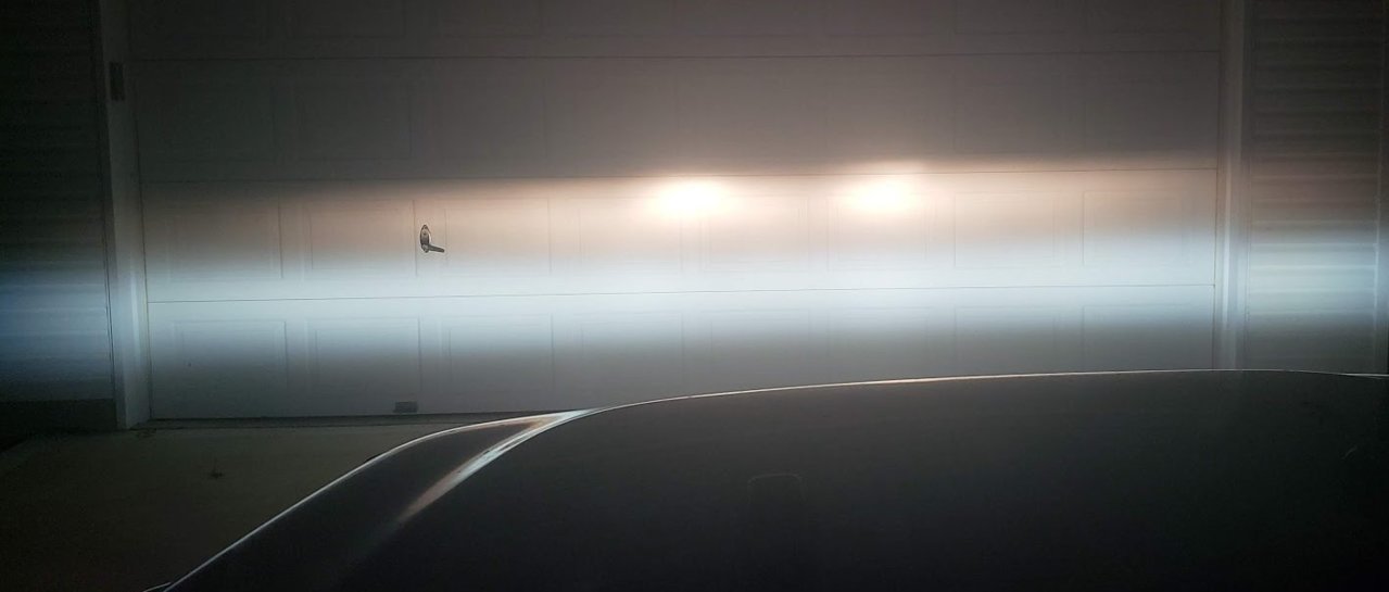

    Here is a very unscientific snapshot of my halogen Jeep JL headlamps with Pro SAE fog installed. I'm very close to the wall here, but as you can see, there's still an extremely distinct cutoff that falls below the low beam. I really need to swap my LED headlights back in...
    And yes, as crashnburn80 said, 4000K LEDs on the yellow. Some of our more "conservative" staff are planning to make their own 4000K white lights, but I really don't think we plan to offer them off-the-shelf like that. No problem if that's something you want to assemble yourself though! (Or heck, buy your own LEDs and a hot air gun and make whatever color you want!)
    Paul

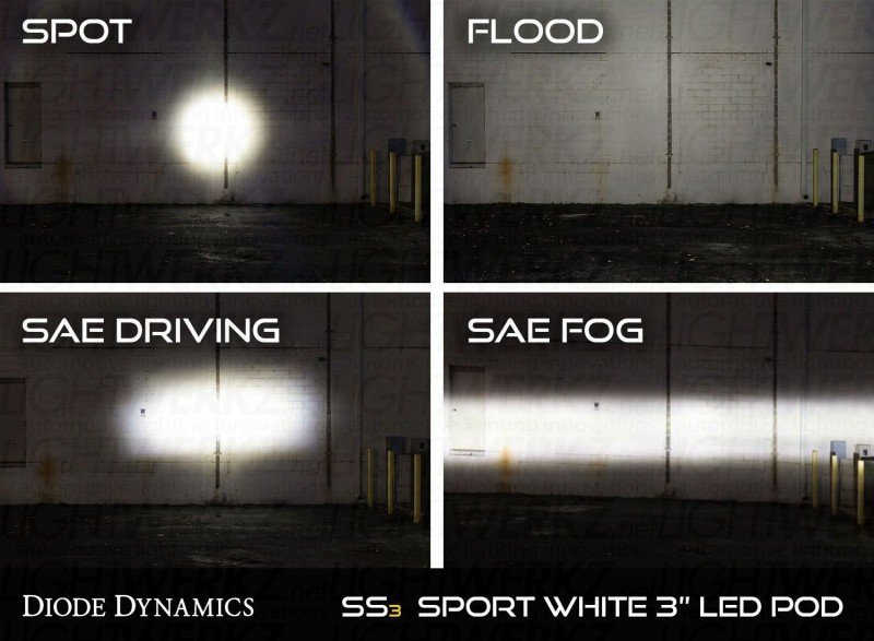

    I haven't tested the Diode Dynamics lights yet, but I think you can make an educated decision on what is best for your use case based on a few points like pattern and intensity.
    1) Bajas have the tallest pattern by far and are designed to maximize uplight to the legal limit, but because of this the light intensity is relatively low, only half that of a more focused light like the Rigid D-series. Maximum uplight is also not what you want in fog but will provide a more evenly blended widely distributed area of light which will blend nicely with the headlights, once they have updated their optics.
    2) Diode Dynamics lights have a more traditional fog pattern, narrower than Baja, and with their TIR optics emphasis on focus they should have much higher intensity levels than Baja and possibly even Rigid, placing that higher intensity light focused to where you need it poor weather conditions like fog.
    Personally I prefer higher intensity focused output over larger area coverage and lower intensity output, but that is my personal preference. I look forward to having the data to make a more quantitative comparison.
