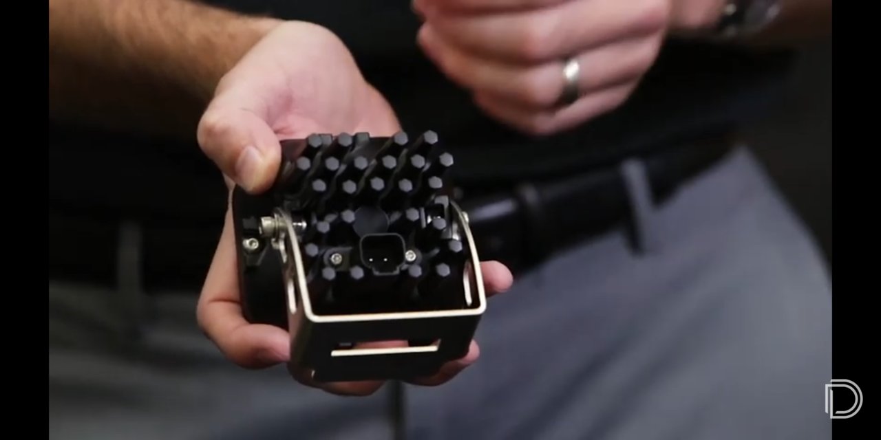

    @Diode Dynamics are these SS3 pods IP67 rated like it says on your website? Or are they IP68 rated like your SS light bars?

    I think it's likely rated to IP67 due to the integrated Deutsch connector on the rear of the light. From a bit of research, Deutsch Industrial does not publish official IP ratings, so the entire light can only be rated as high as the minimum listed ratings by Deutsch. Only a select few connectors have higher verified IP ratings and these may be expensive to procure or certify.
    I'm guessing to keep costs down DD went with standard connections. If your fog light is 3 feet under water for half an hour, you have bigger problems anyway. Personally I think it's a great idea to clean up wiring and minimize connections.

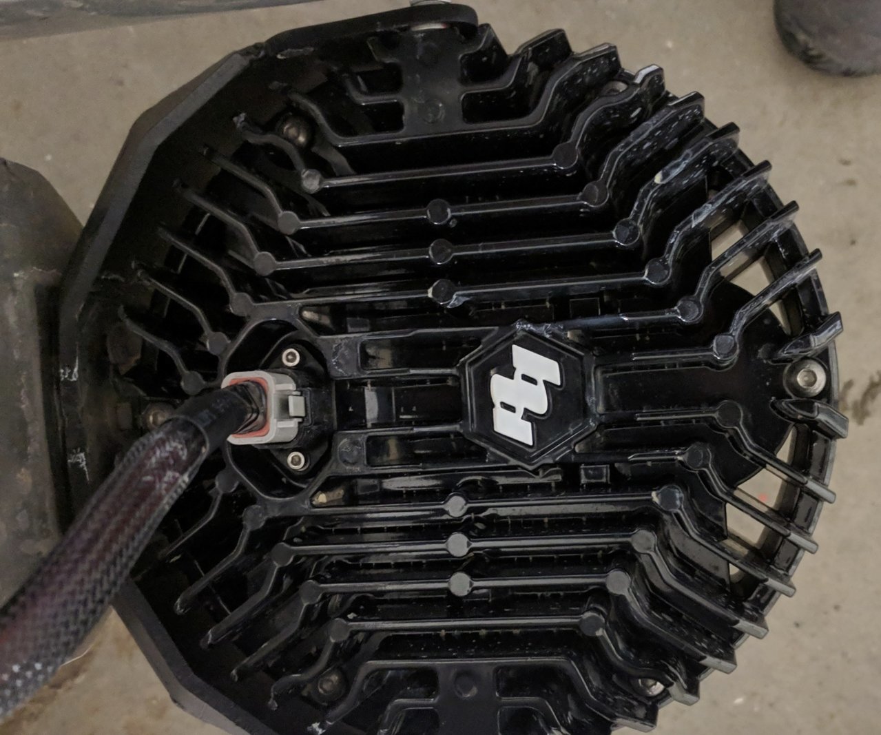

    They definitely might just be IP-67. The Baja Designs LP6 and LP9's have an integrated 4 pin deutsch connector and are rated to IP-69K. Here's a picture of the back of an LP9 I installed for a friend. And I agree about the fact that if you have them submerged you have bigger problems. I do like pressure washing with hot water though and that's where IP-69K is nice to have.

    We simply haven't tested to anything beyond IP67, which we can accomplish in-house.
    Sorry to keep dumping lots of technical info but .... Normally we test our products only to SAE J575, the automotive durability standard. Factory automotive lamps do not have any IP rating. Personally, I'm not a big fan of IP ratings because it only tells you that the product can pass one test when it is brand new. OEM Design Validation Plans (DVP) based on SAE J575 are designed to cycle products through vibration, thermal cycles, and submersion/moisture, which we do here as well at a bit lower level, to better simulate real-world use.
    Anyway, the connector on our product is not a limiting factor that we know of. We actually designed that part and had it made specifically for these lamps, it is not off-the-shelf. It has a thick O-ring on it and the actual terminals are overmolded. So we do not expect any problems with it. We simply need to complete the testing necessary before we assign the higher ratings. We do not give our products any ratings unless the testing is actually completed.
    That said, if for whatever reason we don't pass IP68 or IP69 or IP69K or whatever letter you want to see, we've already passed the SAE J575 testing and our additional in-house DVP, which I believe to be far more applicable and important for a lamp in automotive applications.
