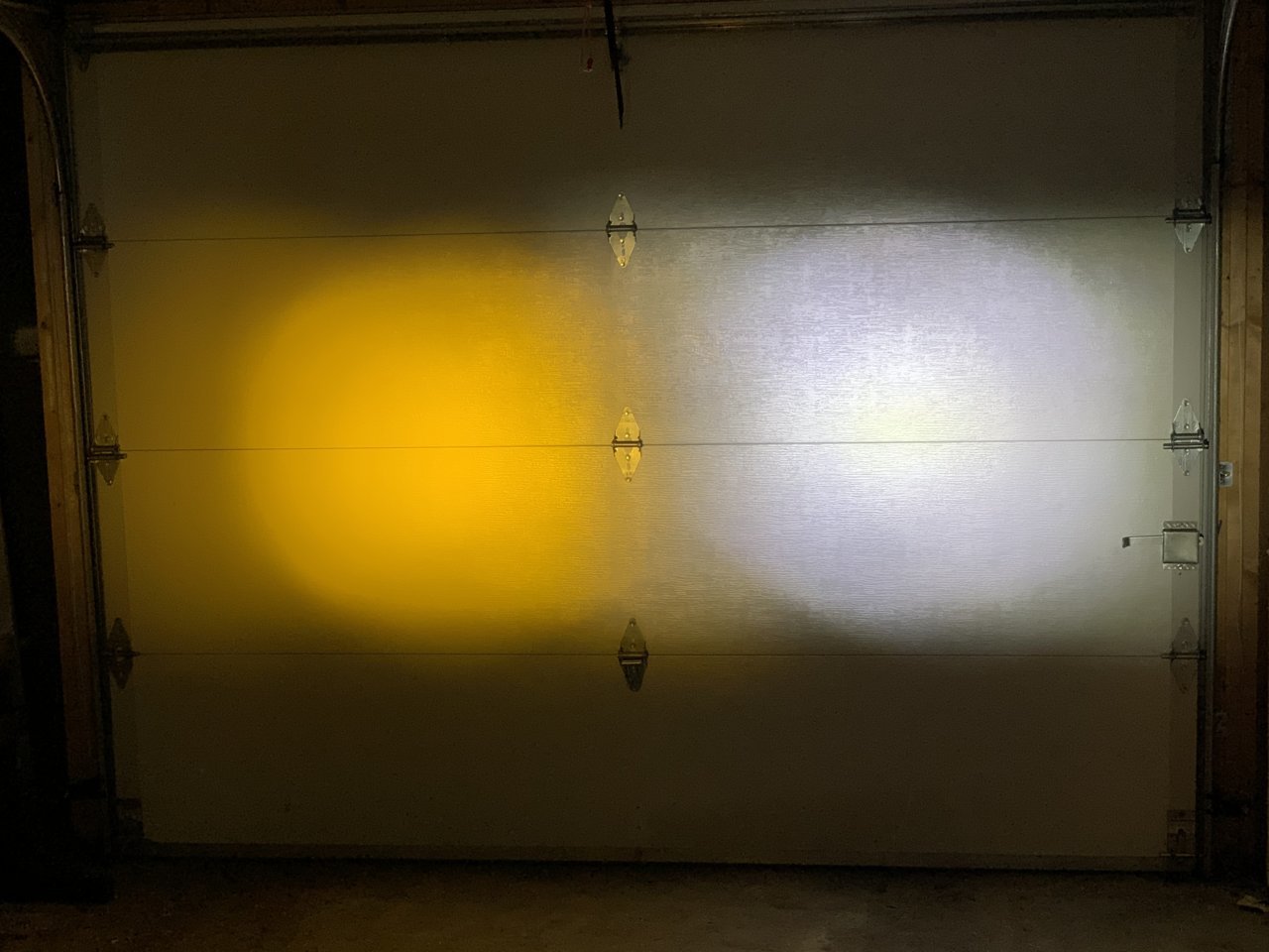

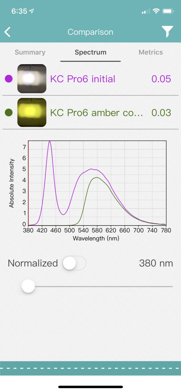

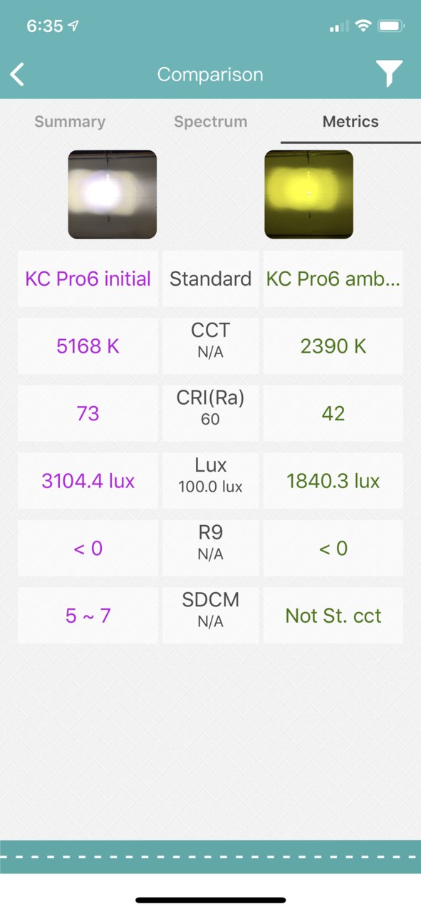

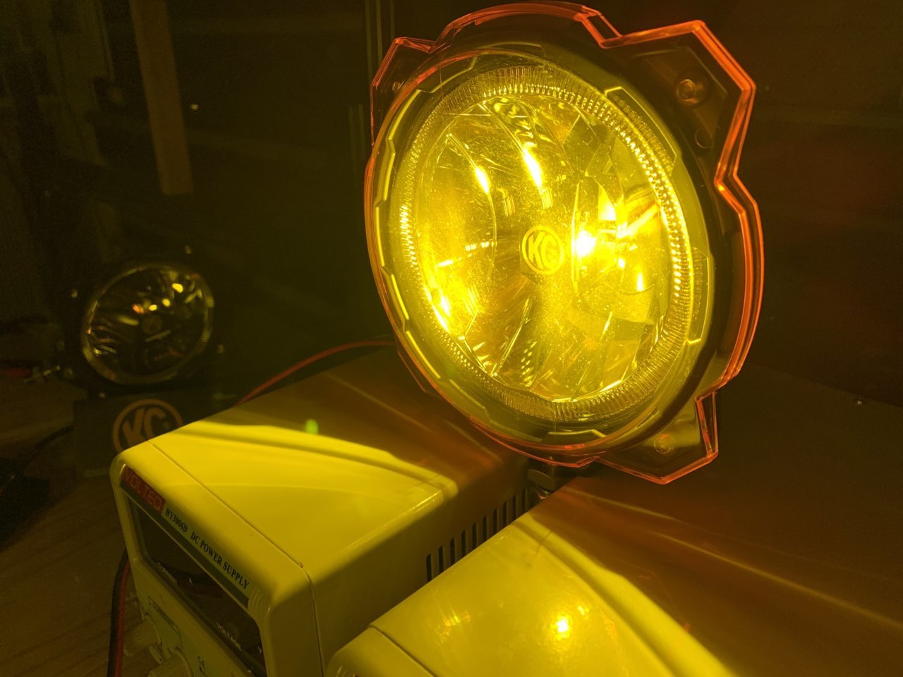

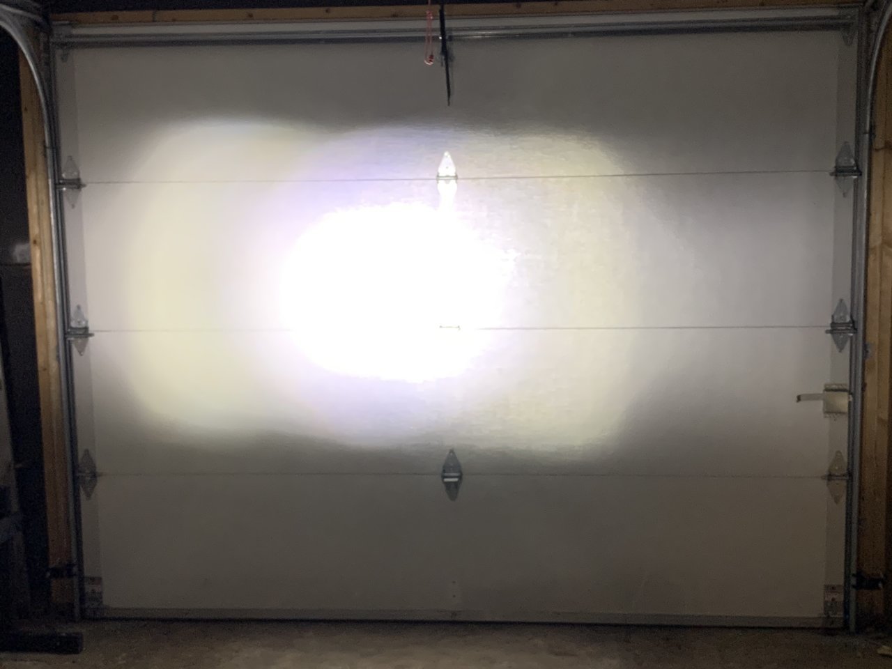

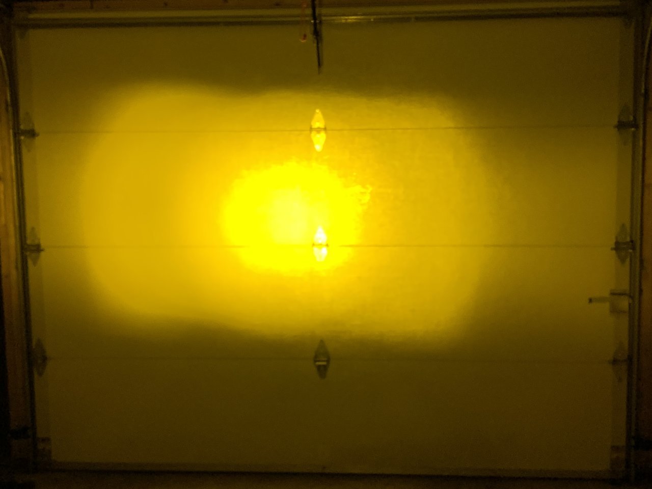

    KC Pro6 Aux SAE J581 high beam preliminary testing:
