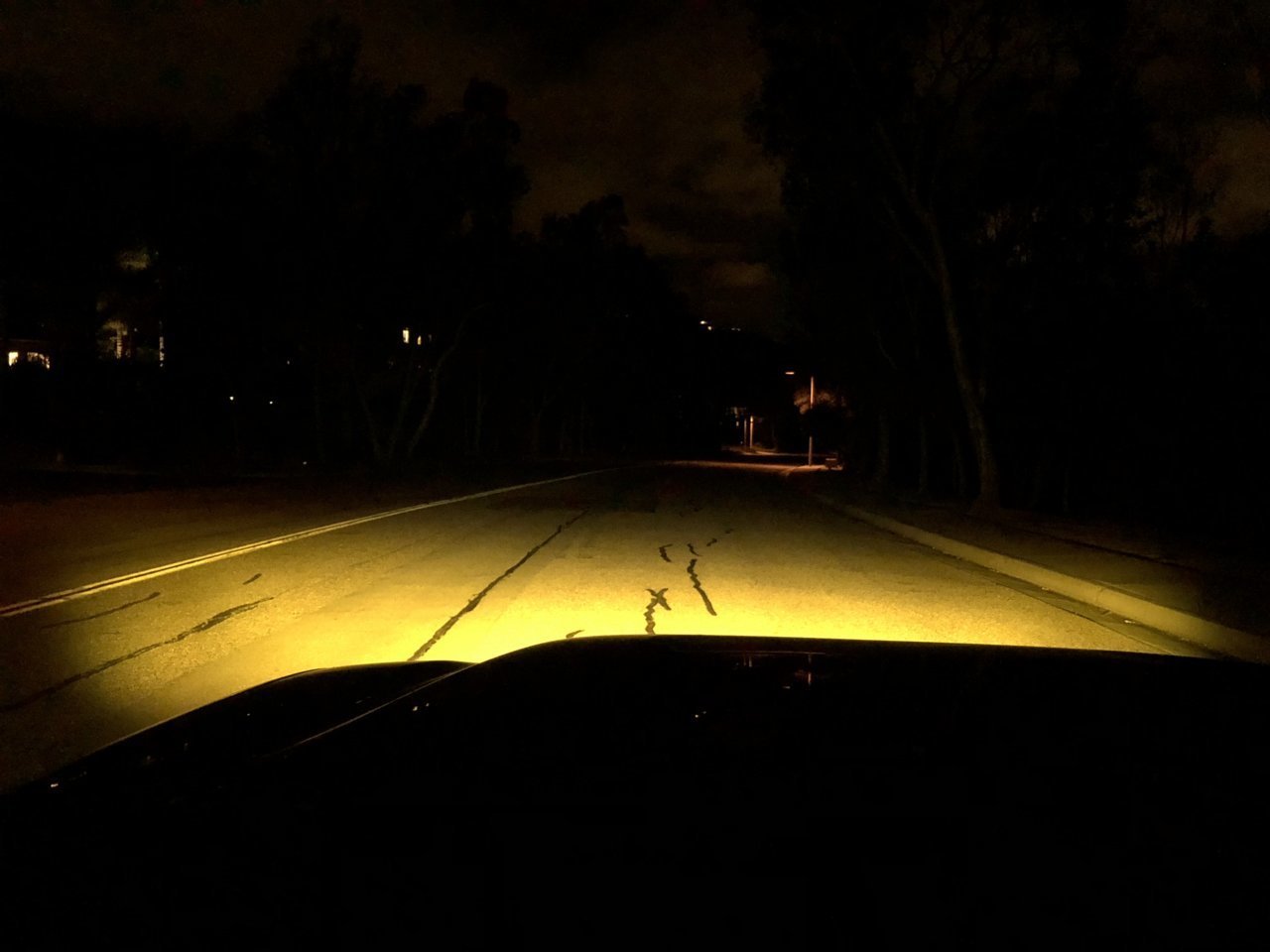

    i think the output with the amber covers looks legit. check the pic i posted
    that’s the setup i’m going to be going with. will be sending some covers to @crashnburn80 for some testing.

    My chart was just a measurement on both lights at 2 distances and a line plotted between them, I don't have any measurements at 10m to conclusively compare. Rigid claims a pretty low output loss using the covers, it really depends on how much area under the output spectrum curve is cut off by the covers to see how the overall output is affected, so every light is going to respond a bit different. While KC has relative stronger mid-spectrum output, Rigid has stronger mid-spectrum absolute output. So if the covers can remove just the blue light peak, while keeping the remaining part of the spectrum, they may be able to outperform the KCs. @Speedway Blue was going to send me some covers for a separate project soon and I'll be able to run a comparison with some more specific measurements on how output is affected and what the resulting color temperature will be.
