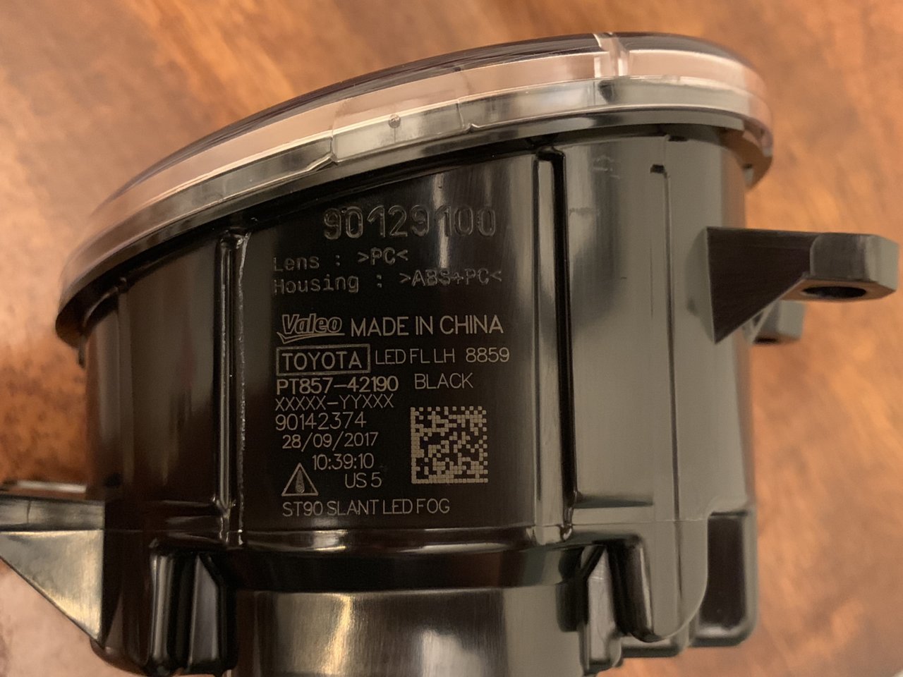

    Shared in another thread, the OEM black out Toyota LED Valeo fogs are on a Cyber Monday deal for $91:
    https://parts.toyotaofdeerfieldbeac...Black-LED-Fog-Lights/69550310/PT41342191.html
    Review post on them covered below:

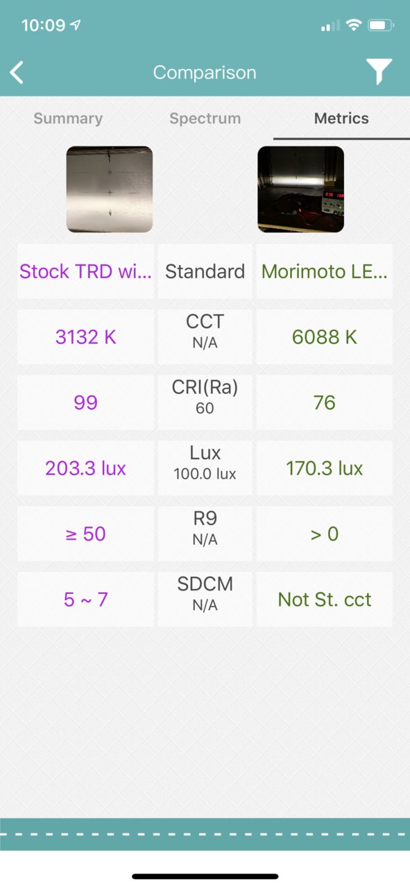

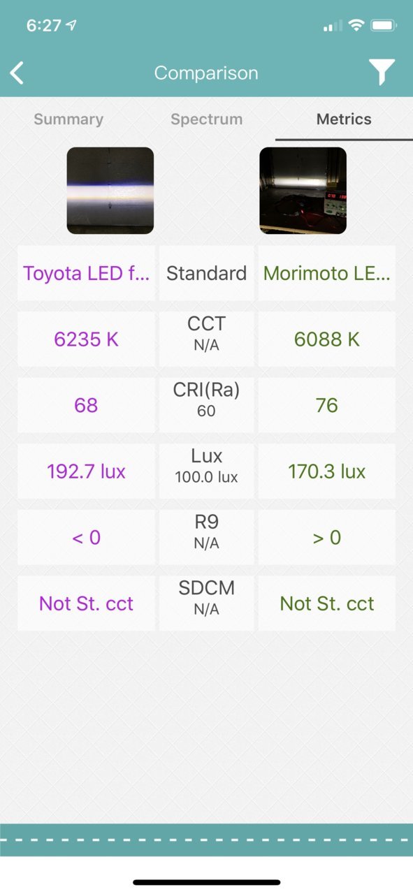

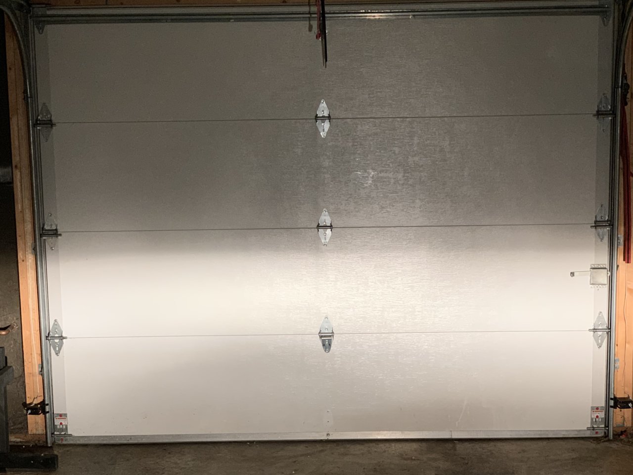

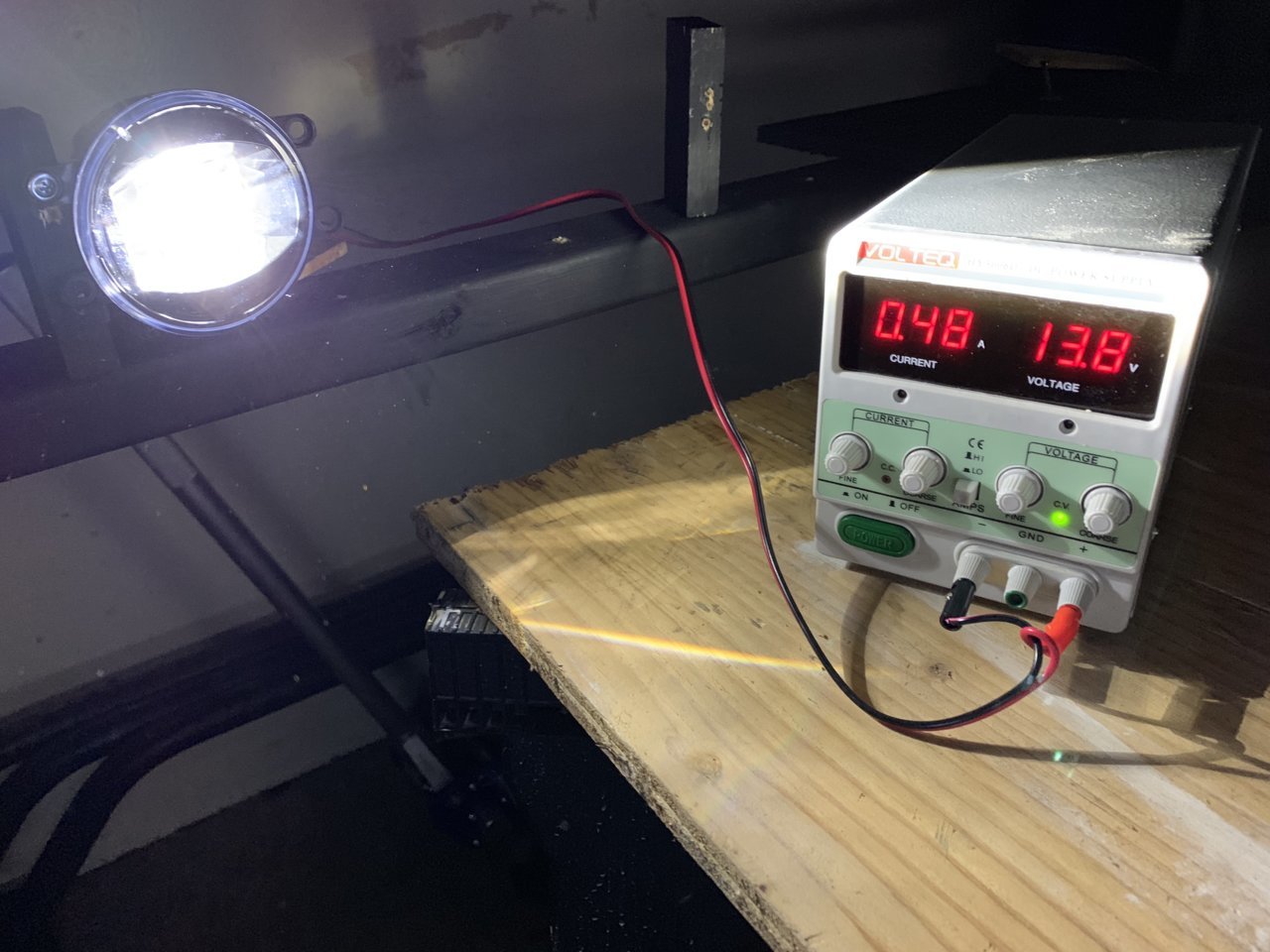

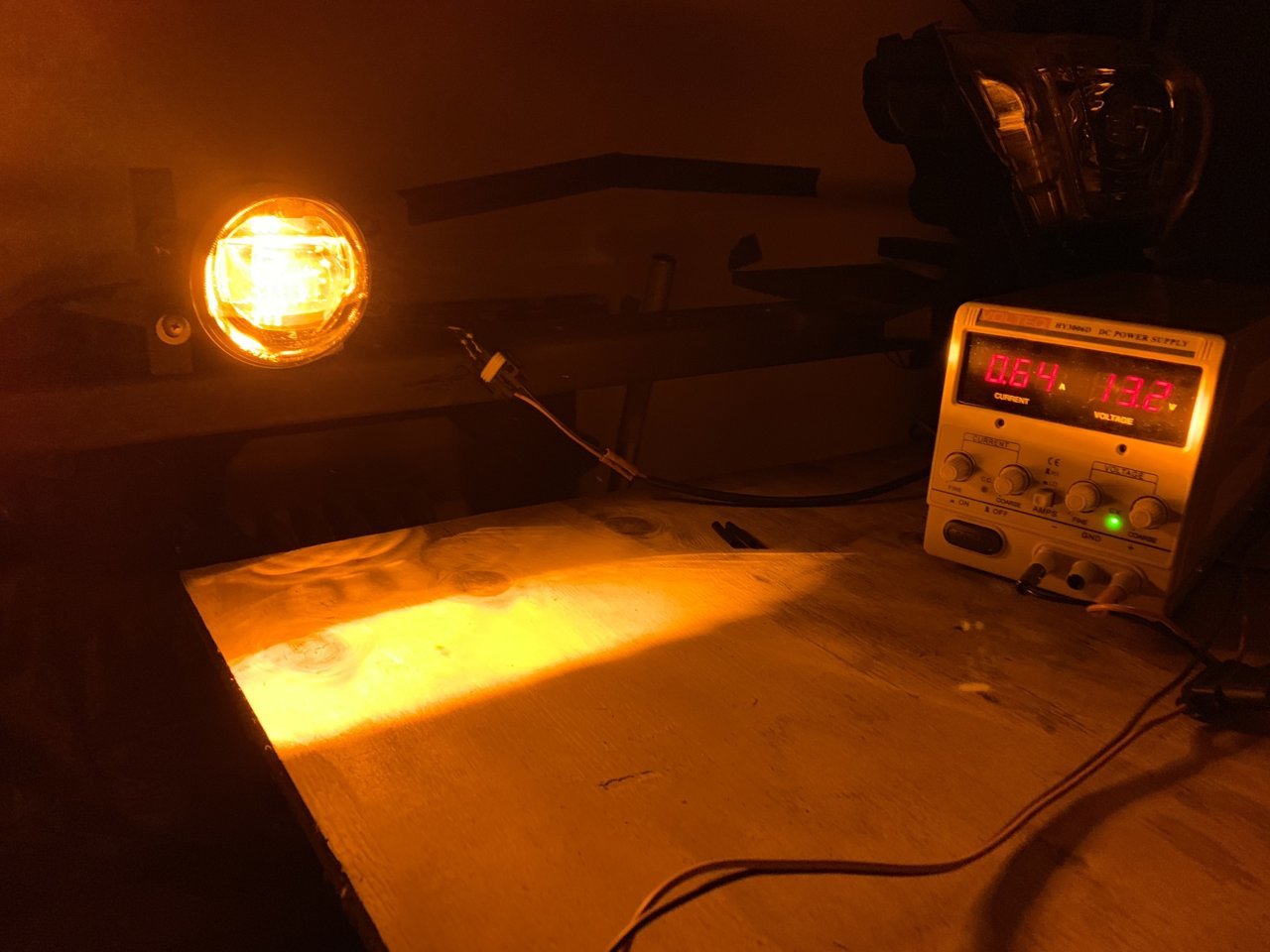

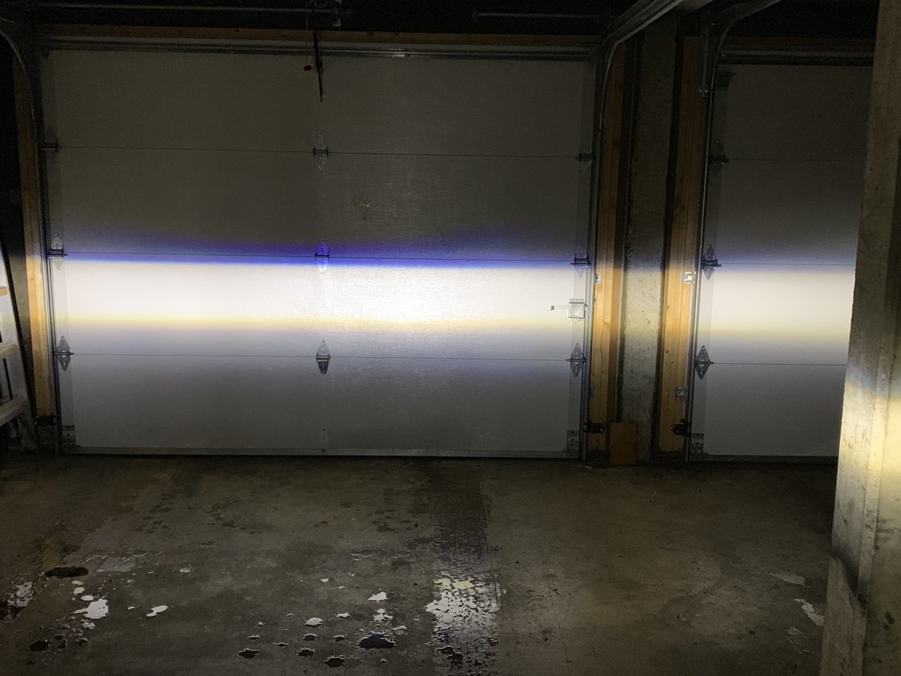

    2015 Wide-angle fogs with the stock used H11 Osram standard bulbs run at 13.8v.
    12-15 use the same wide angle optic as 16+ 3rd Gen (non-Canadian) TRD (non-Pro) trucks.
    Output testing compared to Morimoto at 18'.
    The Morimotos provide a more uniform even pattern with less uplight than the OEM units, but compared to the H11 based OEM fogs at 18' the Morimotos have less peak intensity. This is tested using a stock used standard Osram halogen bulb, a performance stock wattage halogen bulb will perform better. Trucks running the early 2nd Gen H10 fogs, or the 3rd Gen H16 fogs will have a very different comparison baseline.

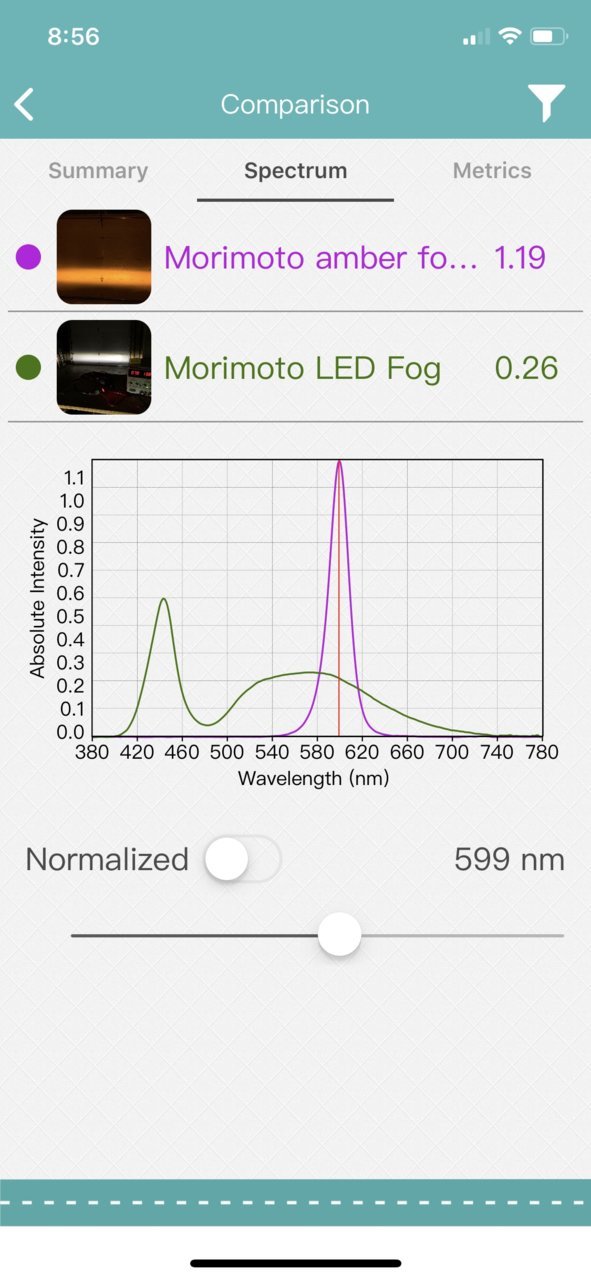

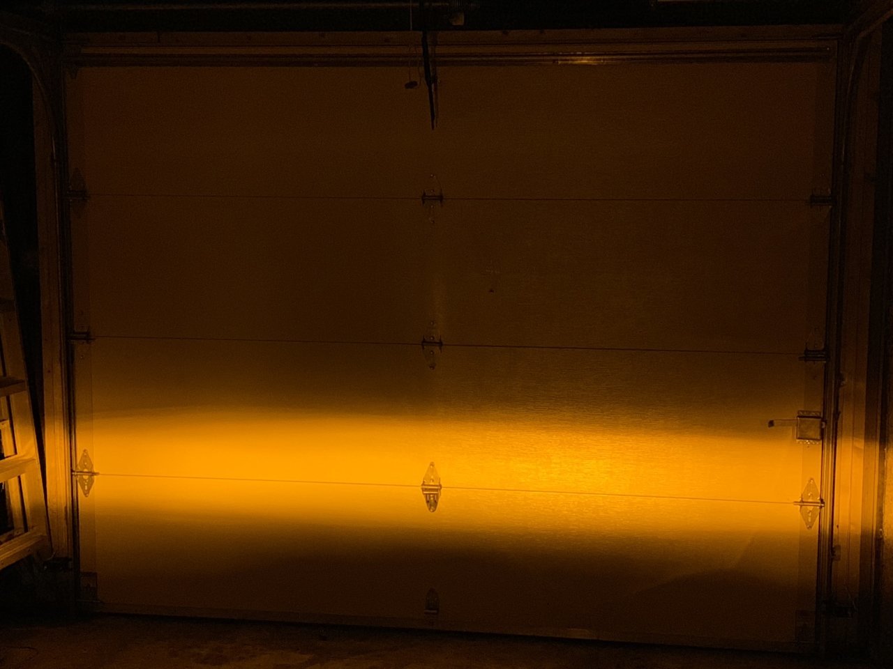

    So still an improvement based on the design of the light but actual output is less.

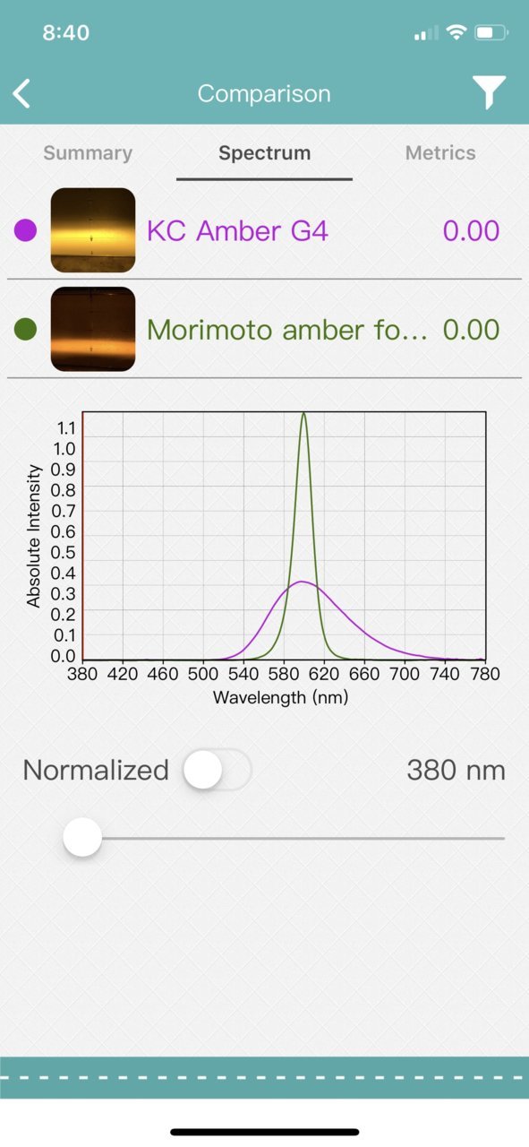

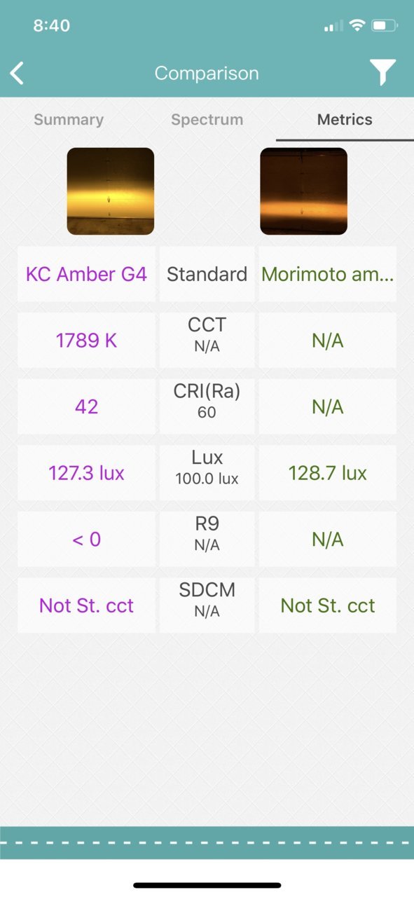

    I'm a little worried since I've got the Amber's on the way. Output is even less on the morimoto amber than the clears. Is it really beneficial at a to have the yellow/amber colors for fogs or is that personal preference? Seems the lost output is a pretty big hit.

    Fog lights are designed for poor conditions. In those conditions my eyes are much happier with the amber light rather then the previous white I had. Way less reflection back at me from fog or snow.
    Even when I turn the lights off and only use the headlights, instill preferences the overall package of the amber+ headlights.

    The improvement would be a more uniform beam intensity and sharper cut offs with less glare to oncoming traffic, the output is lower compared to the H11 TRD fog, especially for the amber version. However for amber long wavelength lower color temperature light is beneficial in poor weather conditions like fog/rain/snow/dust as it doesn't reflect back off the precipitation/dust in the air like short wavelength high color temp light. This isn't as much an issue with the halogen spectrum since halogens produce little short wavelength light, it is much more of an issue for 'white' LED light, which has a high amplitude spike of short wavelength light. So yes, if you use your fogs as intended, the lower color temps are helpful. However, you get higher intensity output and better contrast out of selective yellow vs amber, while still having the same benefits in poor weather performance, making selective yellow a more preferable color. Many use fogs as aux driving lights on the road and trail, which is not their intent, in that case white may be more beneficial for the higher intensity output at the cost of lower poor weather performance. The amber Morimotos and KCs have similar peak intensity, the KCs just have a much larger pattern area and a fuller spectrum of light, the Morimotos are also a bit monochromatic due to their extremely narrow wavelength output which washes out color/contrast more than the KC G4s which due a better job at providing a wider spectrum of light while maintaining about the same amber color. You can see my review on them below.
    Since you got them, I would encourage you to try them out. I can science this stuff all day, but what really matters is what you think of them. If you don't like them, you could sell them and I would suggest trying one of the selective yellow offerings, it is exciting to have so many recently coming to market. :)
