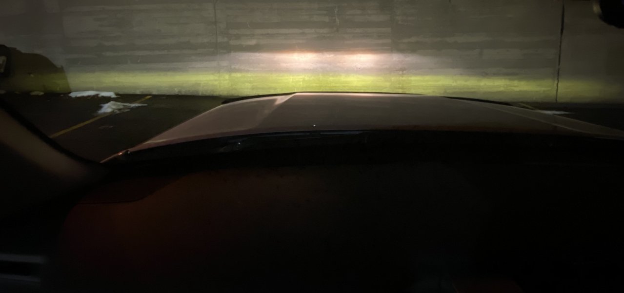

    I have the Philips 12793UNIX2 (yellow/amber) installed in my factory 4Runner fog reflectors. While it appears that the bulk of the light has a defined cutoff, there is a noticeable spill.
    Sometimes I'll park in my driveway and cycle the lights to look at the pattern. Only recently (after discovering this thread) I've noticed yellow light spilling up to the top of two-story houses. This is undesirable for a fog light.
    You can check this for yourself. If you see a noticeable amount of yellow light above your headlights, you're glaring.

    To evaluate this it really helps to have the foglight anytime mod done, as in short range wall shots the headlights will conceal the uplight. But you are going to have excessive uplight compared to an SAE fog assembly.
    Glad to see I'm not the only one that does this. Even with SAE compliant fogs I like to check the pattern.

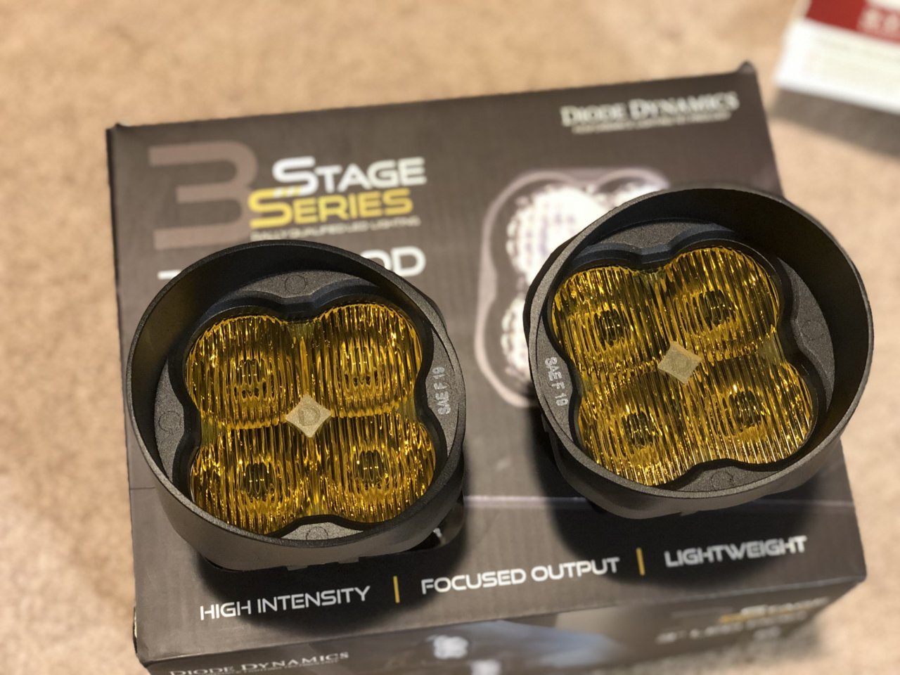

    Can’t wait to install these on the weekend!
