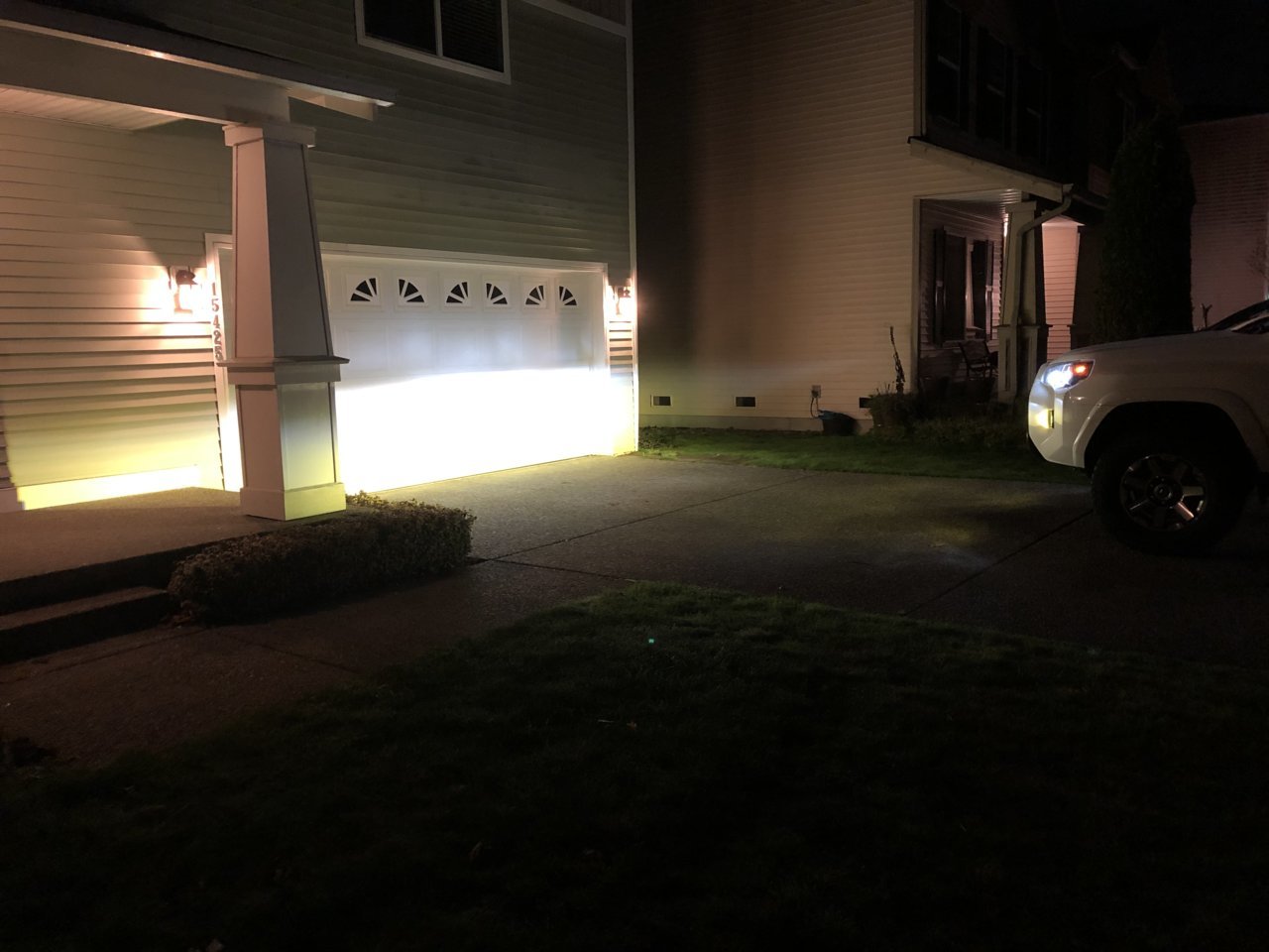

    If you can get a night shot from the drivers seat, I’d like to see the beam pattern on the road.

    Proper aiming procedure covered here:
    https://www.danielsternlighting.com/tech/aim/aim.html
    This below is the easiest way and what I suggest, though it doesn't help if the stock ones are already removed from the truck.

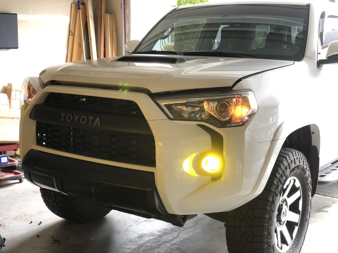

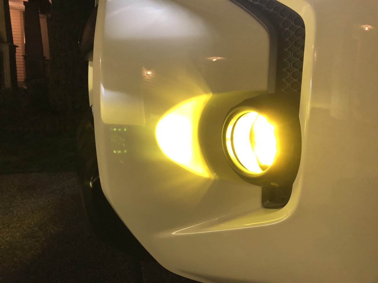

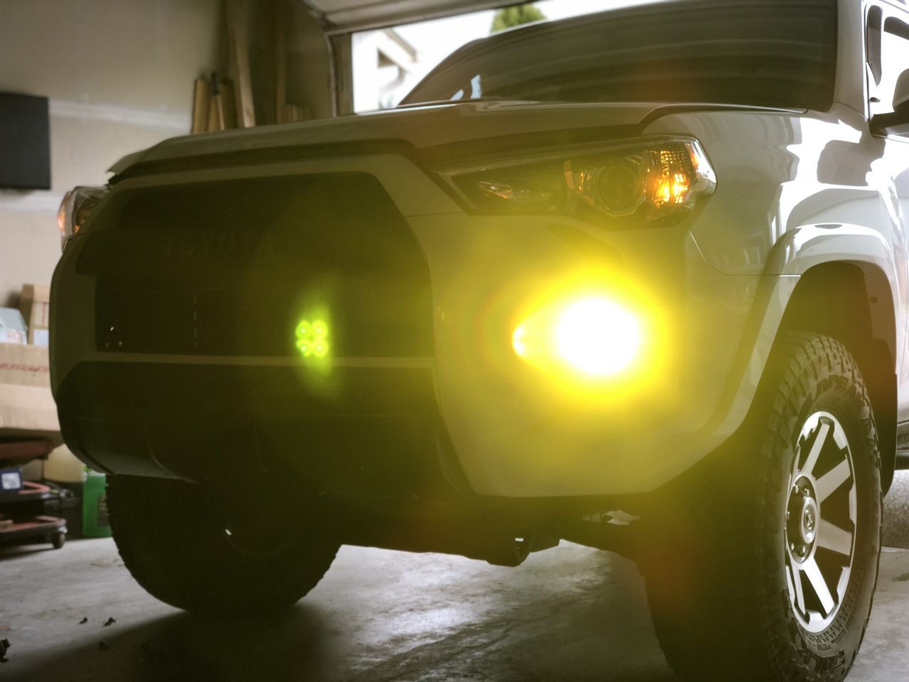

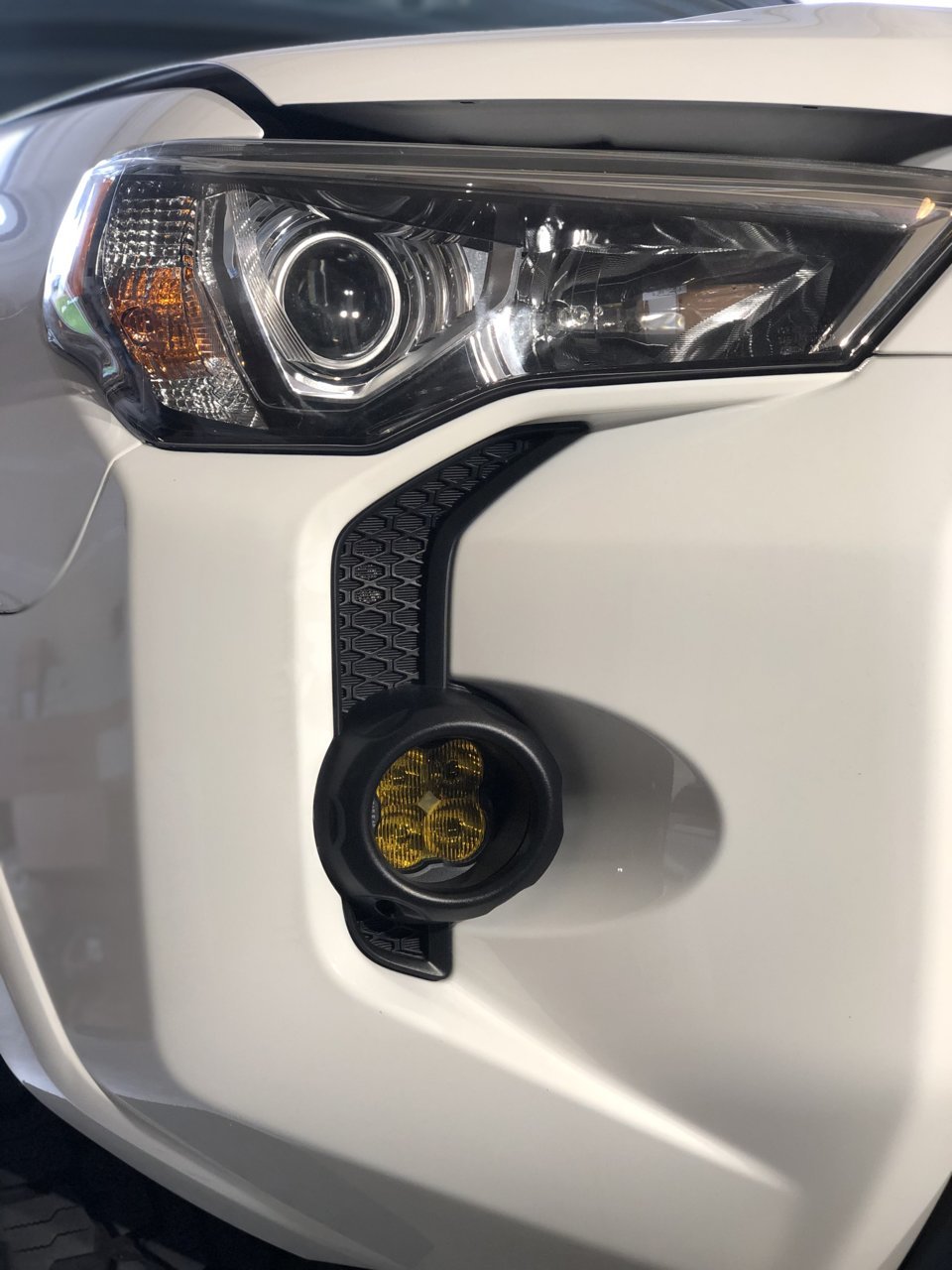

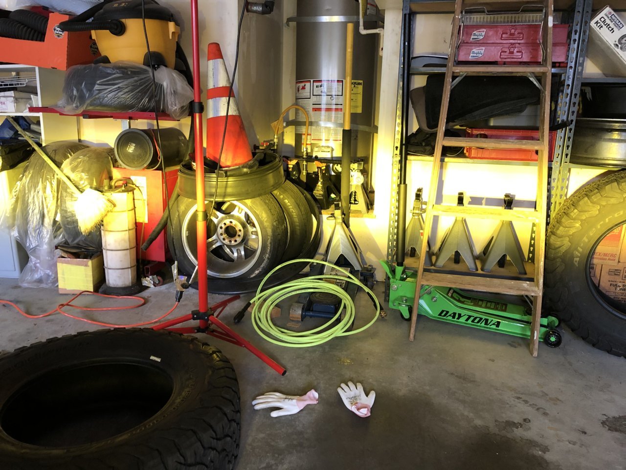

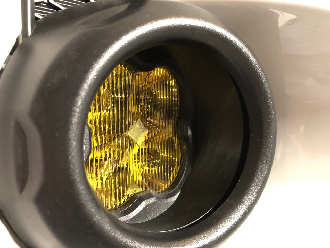

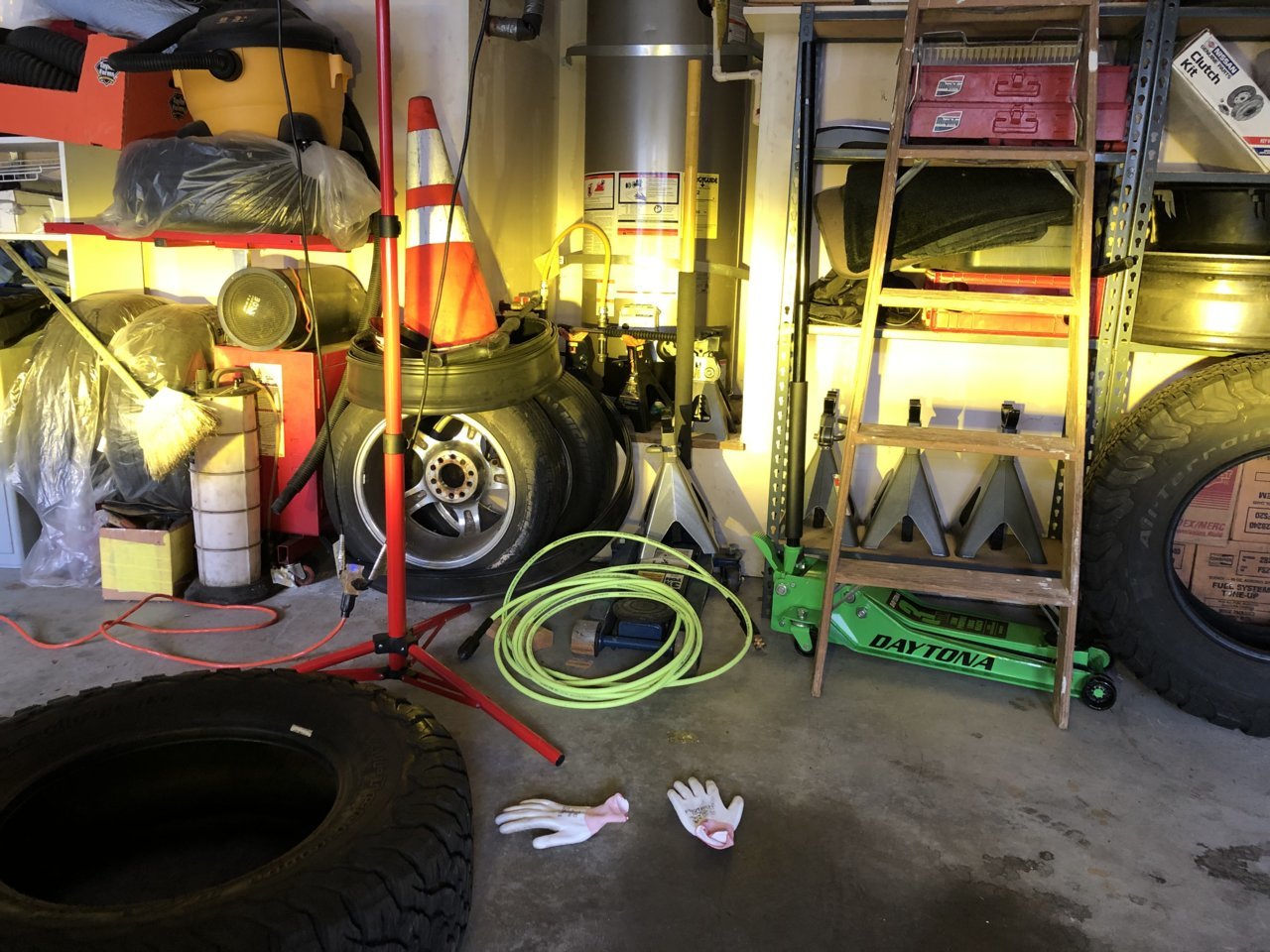

    3C20EB1D-937C-4BD4-80F4-7467ECCE164B.jpg AA0B9457-586B-4FF9-98D3-E949B601C962.jpg 7A5C7E24-8498-4D55-BB07-E1D60DED37DA.jpg C9F3EBD2-4DBD-4ABA-A95D-2EE1507AFA91.jpg E1338B61-A1FE-4EB2-9913-F8F4A1B0F2BC.jpg 1F8A977F-3E68-4DE4-95F5-1616BC3AA56C.jpg
    Seeing the reflection on the bumper pocket leaves me contemplating wrapping that area matte black
    The foglights made my new Philips XV2 headlight bulbs look like chumps

    iPhone couldn’t quite pick up just how full the yellow floods. The lights are quite a bit brighter than the Philips bulbs I had.
    Can only imagine how much output the driving version lights up.
    Can’t wait to see @crashburn80 ‘s review. If desired, I’m free this weekend since you’re just a little south of me.

    Got the SS3 pro selective yellow yesterday. Installed the drivers side, but is noticably higher than the factory passenger.
    The instructions say to "Adjust and aim...using the screws [3rd gens only have one screw] on the side of the bracket."
    This doesn't seem like it allows any up or down adjustments (unless I'm not seeing a way).

    Please loosen the screws on the sides of the bracket where they mount the bracket to the actual lamp. The DD bracket, not the stock one. You can angle the lamp down and tighten the screws in that position, with the SS3 angled as needed. Hope that makes sense!
