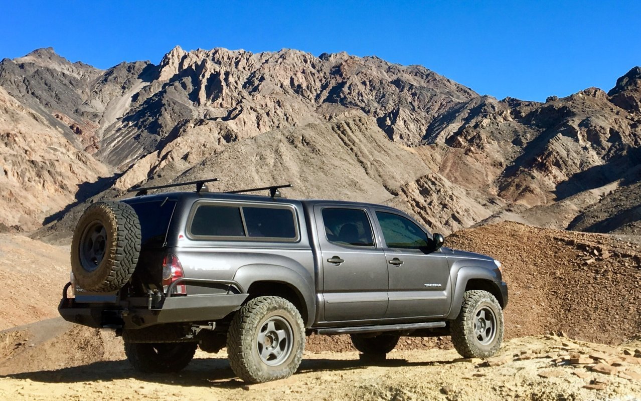

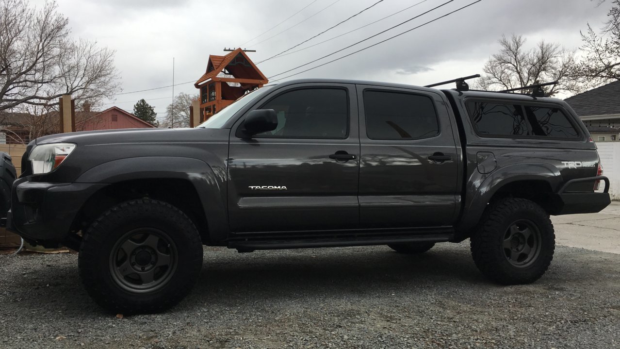

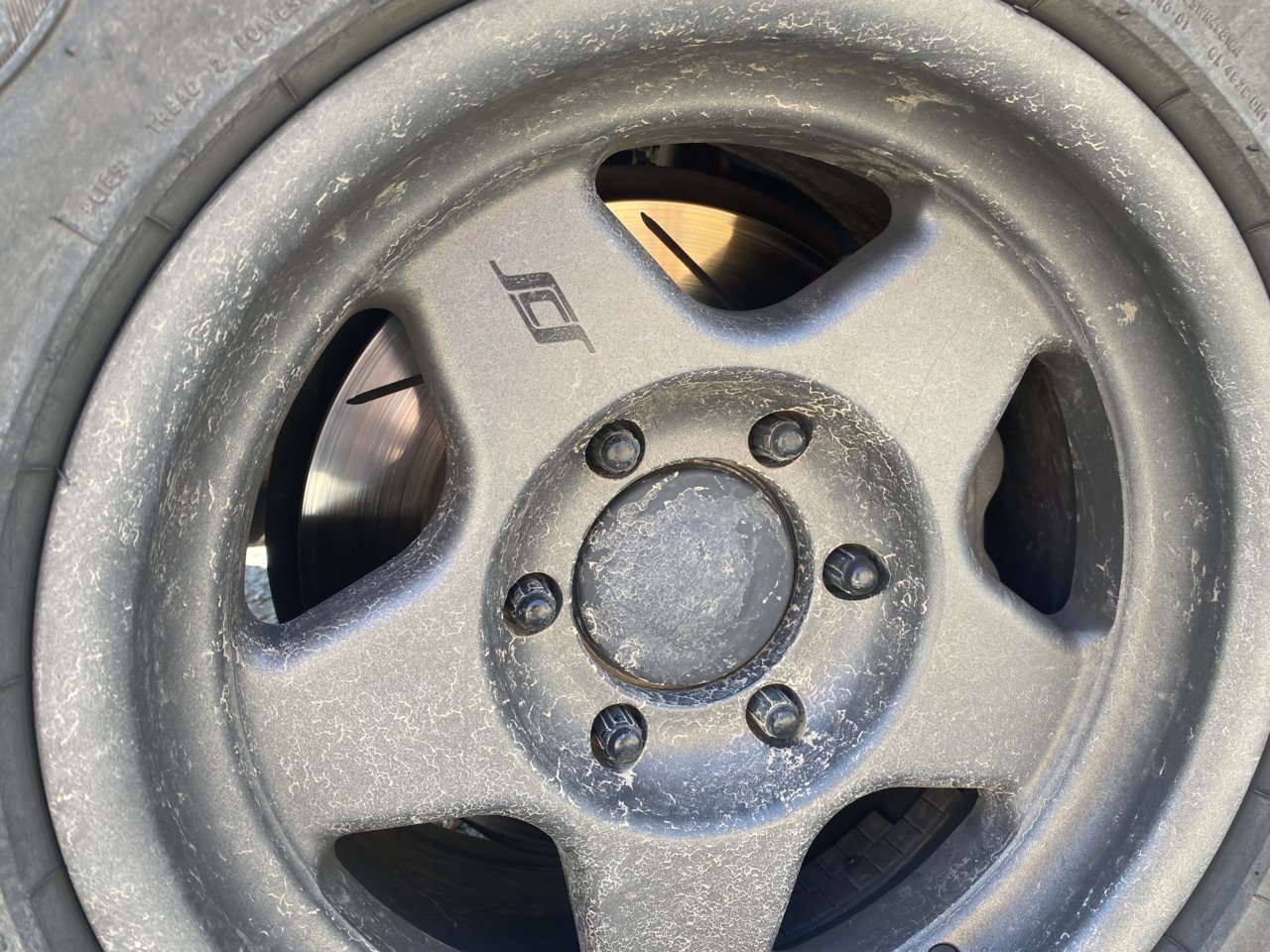

    SCS F5 in 16x8.0...19lbs. I went with a 265/75/16 in a C load to keep the weight down but still have a decent tire for off road and snow. These were 5 lbs lighter than the factory 16" alloys.

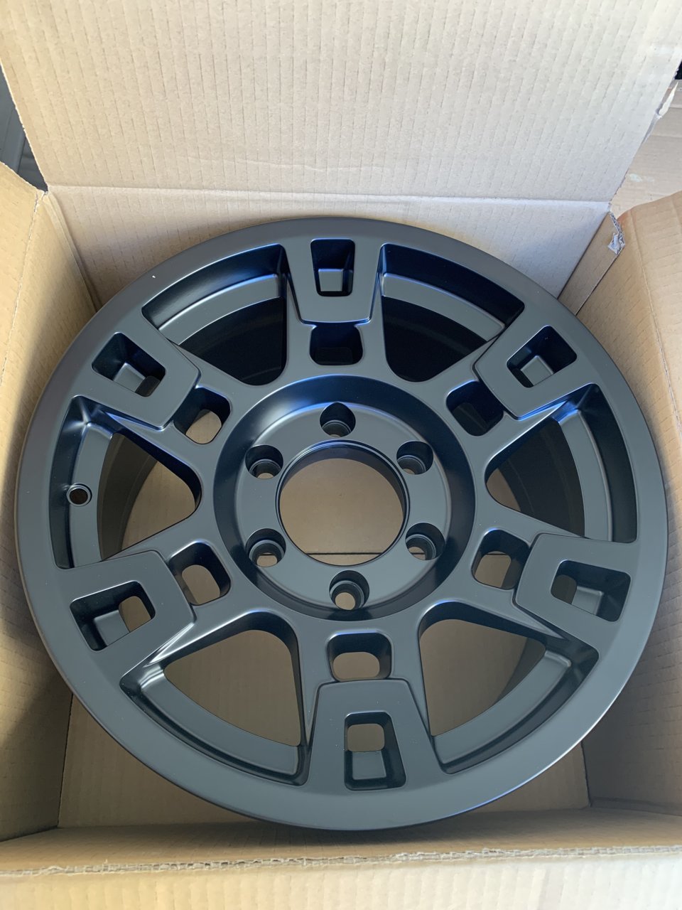

    copy paste from an email I received from FN wheels. I got the 16” matte black, they sell these in 17” as well.
    FN Wheels ƒ(x) Pro
    Diameter: 16"
    Width: 8"
    Offset: 0mm
    Backspacing: 4.5"
    Load rating: 955KG (2,100lbs+)
    Weight: 21lbs (approximate)
    Construction: Flow formed
    Certification: JWL-T, VIA, SAE J-2530, DOT approved
    Colors: Matte black, matte bronze and matte gunmetal.
    Toyota specifics: 106mm hub centric for Toyota hubs and drilled to accept TRD OE cap PTR18-35092.
    Benefits over OEM wheels: 8" rim width allows for a broader range of tire sizes vs. 7" OEM TRD Pro rim width. FNWheels FX Pro wheels are tested and certified to SAE J2530 standard with 33" tire diameter (stronger than OEM TRD Pro wheels) while maintaining a lighter weight for a reduction in rotational mass compared to the OEM wheels. FN Wheels satin-matte clear coats provide superior durability compared to OEM Toyota full flat - matte clear coats.
