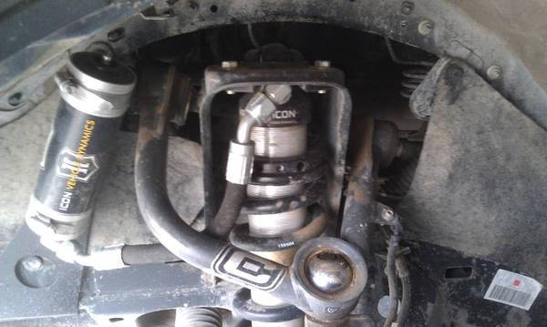

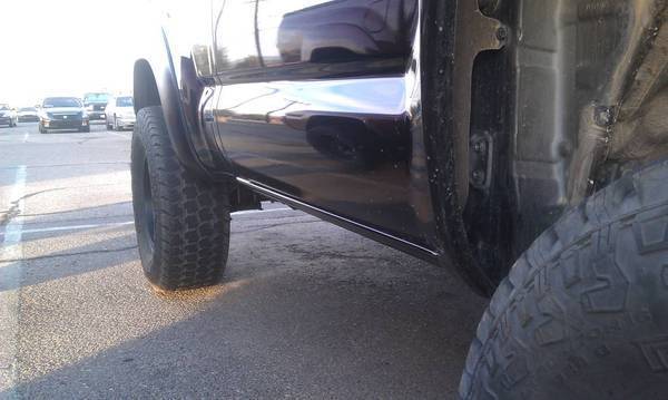

    So in light of finally getting the Icon AAL's installed I wanted to finally put the bro lean and tire rub issues to bed. So this weekend we kicked off with lowering my suspension a 1/4''. (side note, because I get excited I always fail to take after shots, so everything is before).

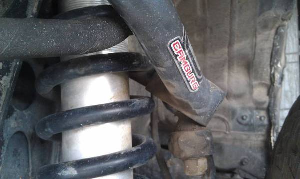

    We measured the shock and to my surprise the coil was only loaded 1 1/4''.
    A closer look. My depth perception is garbage.
    Since the issue has been raised to me before I decided to take a picture of how close the UCA's came to the coil. I never has issues (obviously) with smacking the shock at full droop off road. Being that I shaved off that 1/4 be rest assured THE UCA IS SITTING ON THE COIL AT FULL DROOP. I will have to invest in some limit straps.

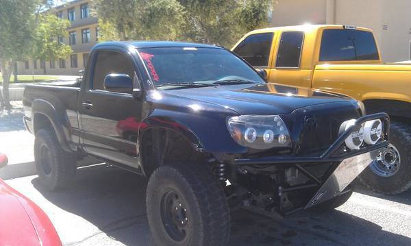

    After making quick work of the shocks it was time to start cutting that damn cab mount...again. Managed to get a hand with that from Pacman4runner.
    All said and done, no more freak'n bro lean. The truck rides SO much better. I have yet so take it out for a light run but that will probably wait until I get some limit straps.

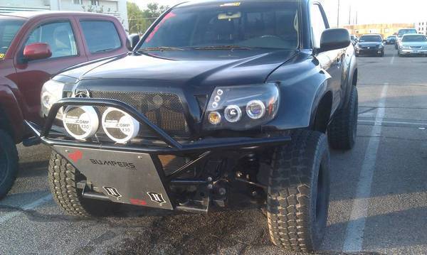

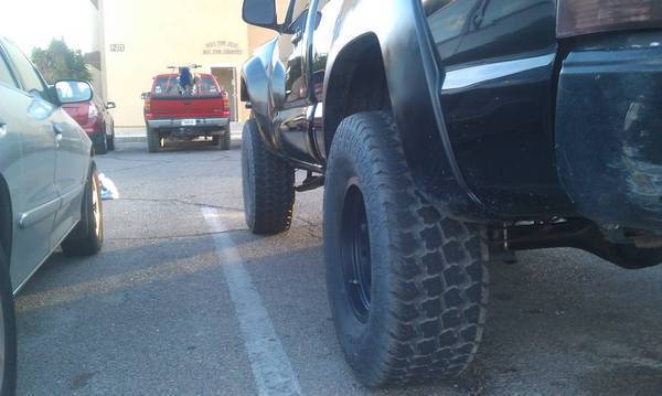

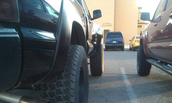

    Since I'm on this sweet mission this week that gives me free time while the sun is out I took the liberty of doing a bootleg wash on the truck (spray on wash/wax). It came out great FWIW and here are some shots of it's new stance :D
    It may seem so petty but I love that it's finally level.

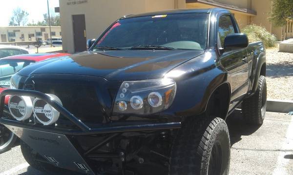

    OP got a make over. I finally had time to turn this back into a presentable build thread. Enjoy!

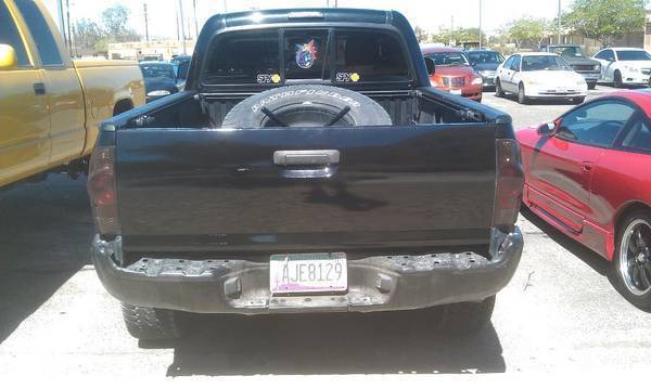

    As promised pictures of my painted fenders and tailgate. Fenders need another coat of clear but they came out pretty damn good for a garage job.
    Just need to get more hardener and all this can be finished up. Grille, door handles, and mirrors are next for paint.
