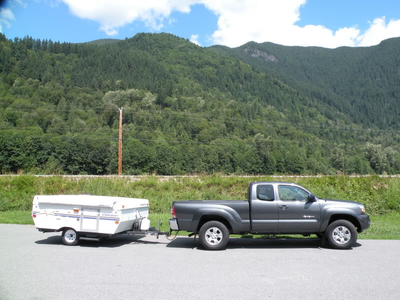

    Hey everyone,
    Alright so i've been going out the the desert with my uncle and their riding buddies for a while and my tacoma has happily handled a fully loaded bed with camping gear and dirt bikes. While i wont be in the financial situation to be able to get a trailer for a while, I'm starting to entertain the idea and see if I will need another truck, or if my little guy will handle it. I've surfed the forums looking at all the different towing information, read the towing bible, etc etc. Basically I understand that i can't tow too much, since i have the wimpiest of all combinations of the tacoma. That being said, it sounds like i could still manage to pull something like the below pics, which have come from other members on this forum. Any input?
    I've got a 2.4 liter, 4 cylinder, 2WD, ext cab, non-prerunner, year 2000 tacoma. Also my wheels are significantly smaller than stock, I'm running 205/70-R15s right now. Yes those numbers are correct. Any tips on my limits for towing? How big can I dream? Haha.
    Here's some trailers that i believe my truck could handle based on reading around. Basically i'm trying to get out to the desert with my dirtbike, which would be in the truck bed, and i'd like to tow something like these:
    Thoughts? Also my truck did not come with a tow package. The previous owner installed 4-flat trailer wiring and a bumper ball, which I have used to successfully tow small 6x8 trailers with single motorcycles on them. Downside to just using that is a lower tongue weight and decreased turning radius because the trailer will hit the bumper if you turn too hard. I've lightly dented my beautiful chrome bumper on both sides because of that :(. If/when I get a pop-up trailer, i would definitely get a bolt-on hitch to use as well as the brake commander.
    Ok, chime in! Help me out!

    I'm not a towing expert, but judging from the pics you posted, you should have no trouble towing a small pop-up camper like those as long as everything is properly set-up.

    Those trailers don't look too heavy. I'd image your truck is rated for more than that. You are ahead of the ball game with smaller than stock tires.

    OP, be weary of that second pop-up you posted, sometimes they can be be very heavy. Some models with the area to haul dirt bikes or ATV's are built on flat bed trailer platforms then a pop-up shell is put on the back which means they're very stout and fairly heavy. Just a heads up to check the weight of the trailer, but you should be fine with most pop-ups.
