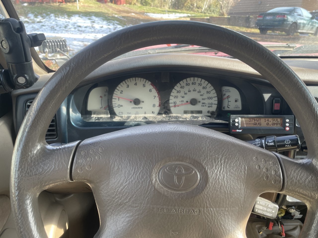

    Man, I’ve been gone for far longer than I anticipated. Its back on the road!4752E7C0-12DC-46C4-AA5E-42C440874319.jpgB6EA90B7-82F1-48F0-B3E0-4B2805CE469F.jpg

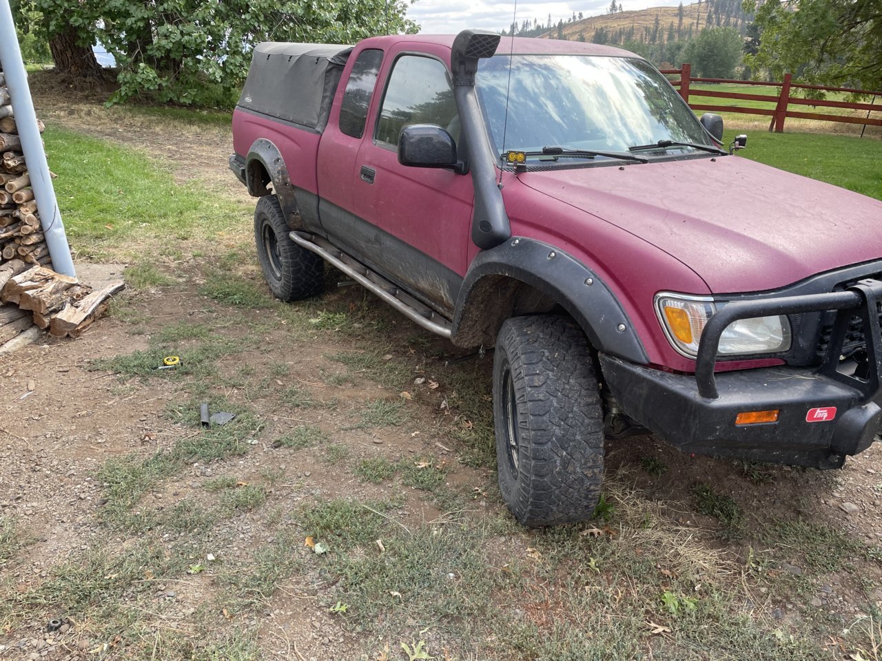

    And always getting upgrades6A9019C2-7B46-46EC-A41F-E10956972523.jpg 20D988DC-FA8D-4ACD-A01C-1D272C362C28.jpg

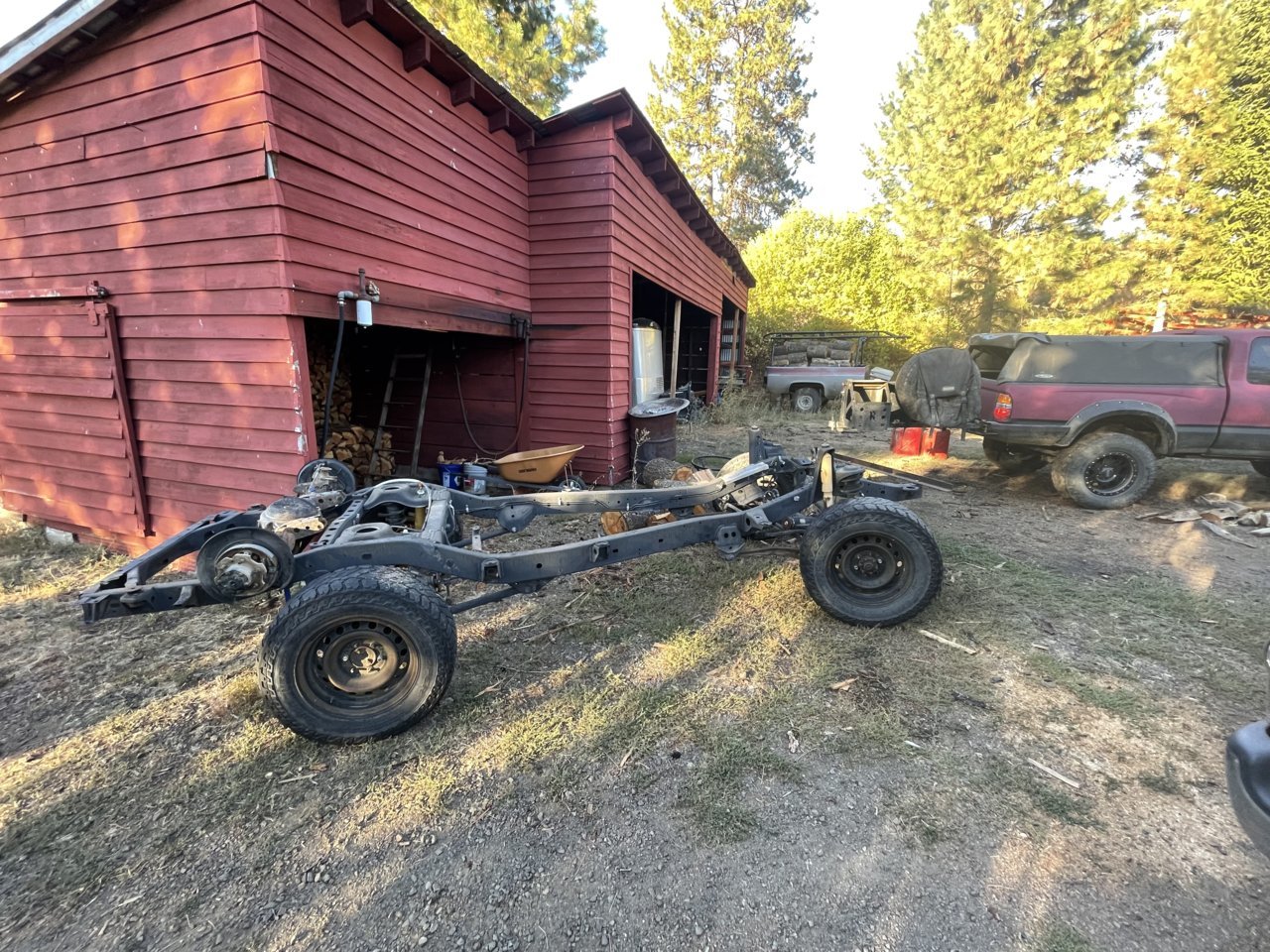

    I picked up a set of axles for an eventual solid axle swap813F4B31-B7E5-426F-9168-2097C3FC39DC.jpg

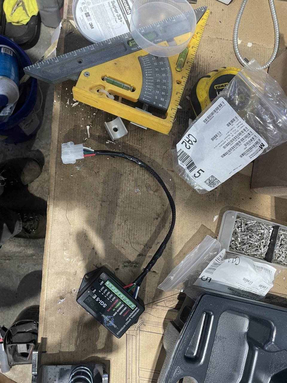

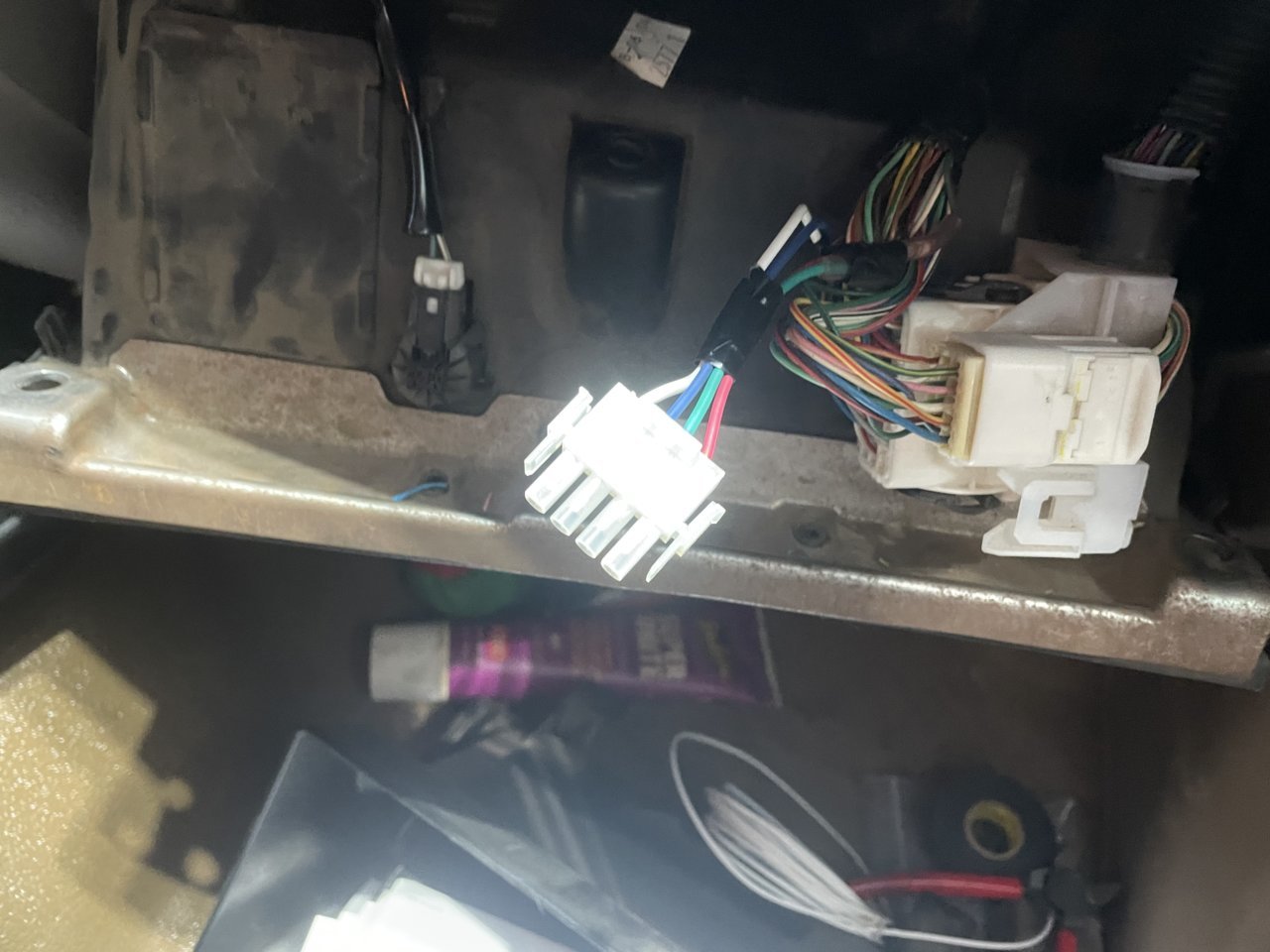

    Installed a dakota digital spi-5e unit to correct my speedometer. Pretty straight forward install. Hooked into the speed wire behind the glove box and found an ignition positive and a negative with a multi meter. Used a molex connector so it can be taken out easily and made a jumper plug so I can connect the original wire back together and have a (inaccurate) speedometer if i decide to take the dakota digital out in the future. Velcroed it up behind the glove box! Happy to have an accurate speedo and odometer again.387B6E4D-2DC2-40B3-9EA2-E43A8C76B5D4.jpg863006F0-B69A-447A-8E1B-CF93EBD0803C.jpg
