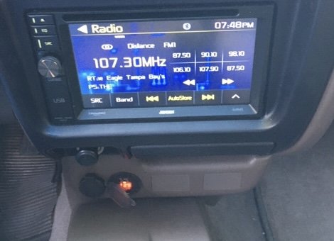

  3. Jun 1, 2023 at 7:04 PM
    Kevins60
    Kevins60 axle wrap tells me my rear brakes are working
    Dec 23, 2018
    #276677
    1,217
    Kevin
    Odessa FL
    ‘04 4cyl SR5 AT Pre-runner Garage Queen
    SCS Cruise Westin step bars Lund tonneau Jensen HU
