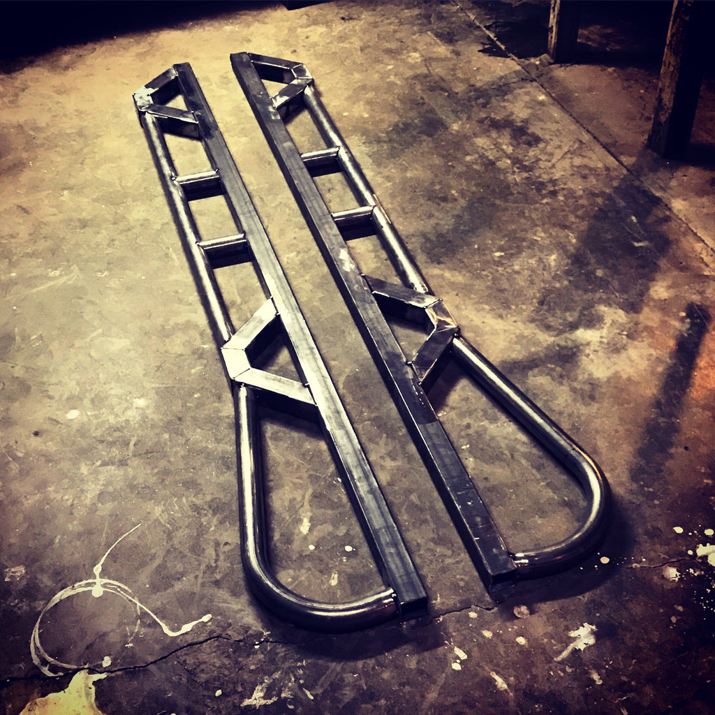

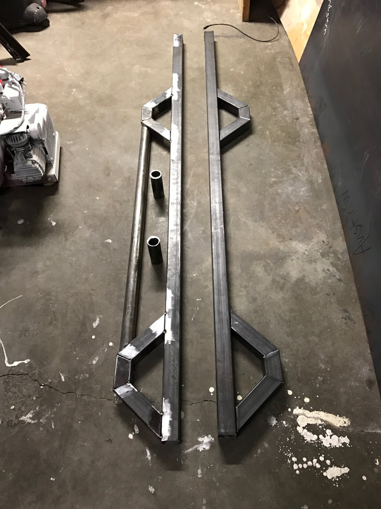

    With school and baseball, this semester has been rough and it has put the rock sliders on the back burner, unfortunately. With the semester over, I was able to start fabricating them today (even though it is 8 degrees in the garage :crazy:). Here is the progress:
    Left side: Square tubing is tacked up, round DOM tubing cut for between. Need to notch small tubing
    Right side: Square cut to fit. Still need to prep surfaces for welding and bevel some edges.
    Kickouts will be on the back end.
    Stay tuned! More to come tomorrow! Hope everyone is enjoying the holidays. :cheers:

    Update on the rock sliders: I have the rails tacked up. Next, I will fab the frame mounts and then completely weld, grind, paint, and mount. Slow process but a little at a time.
    They are turning out pretty nice for my second fab job (excluding a tube bender stand). Does anyone have input or ideas? Thanks

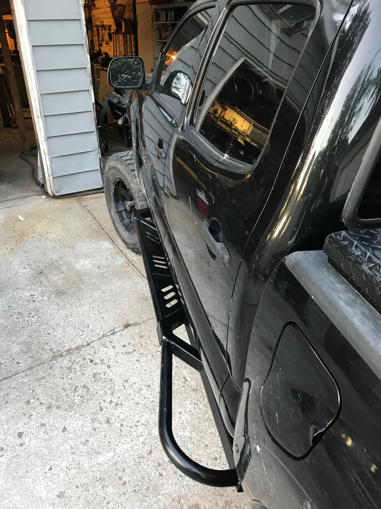

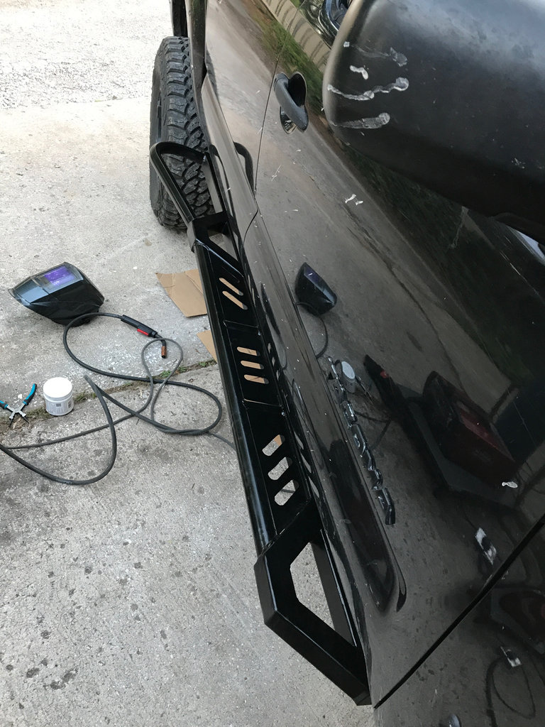

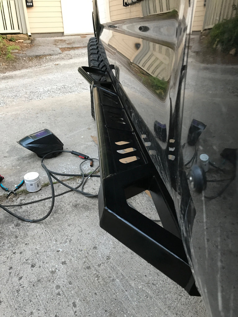

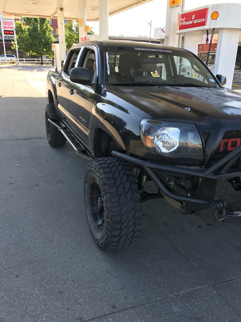

    Just finished my rock slider build! Time to move on to designing and building a bed rack! stay tuned

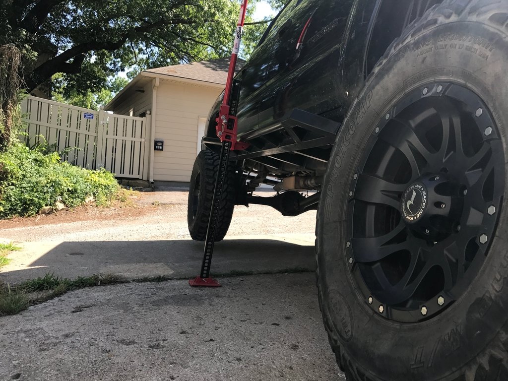

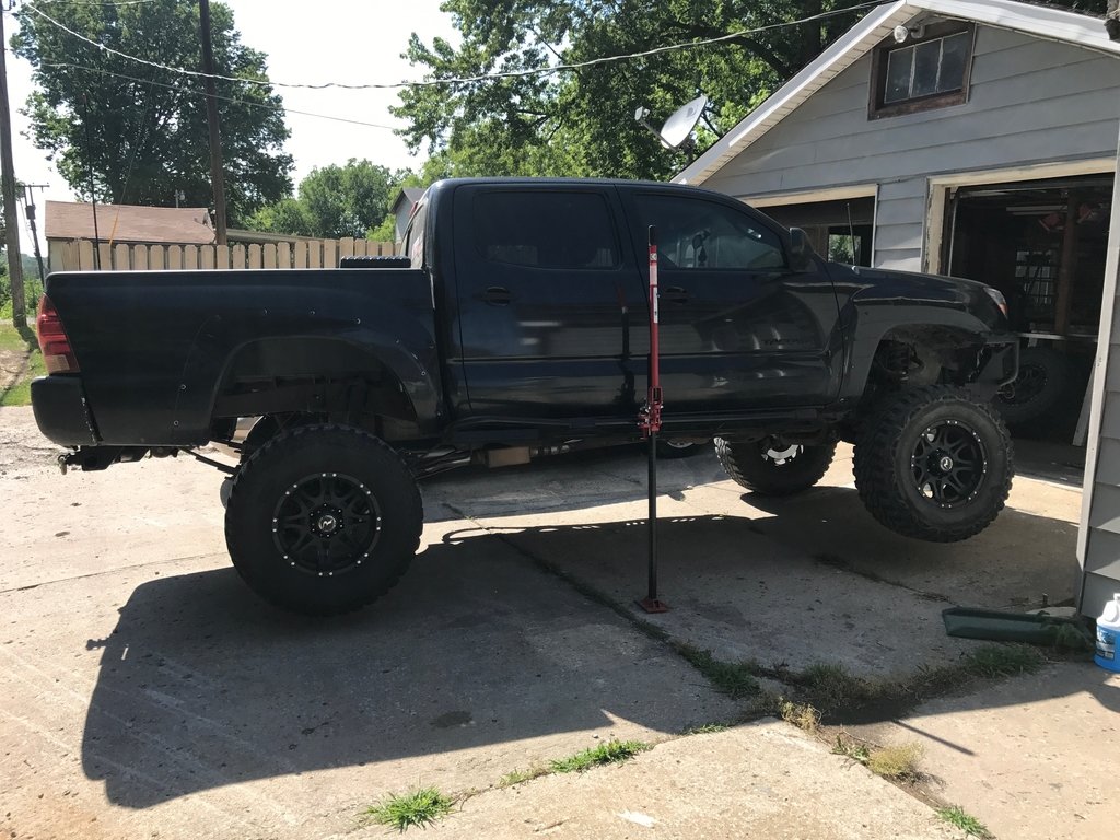

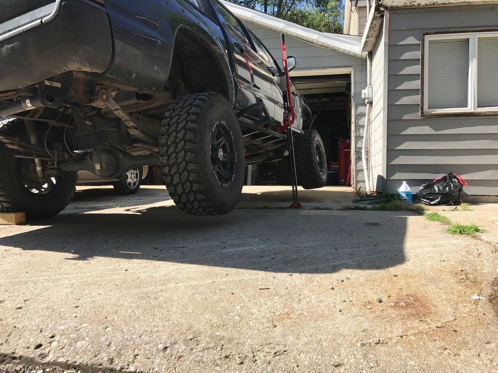

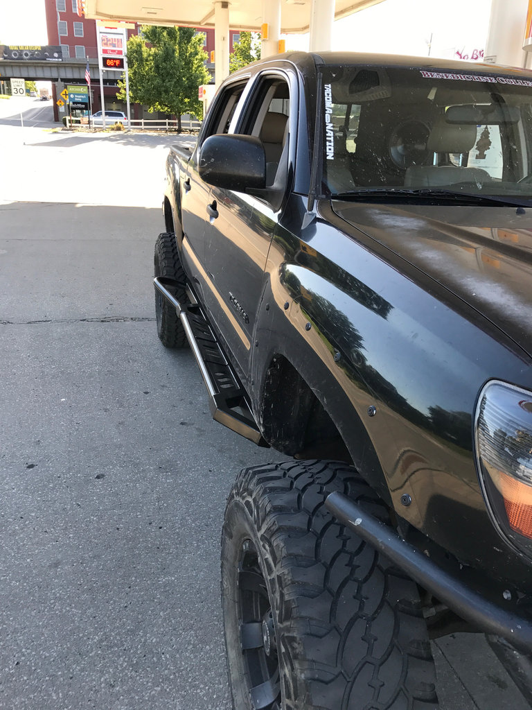

    Tested out the recently built sliders with the hi-lift today. I guess I can build things to hold lol
    It was a good learning experience because it was my first armor to build for my truck. More ideas in the works!
