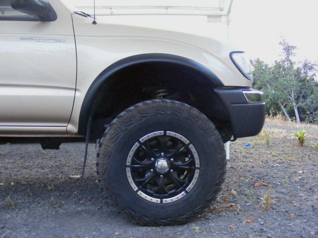

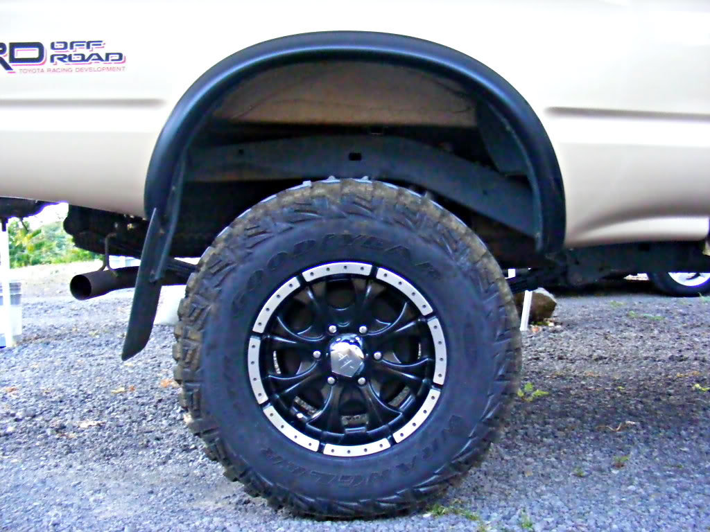

    Cody, how high is your rear end compared to the front?
  10. Dec 24, 2012 at 6:45 PM
    #670
    Konaborne
    Konaborne [OP] Pineapples on pizza Hawaiian does not it make.
    Nov 21, 2010
    #46536
    31,902
    Cody
    Kealakekua, Hawaii
    Lifted 00 TRD Off-Road
    fox extended travel remote resivoir coilovers, 14" eibach 600lb coils, All Pro tubular chromoly 1" uniball upper control arms, All Pro expedition leaf packs, 10" bilstein 5150 piggyback reservoir shocks 265/75r16 Goodyear wrangler MT/R kevlars wrapped around 16" Helo 791 gloss black, Mini H1 retrofits with 6000k bulbs, 18" magnaflow w/custom exhaust reroute various decals, Sockmonkey retro hood stripes
    front is at 24-24.5", as of now my rear's sitting at 27
    so about 3" difference :anonymous:

    Me too..rake FTW :cool: well mine is 27.5 rear..was 28ish without the rack and tent haha

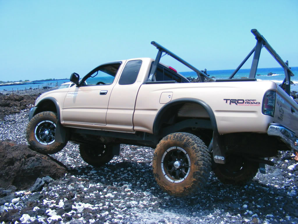

    Man you have no droop..well..I mean not as much as you should..
    Is your sway bar on??

    Hate to say it cody..but he is right haha

    haha yeah, that's with the sway still on and with no weight in the bed

    Take that shit off. Da hell is the point getting nice suspension if ya don't use it haha

    I'm gonna take em off when I do the uca install...and leave em off
    I had left it on for the sake of my parents driving the truck when I'm gone
    but the eibachs seem to be stiff enough to take care of the body roll
