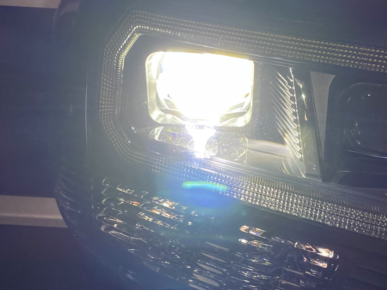

    The LED projector is a sealed unit, not like changing a bulb. So that would be a significant undertaking where you might as well look an LED projector retrofit in the OEM units.
    If you opened up the headlight you could apply a matte surface in front of the low beam projector. I’d think something texturized perpendicular to the beam output might help even more. Another problem though is the proximity of that surface to the low beam projector, it should ideally be further away like OEM units to help avoid this problem. That really isn’t fixable. What makes it worse is that 7000k is extremely reflective, if the output was a lower color temp it would mildly help but still be an issue. I don’t think many would want to open their new headlights though.

    Compare. Morimotos
    4runner OEM LED
    The Morimotos mirror finish in close proximity to the projector creates a very high intensity reflection. The OEM LED 4Runner lights move the surface away from the projector and use a matte fine speckle coating to diffuse reflection, so the surface is illuminated but not reflective.

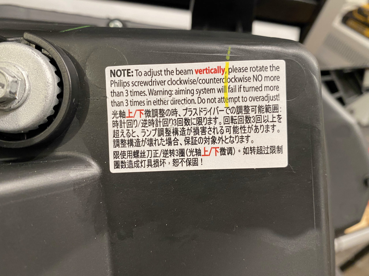

    I'll easily agree the build quality is better than other aftermarket units for sure. Most aftermarket assemblies are complete garbage. But not having stops on the adjusters so you break your headlights if over adjusting and very large gaps around the projectors so wiring is visible inside the headlight, plus 7000k color temp likely means using low cost budget emitters. These sorts of shortcomings might be similar to other aftermarket assemblies, but are not on par with OEM. "Botched" might be harsh, but that was a screw up that should have been recognized and addressed in the design phase. You can't fault Morimoto for the oversight though, since they didn't design or manufacture them. Coplus designed and made the headlights. Those OEM T4R LED assemblies I pictured a couple posts up are 25%+ brighter than these Morimotos, 5000k color temp, have proper housing design to not have reflected glare, have correct uplight designed in the pattern, have no odd gaps around the projector and won't break if turning the headlight adjuster to far. That OEM LED product, is impressive and very, very nice.

    I am currently looking to update the headlights on the 2013 I just purchased. I am on the fence with buying the newer XB's but am also considering a retrofitted set from a TW member, both about same price range. My driving will be mainly city / highways, no off road.
    My question is about the aiming on XB's as I read your limited to 3 turns for vertical aiming. My truck is stock suspension/height. Do these come aimed properly for stock height trucks? For those who installed the XB's on their stock height truck, did you have to adjust and how did you know when to stop before passing the 3 turns?

    I've not heard any issues with not being able to aim. I wouldn't be too concerned about getting them dialed in. Just don't over adjust in the process. If looking at retros, I’d highly recommend an OEM HID projector, such as the RX350 units. Many aftermarket projectors units lack proper uplight and units like H1 halogen based projectors will force you to low quality Chinese halogen based HIDs rather than the real thing from high quality leading manufactures. Check out post #5506 for some HID comparison info:

    It is the Morimoto XB headlights that have the poor adjustment mechanism with no stops. It is in the original post. Their other headlights have the same issue.
    Morimoto XBs:
