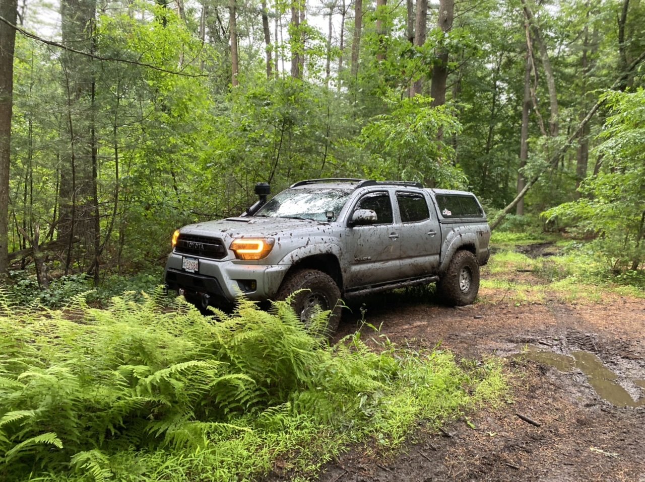

    Horizontal adjustment on these headlights is an absolute PITA. The passenger side is the hardest... the drivers you can get at with extensions and a ratchet if you remove or move the battery. I never fully adjusted my passenger side horizontal because it was just impossible to reach.
    Odd though.. my adjusters didn't have those black covers on them like you have... you'll need to remove that unfortunately.

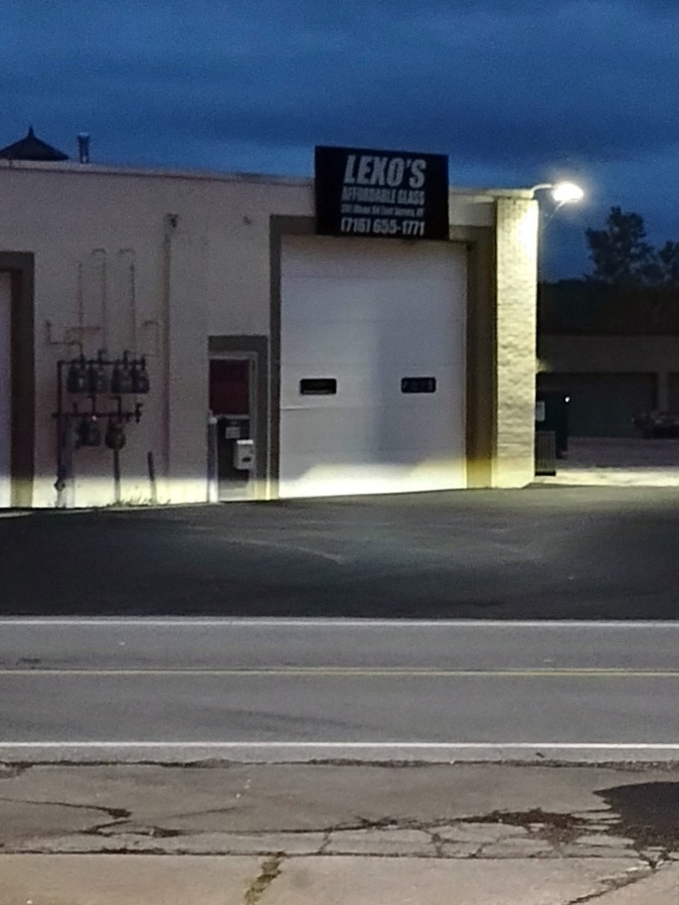

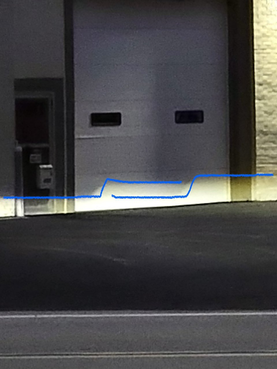

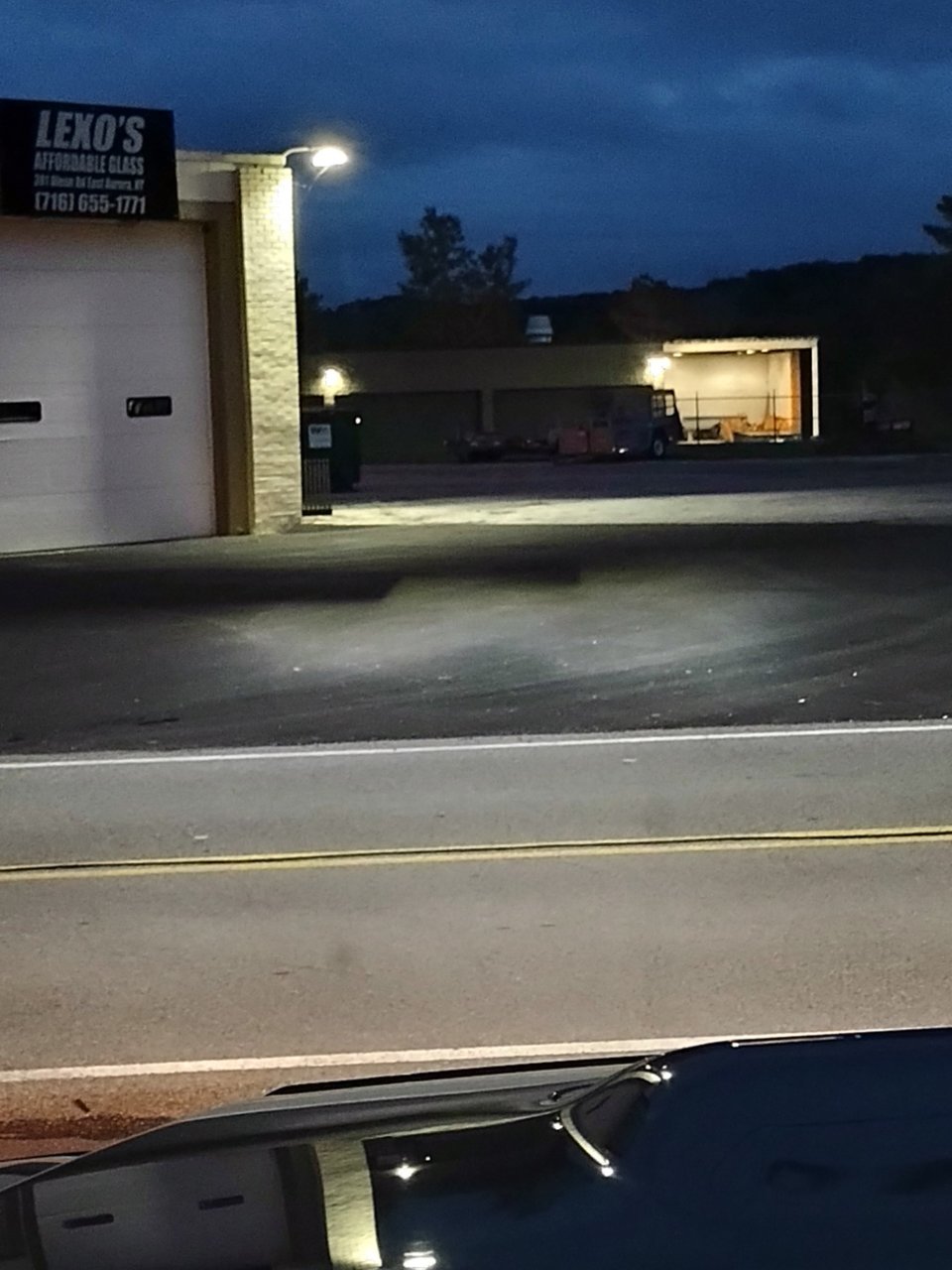

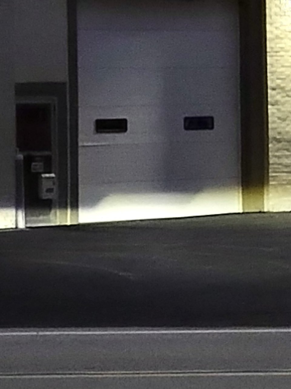

    I got the plastic covers off and adjusted but the driver's side cut off is annoying I tried my best to show it in this pic but the passenger side is smooth and rounds off to the right and the drivers is flat than angels up and over . I can see it on the road and looks like it should be filled in . It's not a smooth cut off at all almost like I have to passenger side headlights ...

    Your cutoff looks correct, you just need to raise the driver side a little bit.
