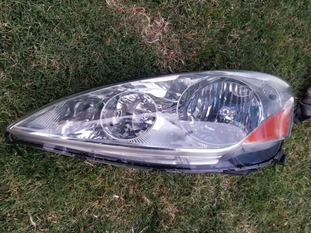

    My question is how to reconize the difference between a projection light and reflector light. More spacifically on my 06 Sienna factory HIDs. These are HID low with halogen 9005 high and factory 9005 fogs.
    On another thread you really helped me along huge with bulb identification and choice but am still uncertain if these are projectors or reflectors lens. Not that it matters, I'd just like to know. What visably defines each type?

    1,125

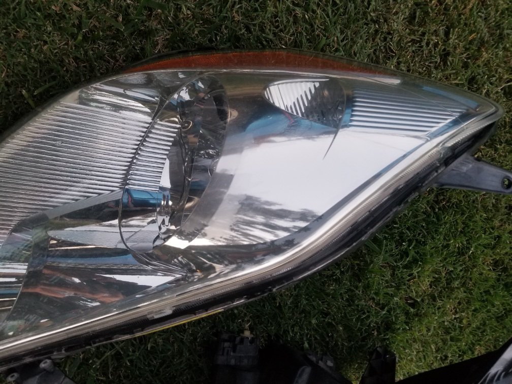

    Reflector headlights have that chrome bowl and you will see the bulb protruding from the bowl. Projectors look like sealed magnifying glass.

    So my Sienna must be both? The low (HID) has a cap with no bulb visible. The 9005 high beam is visible

    If you can see mirrors in the lamp, it is a reflector. If you can only see what appears to be a glass orb it is a projector. Your lamps are reflector low beam and reflector high beam. Low beams typically have a glare cap that covers the end of the bulb in a reflector to prevent uncontrolled light escaping and causing glare to oncoming drivers, that isn't an issue on high beams so they do not.

    OEM HID D2R
    O.k. the low HID D2R on my 06 Sienna has a glare cap therefore is a reflector.

    Your lights are reflectors, hence the R designation in the D2R bulb. D2S is for projectors, which you do not have. You need a D2R. HID reflectors are much less common than projectors, so not as many bulbs are offered for the HID reflector platform.
