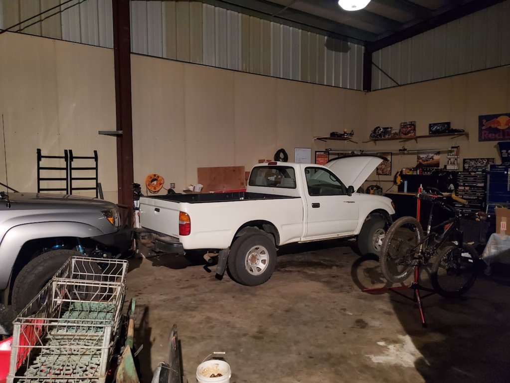

    Long story short, this stray followed me home. It was mostly rust free, kinda straight, dirty, neglected, blown up but it was pretty cheap. I had a new project and figured if I got it running, it would be something that would replace my old 4wheeler on the farm.

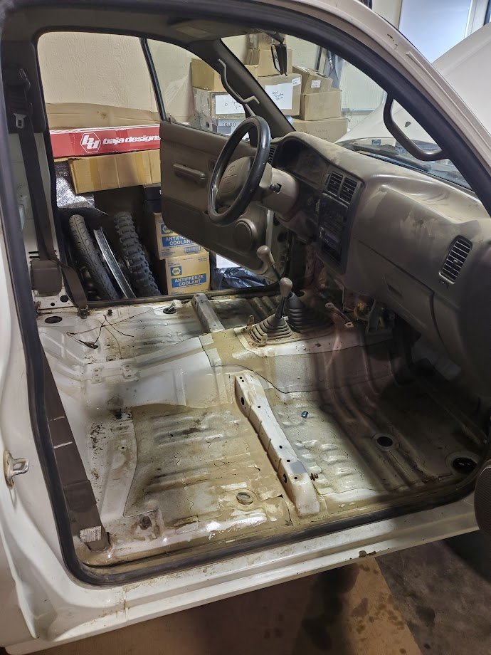

    I got to work cleaning

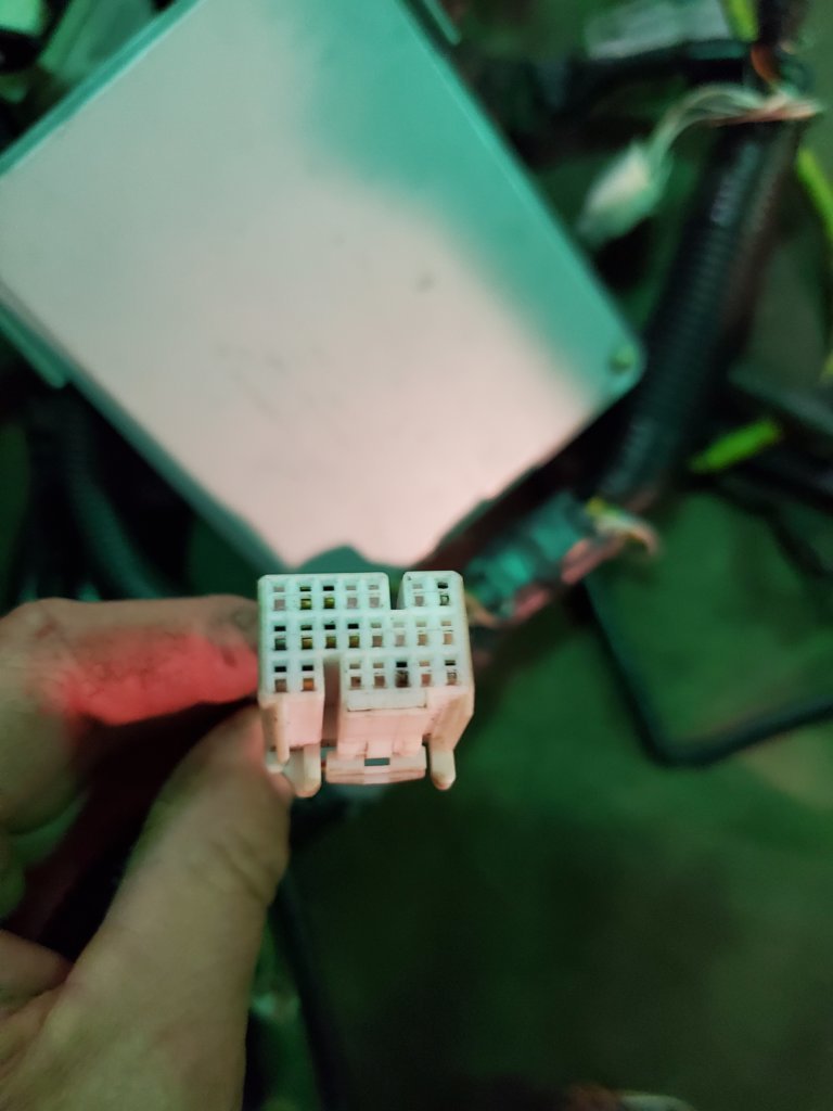

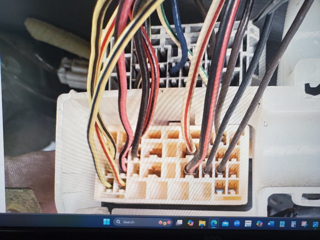

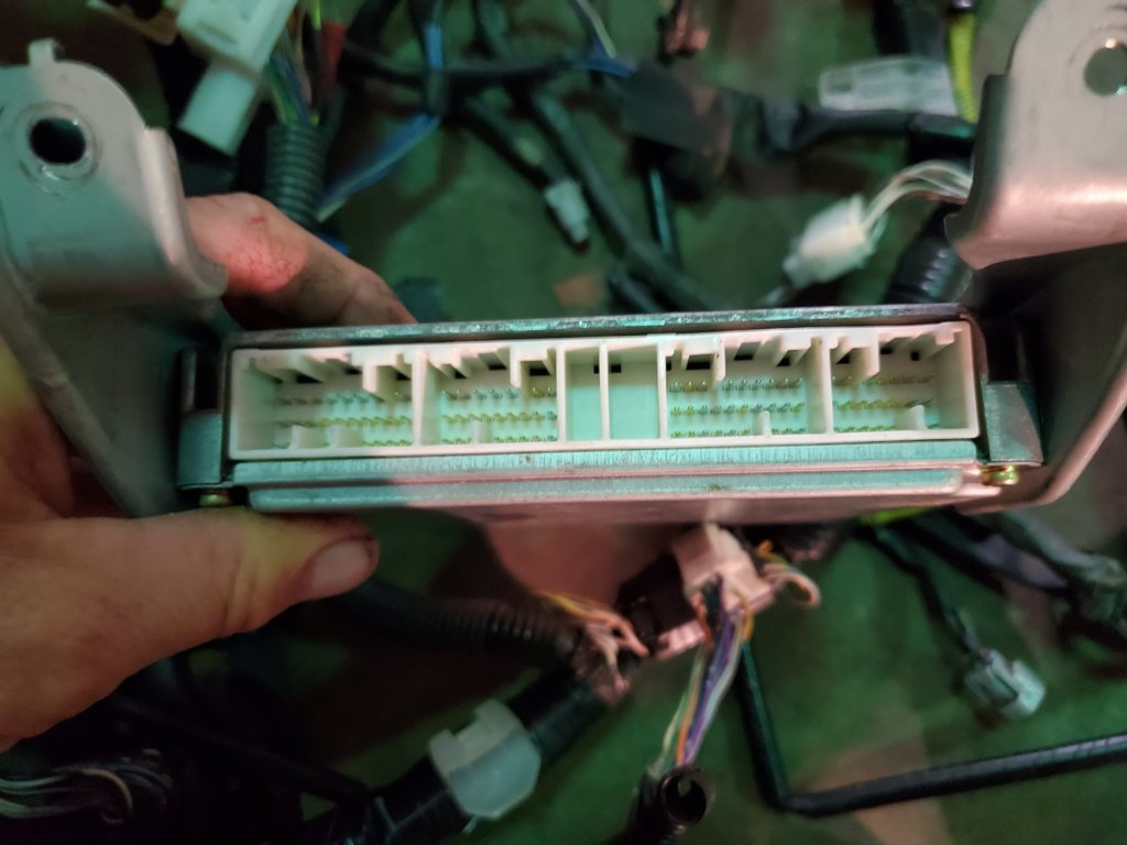

    What I didn't notice, because I didn't know this beforehand about the 3RZ platform, is that this blown motor wasn't the original. What I discovered was someone had swapped out a dual coil 3RZ for the stock distributor motor at some point in the past. I always thought all 3RZ's were either dual coil or coil pack motors, so when I saw dual coils on a 95.5, I didn't even think to look for engine swap shenanigans. Turns out the cab wire harness was hacked up and that's why indicator lights and my scan gauge weren't working. Bummer. Knowing what I know now, I likely should have passed on this one. But I was stuck now.

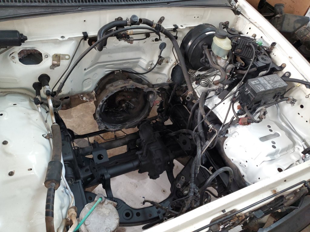

    With the new motor home, I set out to getting the remaining parts on order and prepping for install. I also called Sunwest, canceled my order and asked for my deposit back, saying it had been two months with no definite completion date on the near horizon with zero communication indicating their timeframe. With the cancelation, they quickly scrambled and told me the motor would be ready Friday of this week. I told them I was canceling my order and I didn't want the motor. They said, fine, but told me the deposit was non-refundable. You can PM me for the remaining details but I now feel pretty strongly that Sunwest can eat a kingsize bag of dicks. Zero out of 5 stars.

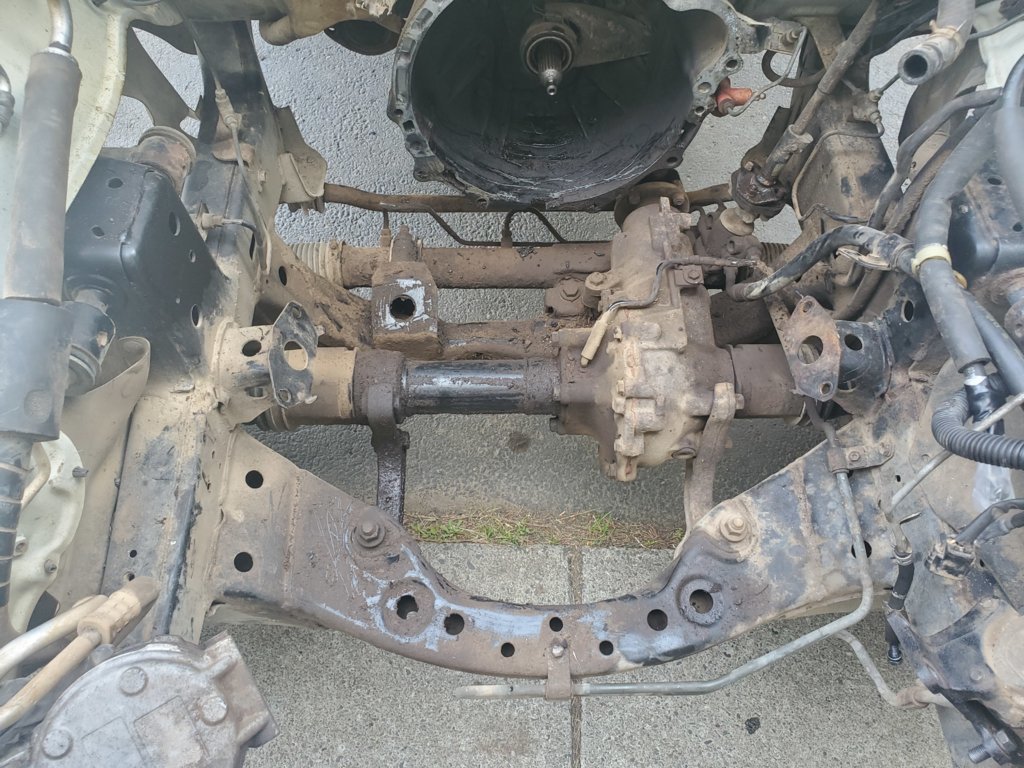

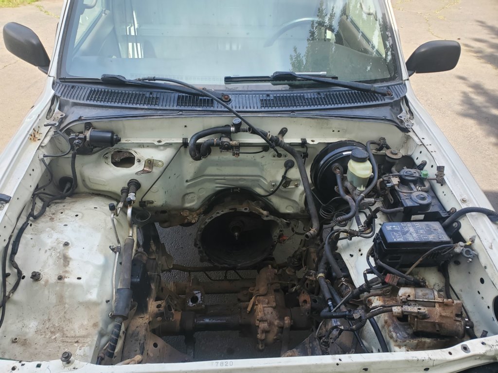

    Anyway...the old motor coming out (with a painted valve cover. I thought that was going on the new Sunwest long block. Nope).
    Yuck, so much gunk.

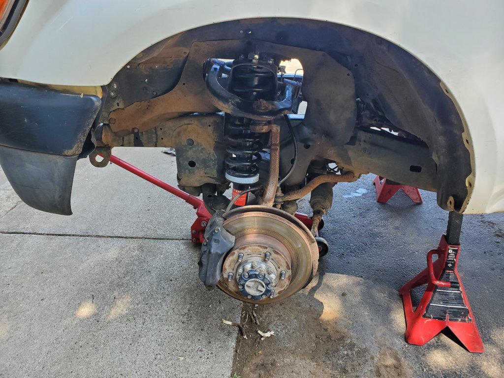

    After a degrease time to hit everything up with Rustoleum Rust Converter and do a shitty job repainting the battery box area.

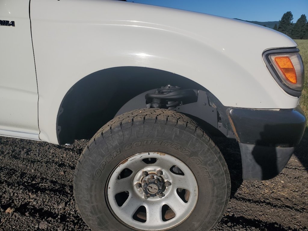

    And hit the suspension and frame, too.
    No torn down pics, but am happy with the results (with some new ARC splash guards)

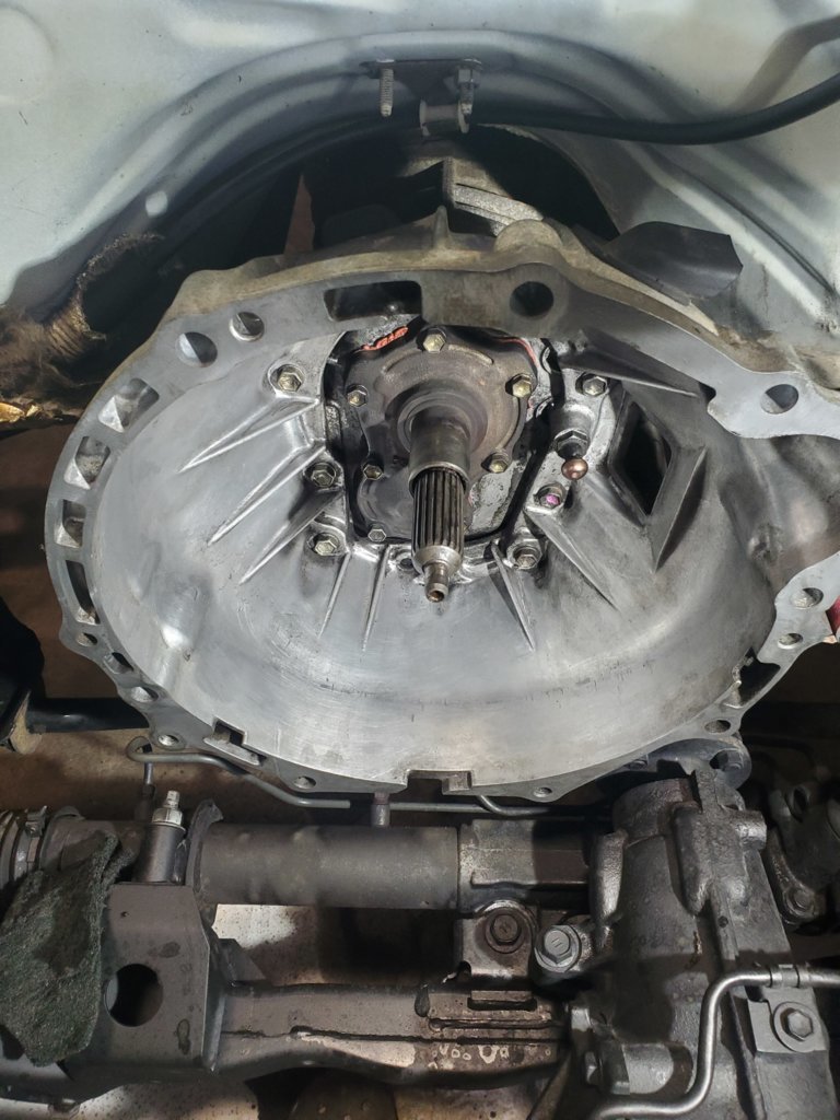

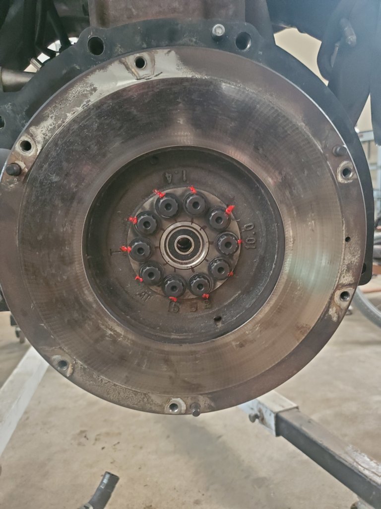

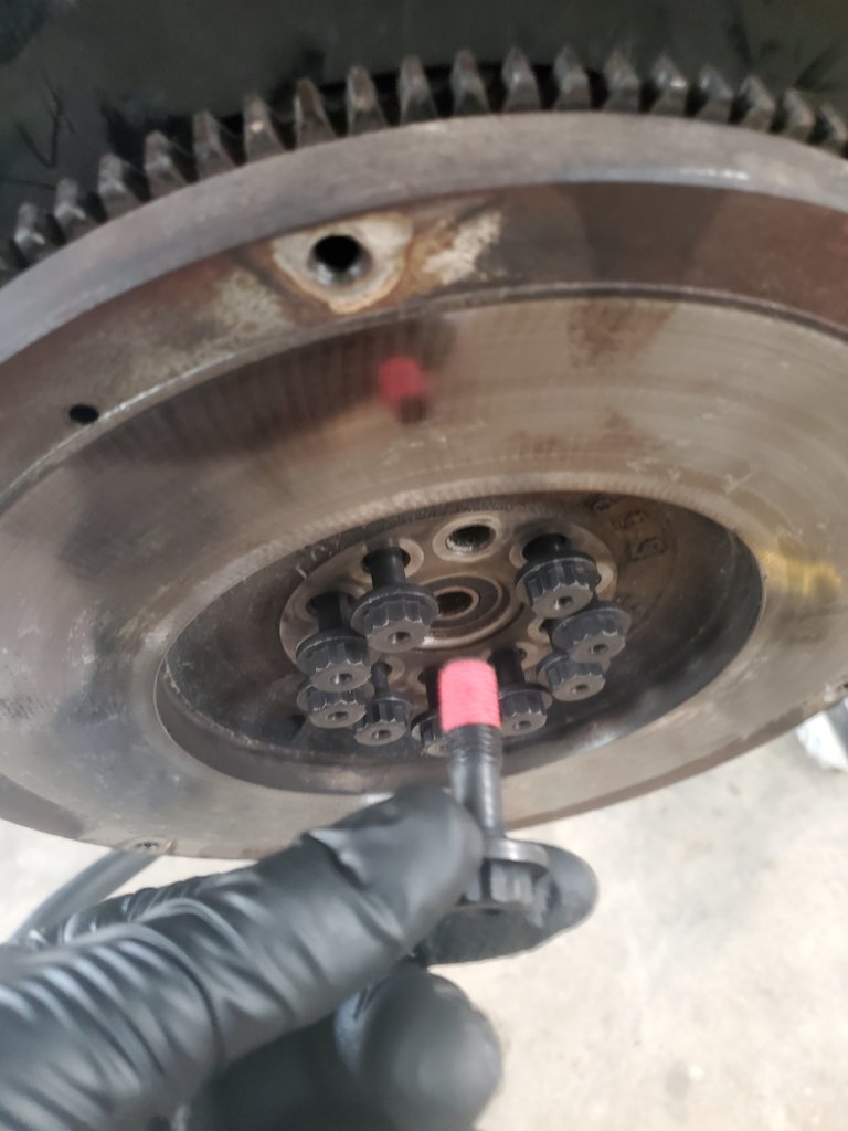

    I had a couple of flywheels now. Both looked to be in good shape without needing a resurfacing. The one I used had less than 12k miles on it. New hardware of course.

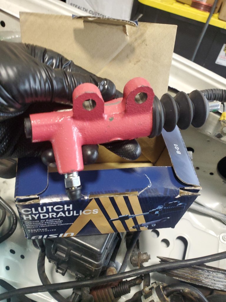

    New clutch, pressure plate, TOB and slave, too.

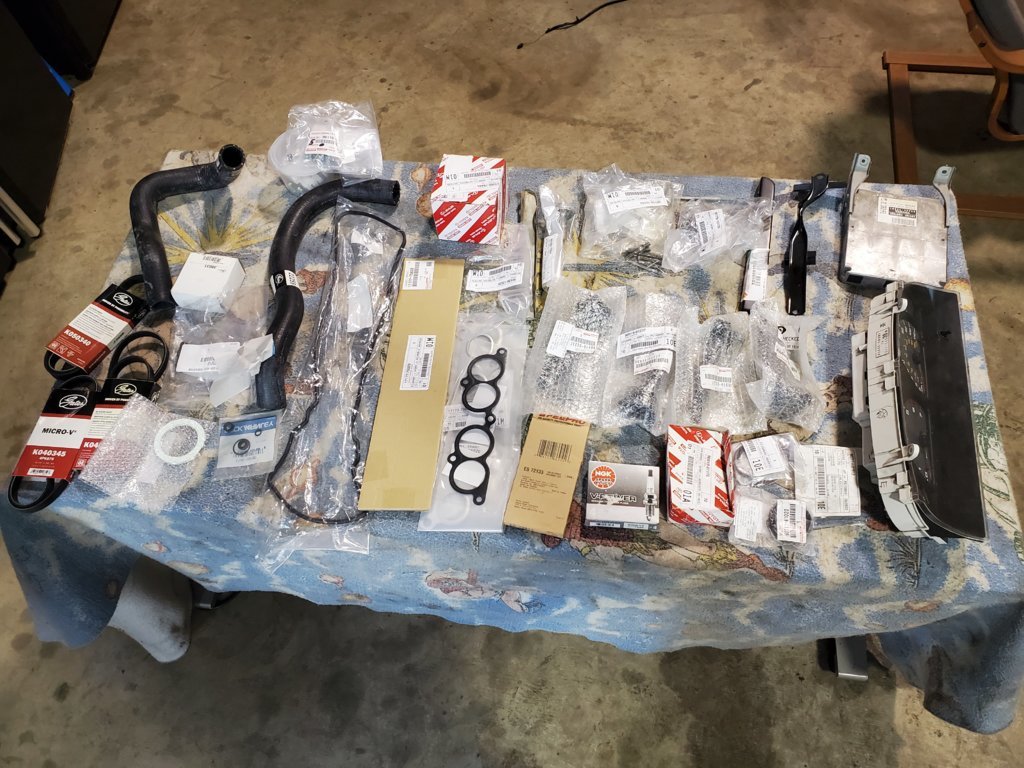

    Lotta other new parts too

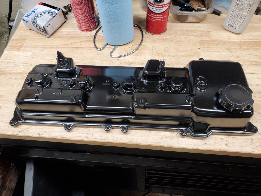

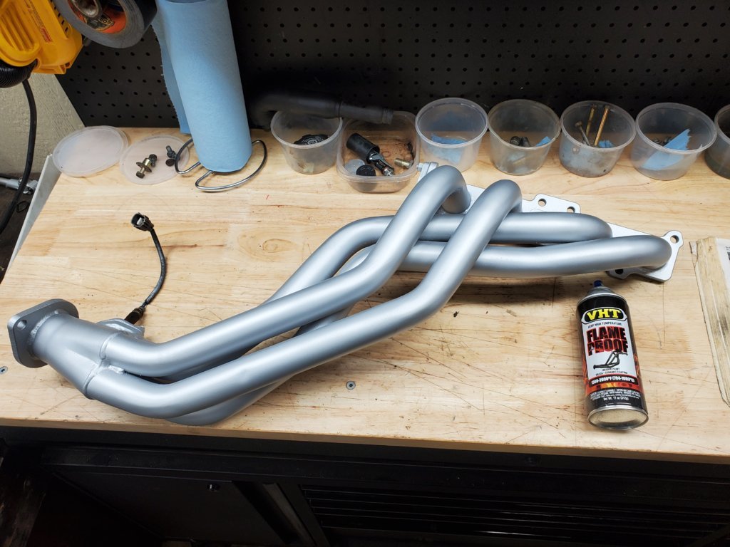

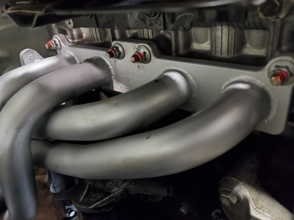

    And some paint work and resto on the accessories including the LCE header

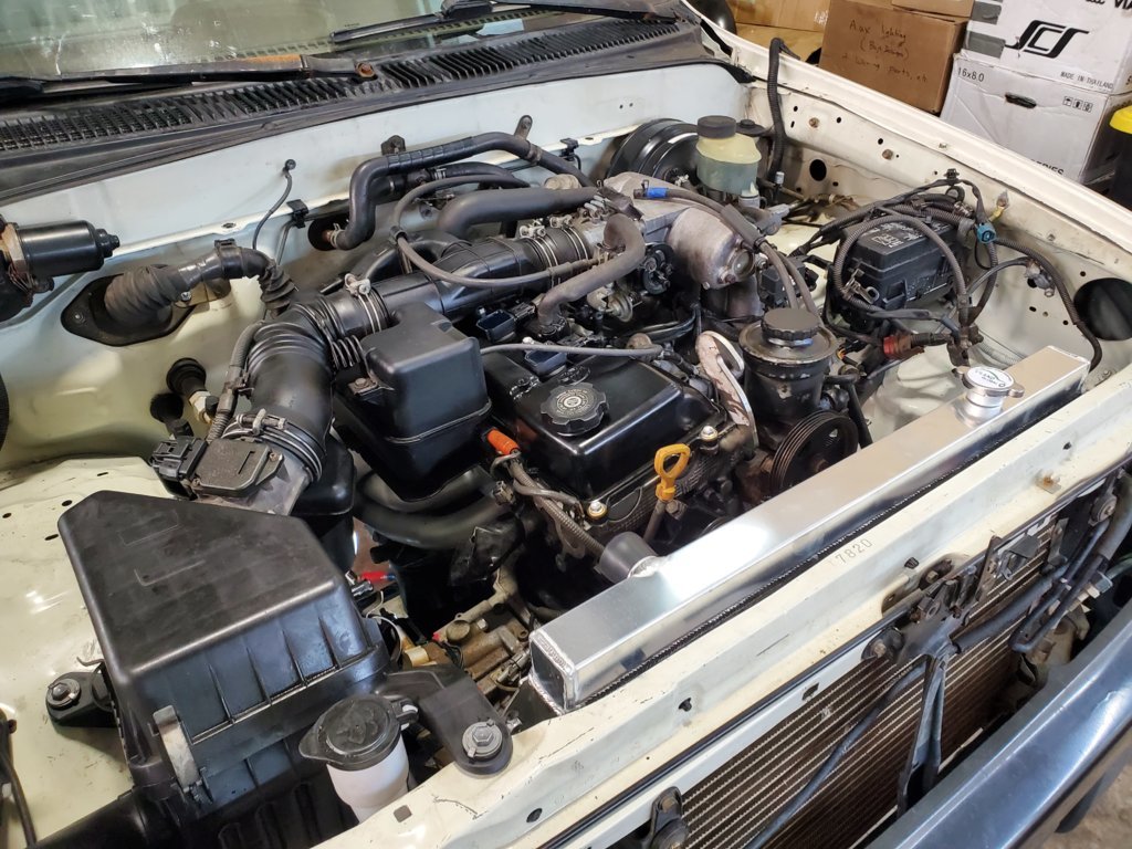

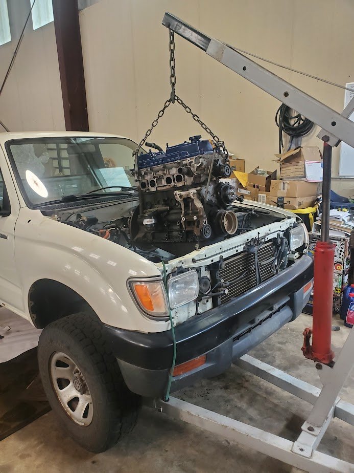

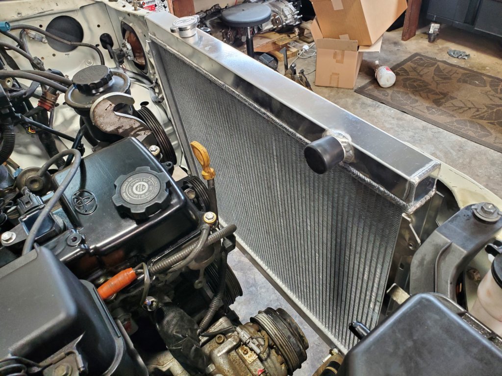

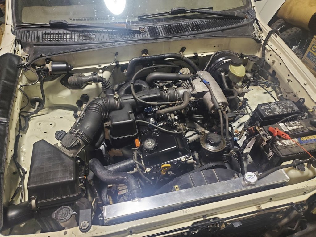

    And, through the magic of the internet, it's in!
    Along with some fancy kit for good measure

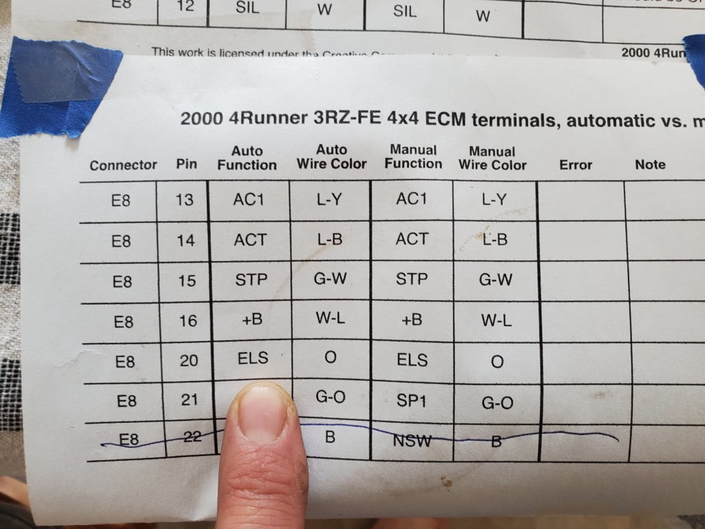

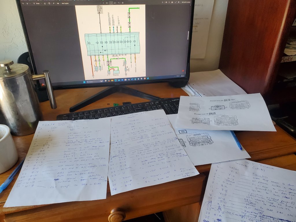

    And now this little truck has had all 3 types of 3RZ's installed (distributor, 8 port, dual coil, 8 port, coil pack, 4 port. Was there a dual coil, 4 port?) Anyway, with the engine bay back together, the easy part was done. Now to figure out this fuct up wiring. Stay tuned!
