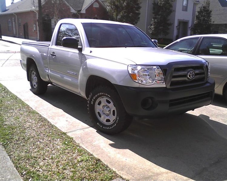

    On my third rear end in 24,000 miles. What could be the problem? Is Toyota going downhill on quality? 2008 reg cab auto 4x2. Toyota says it's covered under warranty and I don't tow or drive aggressively. They say these trucks are known for bad rear ends.

    The most likely two causes are:
    1. Improper gear set-up
    2. improper breakin

    The noise/whine at around 55 mph?
    Same stats as you, 08 Reg Cab 4x2 base.
    I've had it since I got the truck. Toyota magically "couldn't duplicate", whatev's. It's plain as fuckin' day. Sounds like a fuel pump whine when you hit 55. It's hard to hear over the muffler and tires now anyways.
    I've had it in twice for the same issue, same response each time, even took a drive with one of their techs, of course it was raining.
    I as well would like to know what the actual source of the noise is. Maybe a bad ring gear, maybe a bad setup/backlash.

    Three rear ends... I'd say housing but it shouldn't matter on these axles and with three rear ends I'd say you could pretty much eliminate most issues. Might just be you being picky. More info would help.
    As far as you quaker... check your pinion for any play. Sometimes the crush sleeves they use can collapse and you get a bit of play which allows the pinion to move farther onto the ring gear. You get a bit of a whine.
    Could also be low lube, pinion and ring gear not in correct contact(pinion too deep or too shallow), too much or too little pinion/ring gear back lash, or chipped teeth or worn/loose bearings.
    Occasional noise could be loose or broken bearings or the ring gear has too much run out.

    If he has lost 2 my guess is that he never broke them in and burned them up towing or something similar. It takes 1000 miles at least and the first 500 are the most critical. No breakin = no gears

    I have a 2008 reg cab 4x2 auto. I currently have 25,500 miles on it. I am on my third rear differential and i think i need another. Toyota replaced my rear differential twice because of a whining noise. It just started making the noise again. What could be wrong with my truck? I am starting to hate this truck and mabey i should have bought american. The repair was covered under the warranty, but it is very time consuming to go the dealer every three months. Toyota has spent more money in repairing this truck than i paid for it!!!
