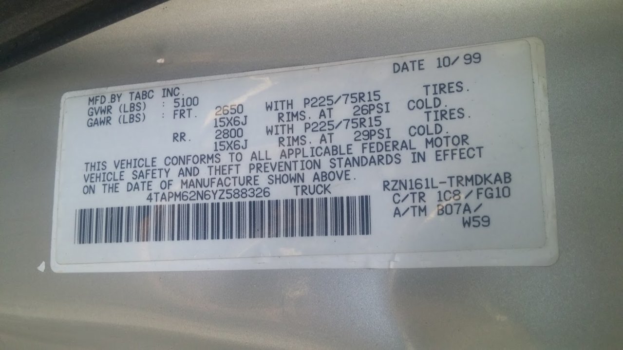

    So I've been doing some research to do the PreRunner 4x4 conversion on my truck (1998 PreRunner Ext. Cab 2.7l AUTO). My VIN sticker on the driver's side door pillar indicates I have a gear ratio of B07A.
    When I looked up this gear code, several threads and charts online point out I have 4.30 gearing. But here's the thing, several sources say the '07' in my gearing code has some exceptions. According to LC Engineering "The '07' code was introduced in 2000 and it's actual ratio has not been confirmed, however, Toyota did reintroduce the 4.30 ratio to the Tacomas in 2000, so I assume the mysterious "07" code indicates 4.30, but this is not confirmed."
    What makes it even more confusing is when looking up a front differential/carrier for my truck in my assumed gear code of 4.30, a front carrier with this gearing does not exist. Front carriers with the 'Front Axle, w/o automatic disconnecting differential; 4 cylinder, AUTO' configuration only exist in the 3.58/4.10/4.56 and nothing else. Even for the other configurations of engine and drivetrain there is no such thing as a front carrier with 4.30 gearing. I got all this information from car-part as well as other various scrappers who use the same parts database system.
    I'm stumped. Yeah yeah yeah I know I can just go outside, mark the driveshaft, and count the revolutions but I wanT to know what your guys' experience is. This seems to only be a problem on PreRunners of '98-'00.

    So, to add more confusion to this, my 99 3RZ TRD pre runner has B04A B07A door code, but it has 4.30 gears. I verified this by jacking up the rear axle and spinning the driver side wheel 10 complete rotations. I put a piece of tape on the driveshaft and counted the revolutions and it spun 21.5 times. You take this number and multiply by 2 (since the passenger wheel is not turning during this) and divide by 10 (number of tire revolutions). This comes out to be exactly 4.30 and there is no possibility that it is any other ratio. I even took a video of it just incase I miscounted.
    I also further verified this by installing a elocker axle with 4.56 gears. I reinstalled my stock speed sensor gear in the transmission and my speed is correct on my speedometer. (I have 255/85 tires and put a different speed gear in to correct the speedometer previously with the stock 4.30s).
    Edit: I suggest you lift the rear axle off the ground (you actually only need to get one wheel up) and rotate the wheel like I did. This will tell you exactly what ratio you have. Your truck needs to be in neutral btw.

    Jeez Toyota. If somehow my truck actually has 4.30 gearing, I'm a little boned. I called up a Toyota scrapper and they told me they have never seen a Tacoma with a front carrier geared at 4.30. They said they did have a 4Runner front carrier with 4.30 gearing I can use. I still have a suspicion I have 4.56.

    So I did what you said. I jacked up the driver's side tire off the ground, put the truck into neutral, and spun the tire 10 times. I did this test 3 times and 2 out of the three tests resulted in 21, with the last one being 22. I counted 21 rotations of the driveshaft. Doing the math 21 x 2 = 42 / 10 = 4.2
    So rounding it up I guess I have the 4.30 gear ratio as the VIN sticker gear code of 4.30 states.

    Yep that sounds right. If you had 4.10s it would be 20.5 rotations, if you had 4.56s it would be 22.5.

    I just tested this again but with the passenger tire. This time I rotated the tire 20 times. I counted exactly 43 rotations. Am I crazy or does that mean 4.30?

    Yes that means 4.30s

    @BartMaster1234 I just realized that I was wrong about my axle code. My truck has the B07A code just like yours, and it had 4.30s stock. I will edit my previous post as well so it is less confusing for people looking at this.

    Interesting. My truck had 4.30 gears after counting the revolutions of the driveshaft/tire.
