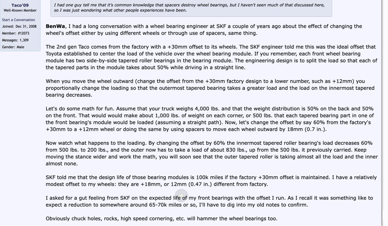

    here's a screenshot of a "long conversation with a wheel bearing engineer" by Taco'09 from the link in the previous post. I still have a question in regards to wether an aftermarket suspension will change the "ideal offset that Toyota established to center the load of the vehicle over the wheel bearing module". My gut tells me no, but I'm not an engineer.
    Lukelem likes this.
