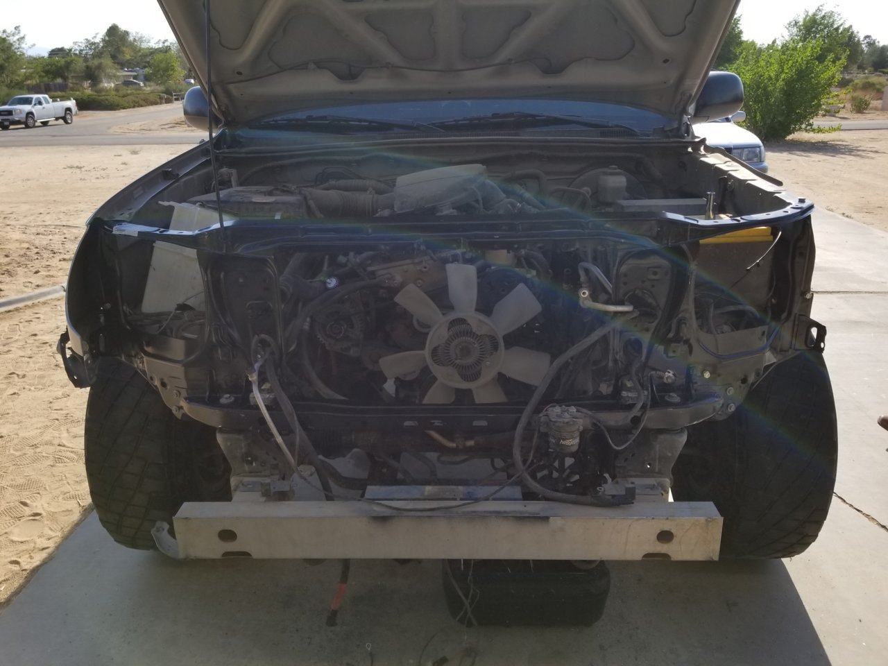

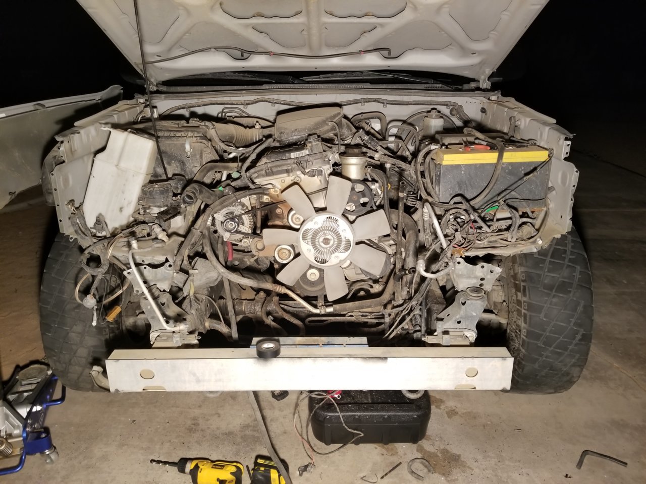

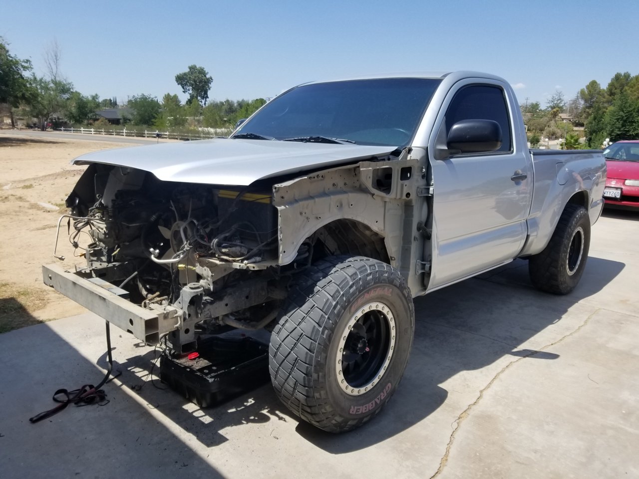

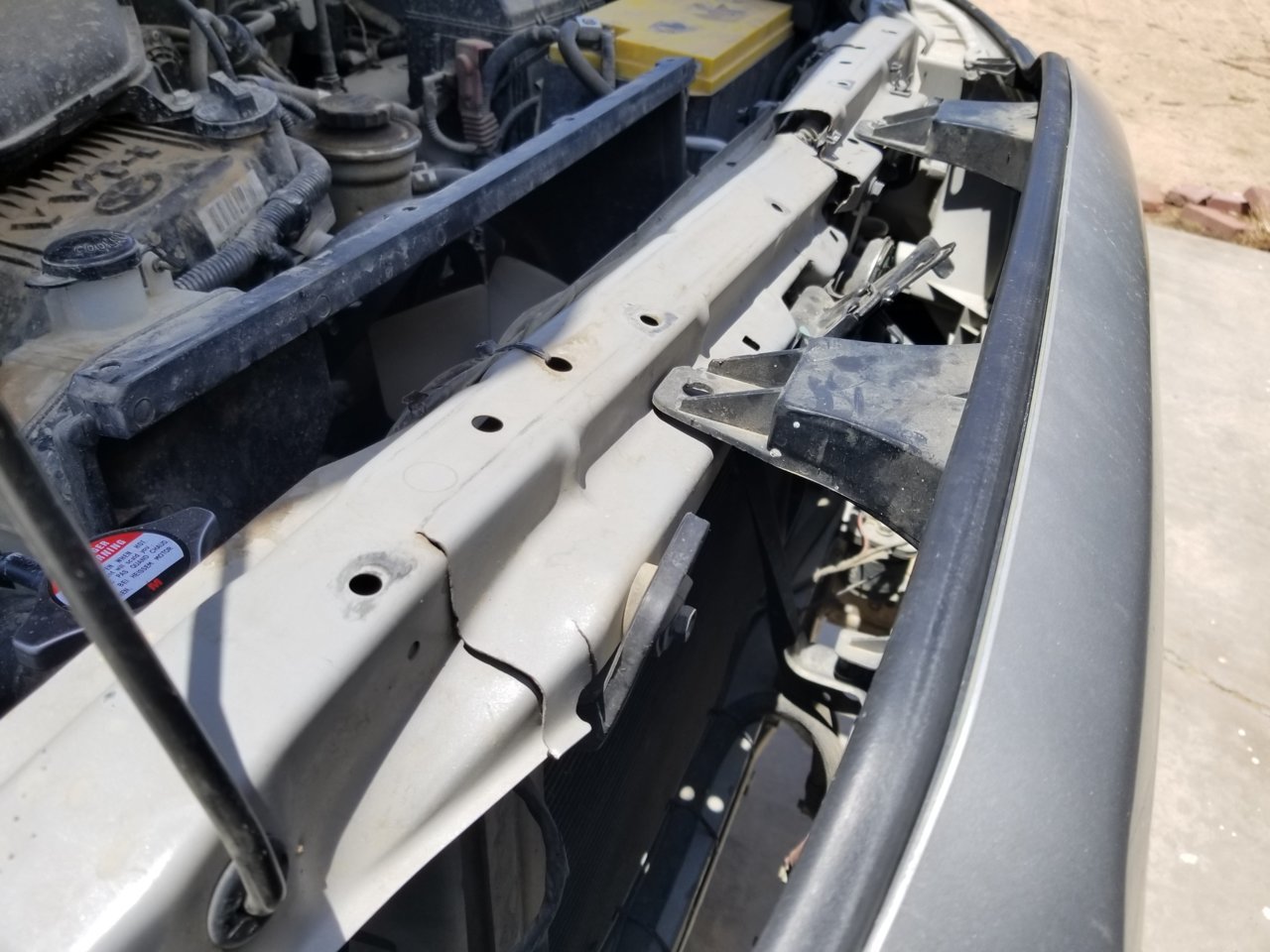

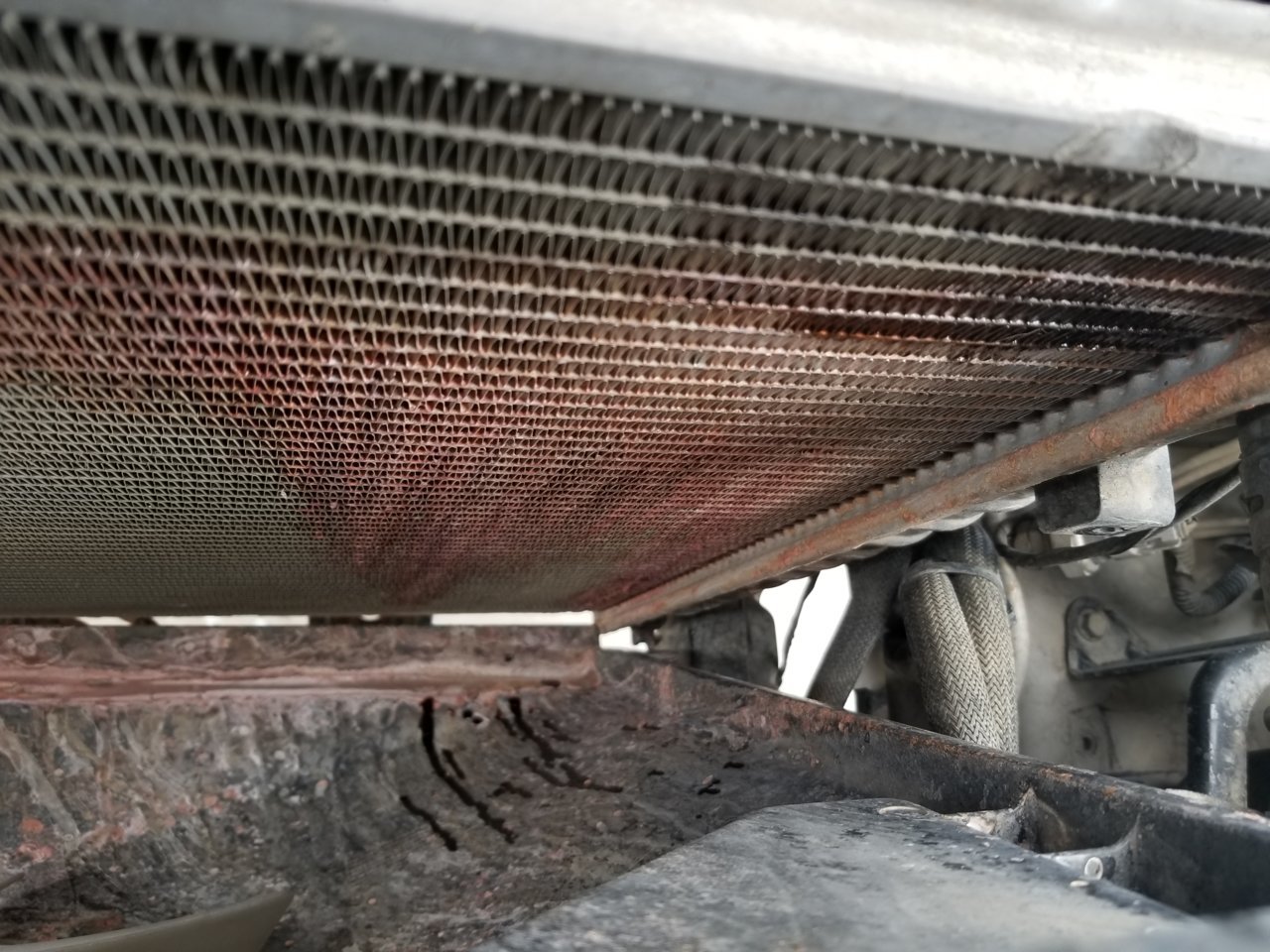

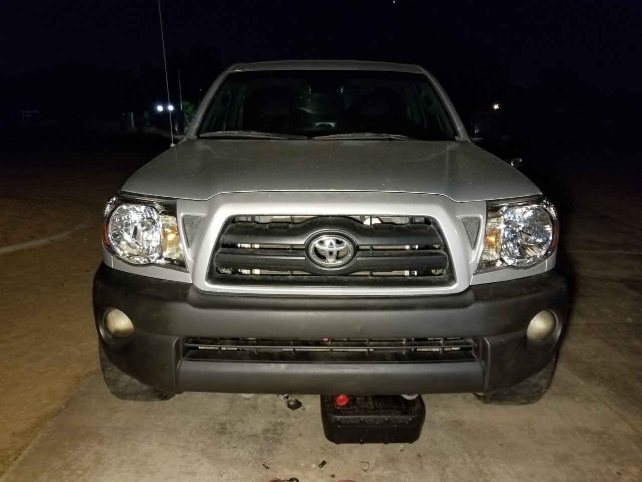

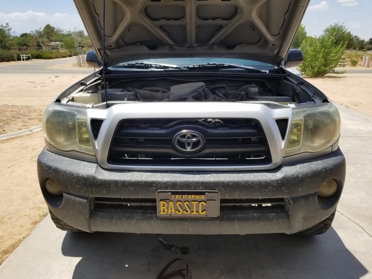

    New radiator, radiator support, thermostat, and headlights. Also re dipped the front bumper. Looking like new again! Still some things to replace like the a/c condenser that's cracked and I didn't realize it until I had the truck back together.

    You replaced the entire core support? How big of a job was that? What replacement support did you use? I may have to do this coming up here soon.
  5. Aug 24, 2018 at 10:42 AM
    #205
    killianeric
    killianeric [OP] Well-Known Member
    Nov 29, 2012
    #92121
    607
    High Desert
    2007 Bass Model Tacoma
    It was a huge project in my case since I have a lot of extra wires and other stereo equipment related things to to disconnect, move, etc.. Also I was replacing the the radiator and some other things at the same time.
    Removing the grille, bumper, headlights, fenders, radiator, and the a/c condenser was the easy part(took 1.5 hours). It took about 4 hours to drill out each individual spot weld with 2 people and 2 drills, almost 50 if I remember correctly. Since I couldn't weld it back in, it was bolted in where ever I could get it. It's not very pretty on the back side of things but I didn't have a whole lot of options.
    Link for the support below, about $100 shipped to my door. For the headlights, support, radiator, a/c condenser, new supporting bracket for the hood, was about $500 and 20+ hours of work and beer drinking. I'm also a semi broke married 21 year old so I couldn't get a the nice replacement parts I really wanted but no issues so far!
    https://www.carparts.com/details/To...Support/2007/Base/4_Cyl_2-dot-7L/T250120.html
    I think your biggest problem will your a/c system since it's not completely cracked or out of refrigerant like mine was.
