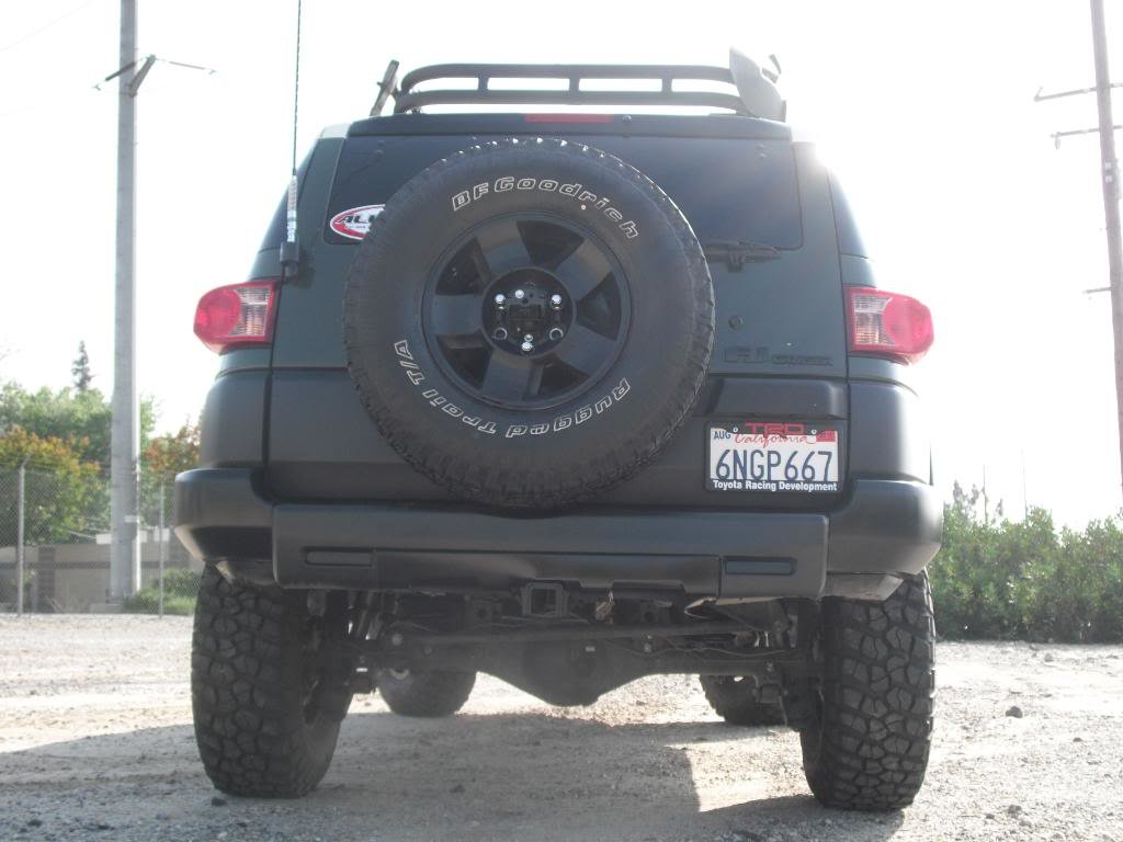

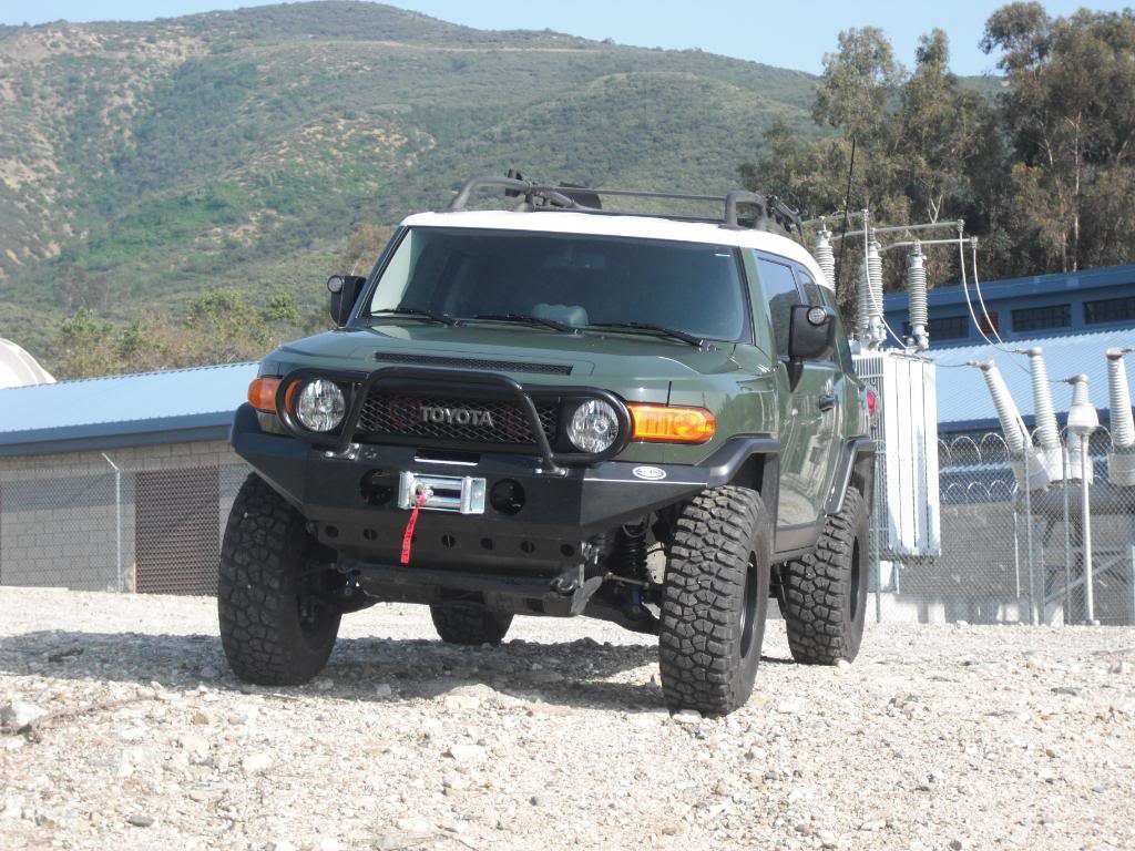

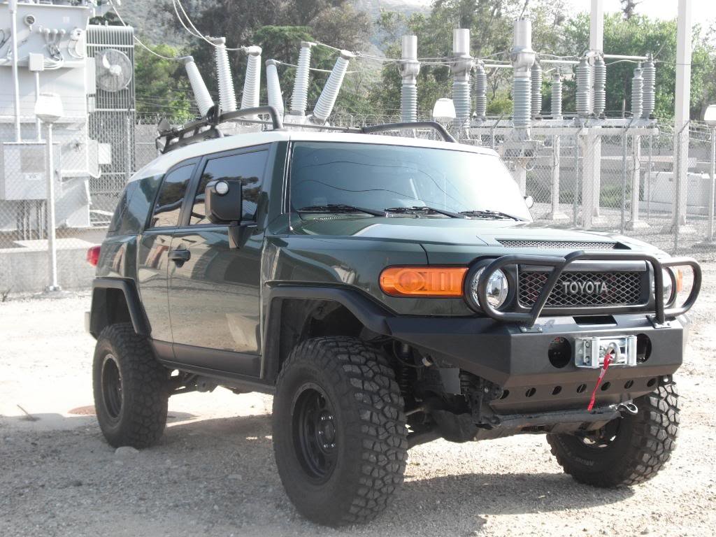

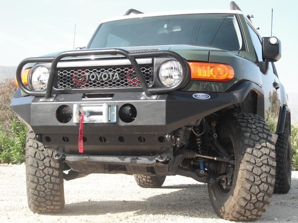

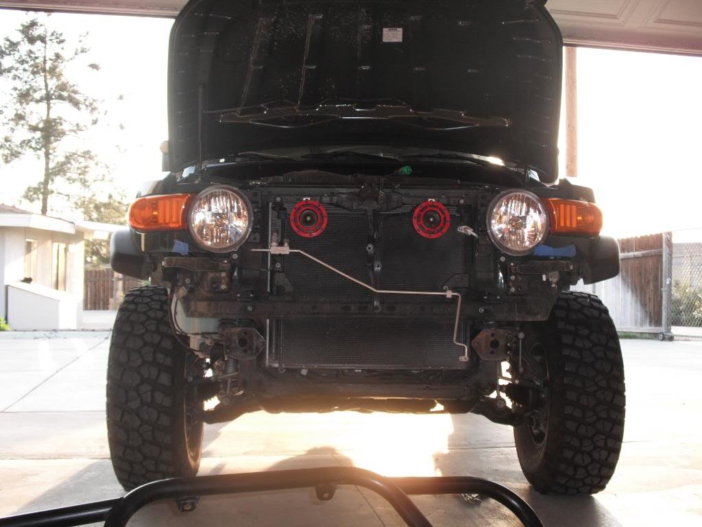

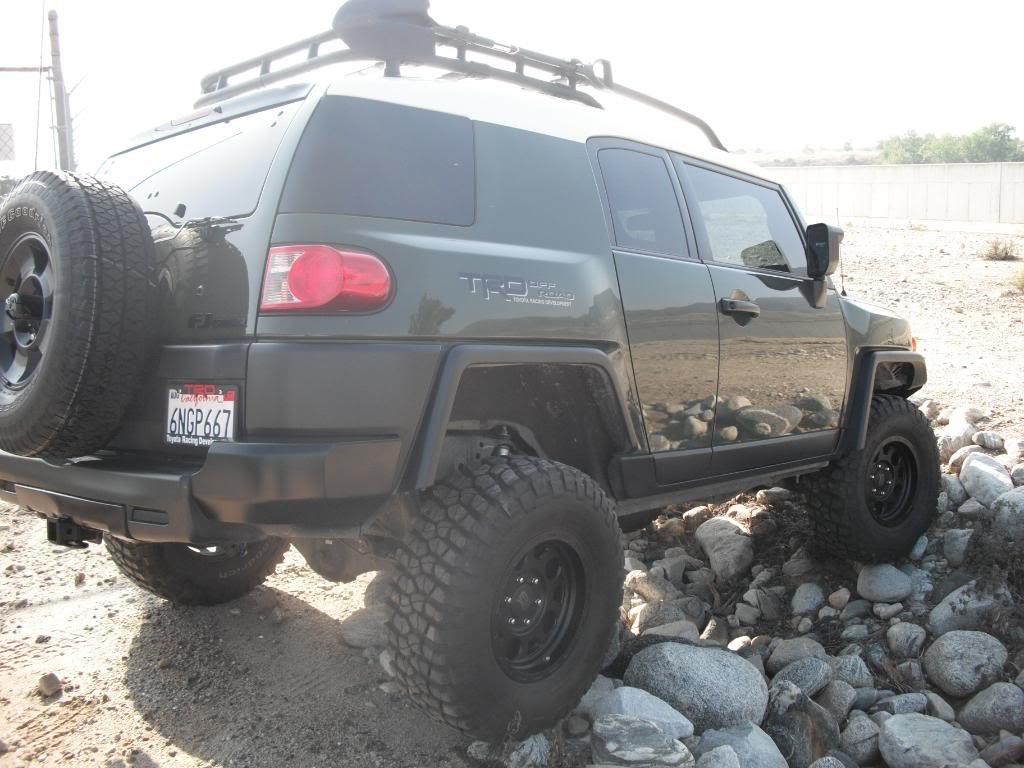

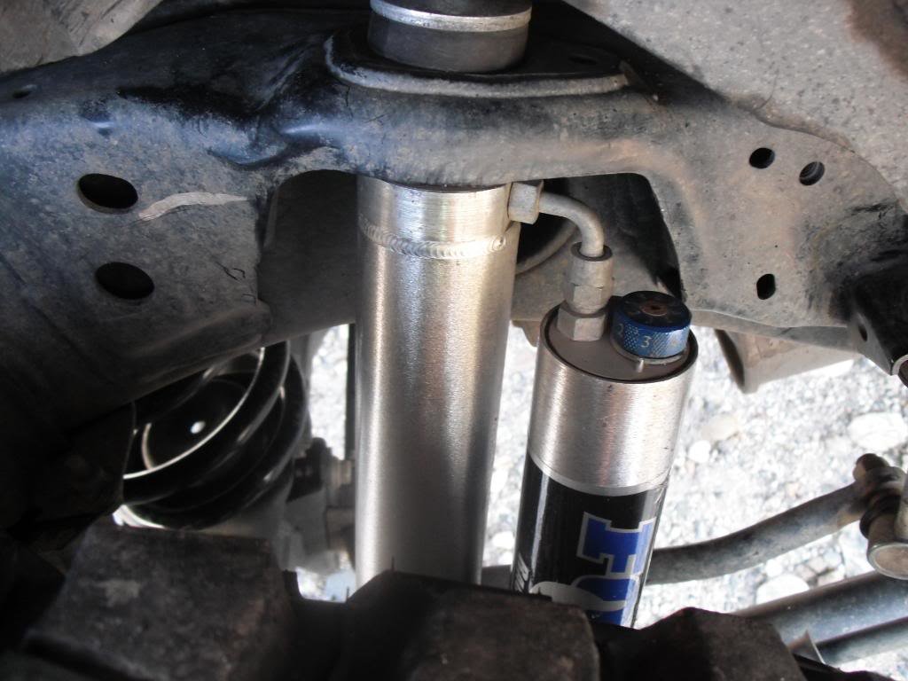

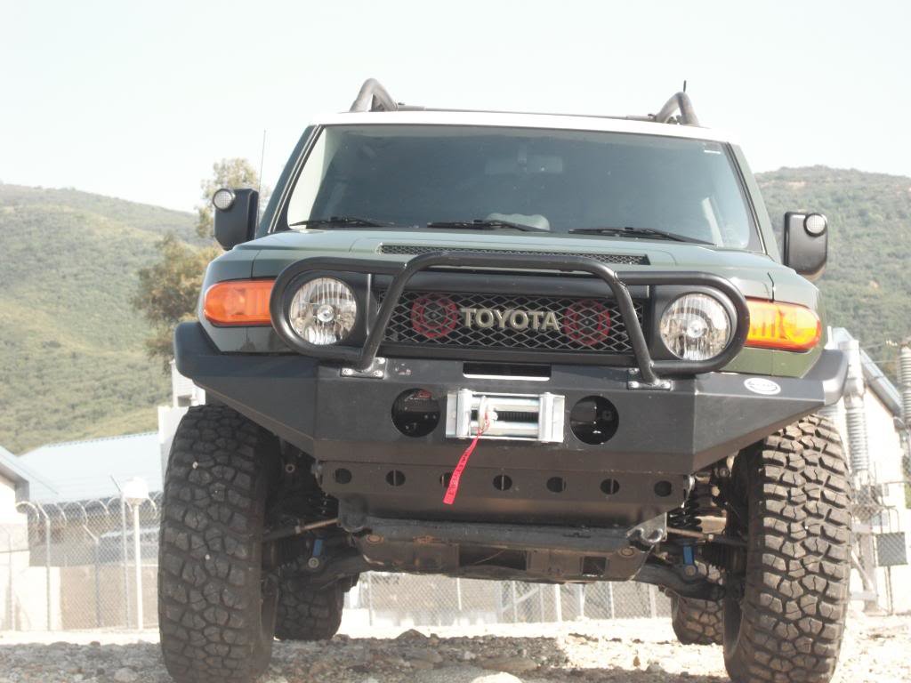

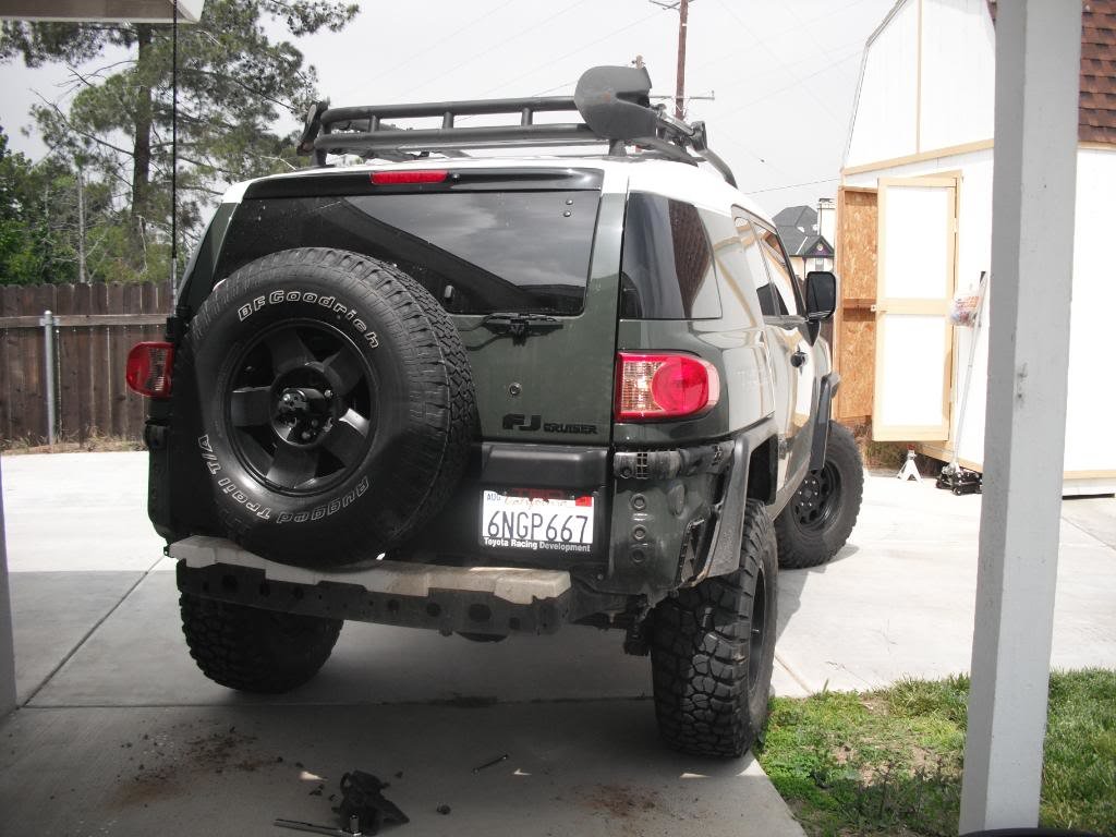

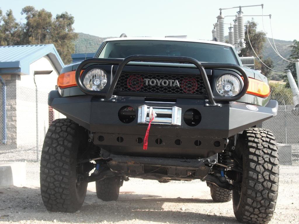

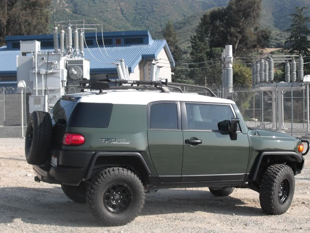

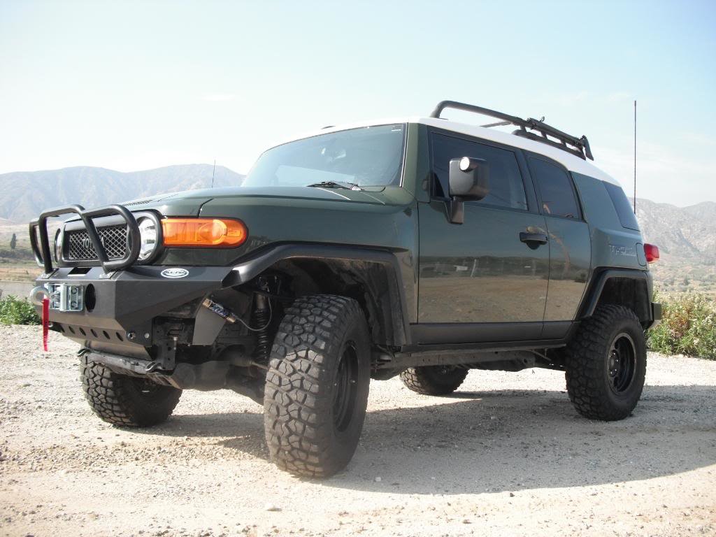

    slight update/more useless pics :laugh
    mid-bumper install. waiting for JD :thumbsup:
    installing the factory hitch :cool:

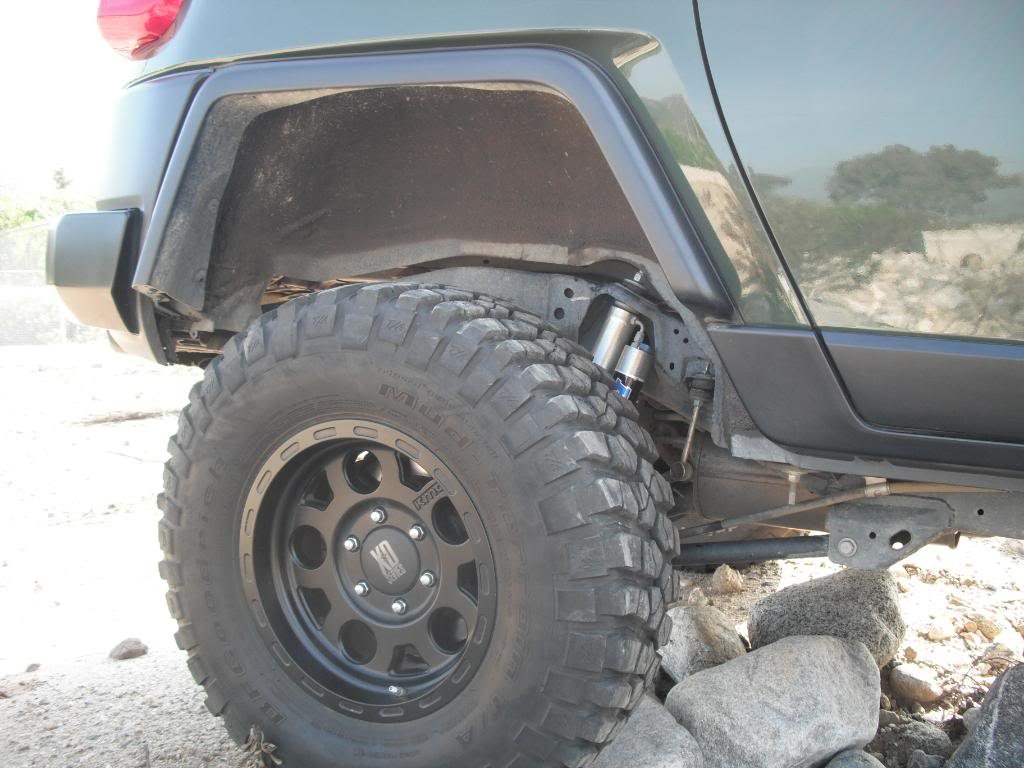

    Fox 2.0's and removed the factory sway bar
    DSCF0135_d91db746b75ac17055b66f44eb0bcb12ee27ce74.jpgDSCF0133_f03955d133a9ea19d296099acbd217f6a2ae3c95.jpg
    Fox rear shocks w/resi's to top off the Allpro 2" lift springs
    randoms
    beat to shit factory skid plate :laugh:
  7. May 22, 2011 at 10:33 PM
    #307
    krimson
    krimson Nothin
    May 17, 2008
    #6714
    3,399
    TRD Off Road
    OME 3" lift with 885 coils. OME Shocks with TSB 1.5 AAL. 285/75/16 KM2s. XD Hoss 16" wheels. DDM Tuning 6000K HIDs, H10 6000K Fogs. BHLM. Debaged. 20% tint on front windows.
    Nice jon :D :D :D
  8. May 22, 2011 at 10:35 PM
    #308
    jonny
    jonny [OP] Betty White Edition Heep ZJ
    Jun 21, 2007
    #1887
    8,349
    John
    thanks Jacques!
    your truck looks really good!
    just noticed your sig.

    So you leaving the swaybar off?

    yea. with the nre AP rear coils and the dampners set at 4 or higher, doesnt sway anymore than stock .

    Do not leave your rear sway off without limit straps. you will break your fox's very quickly. the only limiting factor for droop without the sway bar is your shocks. this puts tremendous strain on them. Mainly on the stem, which is the weak point here and it will break off. I highly suggest you reinstall it immediately until you can get limit straps installed.
  16. May 23, 2011 at 8:00 AM
    #316
    jonny
    Jun 21, 2007
    #1887
    8,349
    John
    Rear sway bar never left the FJ. Was talking about the front sway bar. the handling stiffened up a bit after installing the AP springs and adjusting the dampners F+R.
    but thanks for the info :thumbsup:
